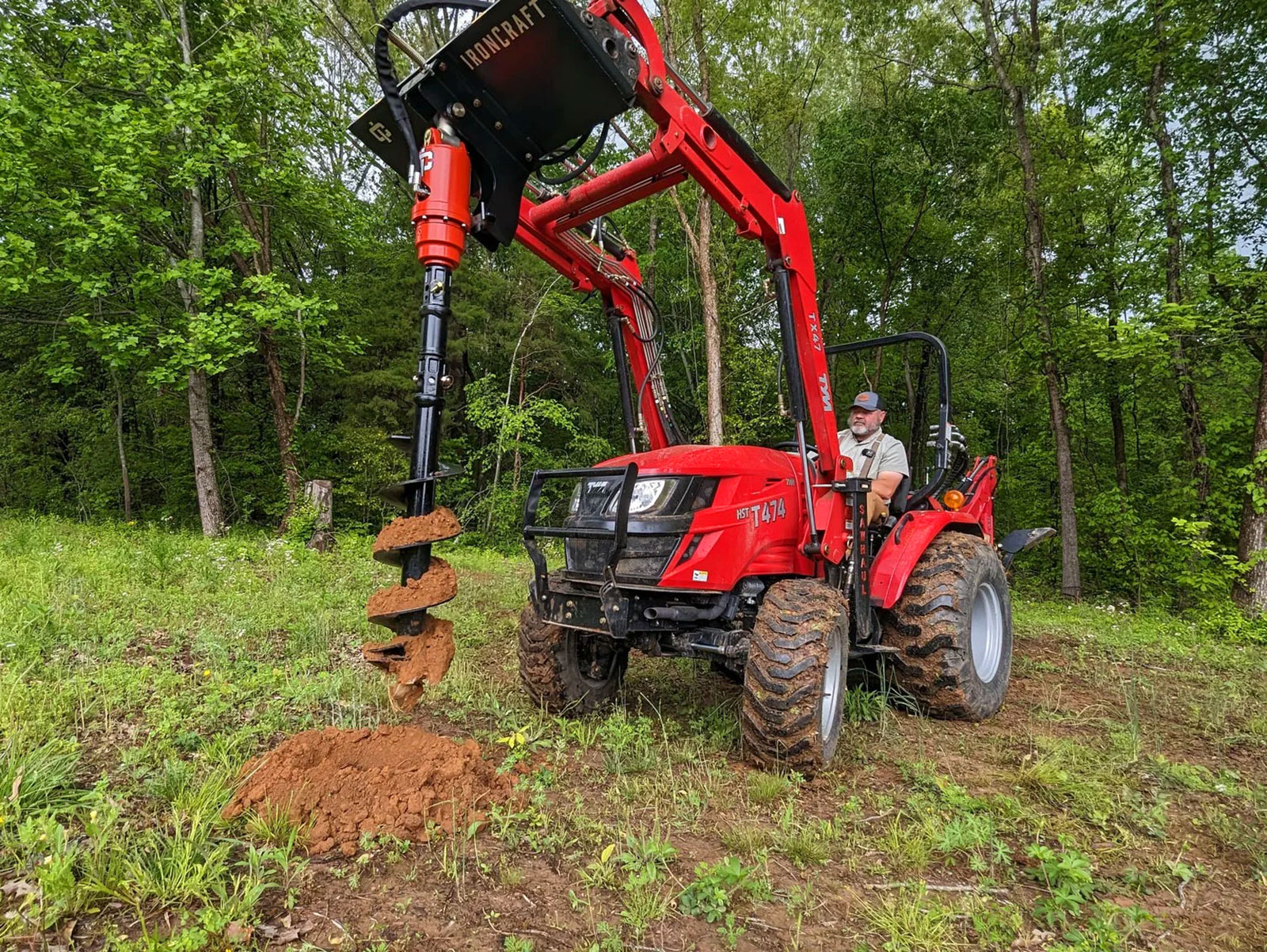

Can my Kubota L6060 with a third function remote handle a loader mounted 18-24”auger? I’ve got a lot of trees to plant in the coming year and thought it would be a nice way to dig the holes.
   / Loader mounted auger #2
Yes. Ideally, you should find one that is designed for the flow rate of your tractor. It'll still work with augers designed for faster flow rates, it'll just turn slower.
   / Loader mounted auger #3
Owning a GL,I don't believe you will have enough flow to run off the third function.I run a snow plow and grapple off mine.
   / Loader mounted auger #4
Lower flow still works with an auger. It just turns slower. My auger is rated for 7-17 GPM. My machine is rated at 11 GPM. His L6060 is 9.4 GPM.
