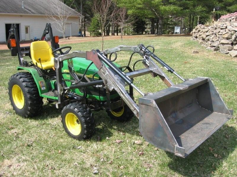

Unless your some type of magician or have a huge spare parts bin I don't think you will get much of a loader built for 300 dollars. I have $840. in mine and didn't hire out any machine shop work. Cylinders, hoses, fittings, controls, steel all add up quickly. No sense in cutting corners if you want it to be functional. They last a lifetime unless a new model catches your eye. Good luck with your venture.
Great job!!!
That looks like a strong built bucket....very nice:D
That's a real nice loader you built looks factory
