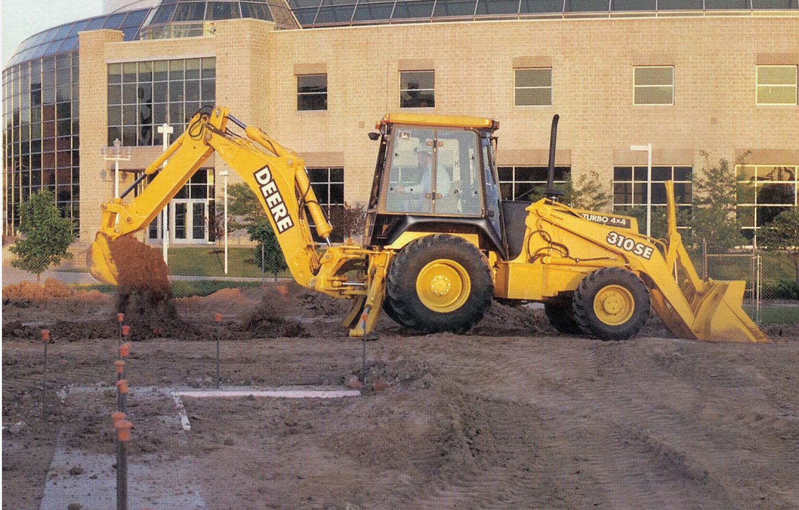

Those Masseys are great old tractors...and with that much land I'm sure you will find a lot of use for it. It will basically pull anythin. Keep that Massey forever. No substitute for one of the old good ones..., but Ag tractors are not the best with loaders for shaping land. The weight distribution is not as good as you expect it to be. Not wrong, just not right....
It sounds like you know mechanical things and welding and know basically what you want to do.
Let me help from the tractor side. First of all, some thoughts on your Finding a big tractor loader that isn't in use and will stand up to that Massey big power. It is always possible, but big ones are rare and even used ones tend to be expensive. They tend to go with the tractor. Much easier to find a loader for a small tractor.
But there is no reason why not to look, but consider thata getting it mounted would be a big job with big fittings. A whole different league and tooling from ATV, bikes, and truck work. You almost need a working loader to be able to work on one. I'm not trying to discourage, but there are better ways.
So no reason not to keep your eyes open for a loader - most can be modified to fit but what a huge job it would be.
What I think you should also be looking for at the same time is a older used backhoe/loader. These are the yellow machines you see on every construction site. They are the swiss army knife of land shaping work, and old ones do not hold their value well. Options that raise the price are cabs, AC, MFWD, extra hydraulic outlets, power shift, and extendahoes. Prices for used ones are low like I said, and for those with fewer options even less. There just isn't much market for used construction equipment. Parts are available and reasonable, and the older models were built to be rebuilt forever. Stay pre-2005 so that you are not into modern computer electronics. You want the older fully mechanical ones.
Models to consider best would be the Case 580, followed closely by the Deere 310. Both of those were made for many decades so there are a ton of them out there. Try utility companies & school districts.

We have been looking for just that, meaning backhoe/loader. I have looked at several used units, coincidentally 2005's they start at $65,000 up to $90,000 and not very good condition. Used construction equipment has remained very expensive here, by here I mean western Canada. Lots of new people in the county and they seem to come here able to buy everything.
But your advice on what to look is very helpfull, and I will cut and paste that into my notes.
Thanks Dman1981, appreciate that information.
