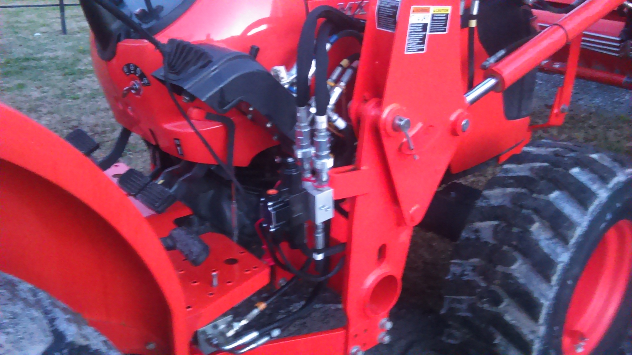

If I could just get this float to operate correctly. I would be set
I think I'll like the 3rd function. He had a Kubota dealer install it

The float position on the valve is really pretty simple. Don't let it overwhelm you. There are usually 3 or 4 springs (about the size in a ink pen) that hold the steel balls in place and are pushed by the valve spool when you move the lever.
There is probably some moisture in the end cup and some dirt or corrosion is causing the trouble. Just needs to be cleaned up and put a touch of white lithium grease on them.
hydraulic spool repair kit - Google Search
If this link works, look at item #8 (springs) and #11 (balls) as an example of what they are and where they are located.

Thanks, If it doesn't free up ans begin to work correctly, I may take it apart and look for a problem
I could kick myself in the AZZ for not checking this.
I did check out the other loader functions, just not the float

On my L3130 the float got jammed up, took off the end cap and everything was rusted. Cleaned up oiled and drilled a hole at the bottom of the cap to let the water drain out and no more problems. Drill the hole big enough and you can stick a WD40 straw up there and give it shot every once in a while.

So you were able to clean it all up just by taking this end cap off ?
Nothing flew out everywhere when you took it off ?

Ditto on mine jamming up due to water/corrosion inside the detent assembly. Heed the tip to enclose the whole assembly in a plastic bag when you unscrew it.

Update::::: I got it fixed today ! It was an easy fix too !
I took off the plastic that covers the top of the valve, and found a small steel part that has a hole in it that should line up with the lock out lever, had somehow got turned on it's side. I was able to just turn it back up straight. Now the hole is lined up with the lock out lever, and the float function also works !
