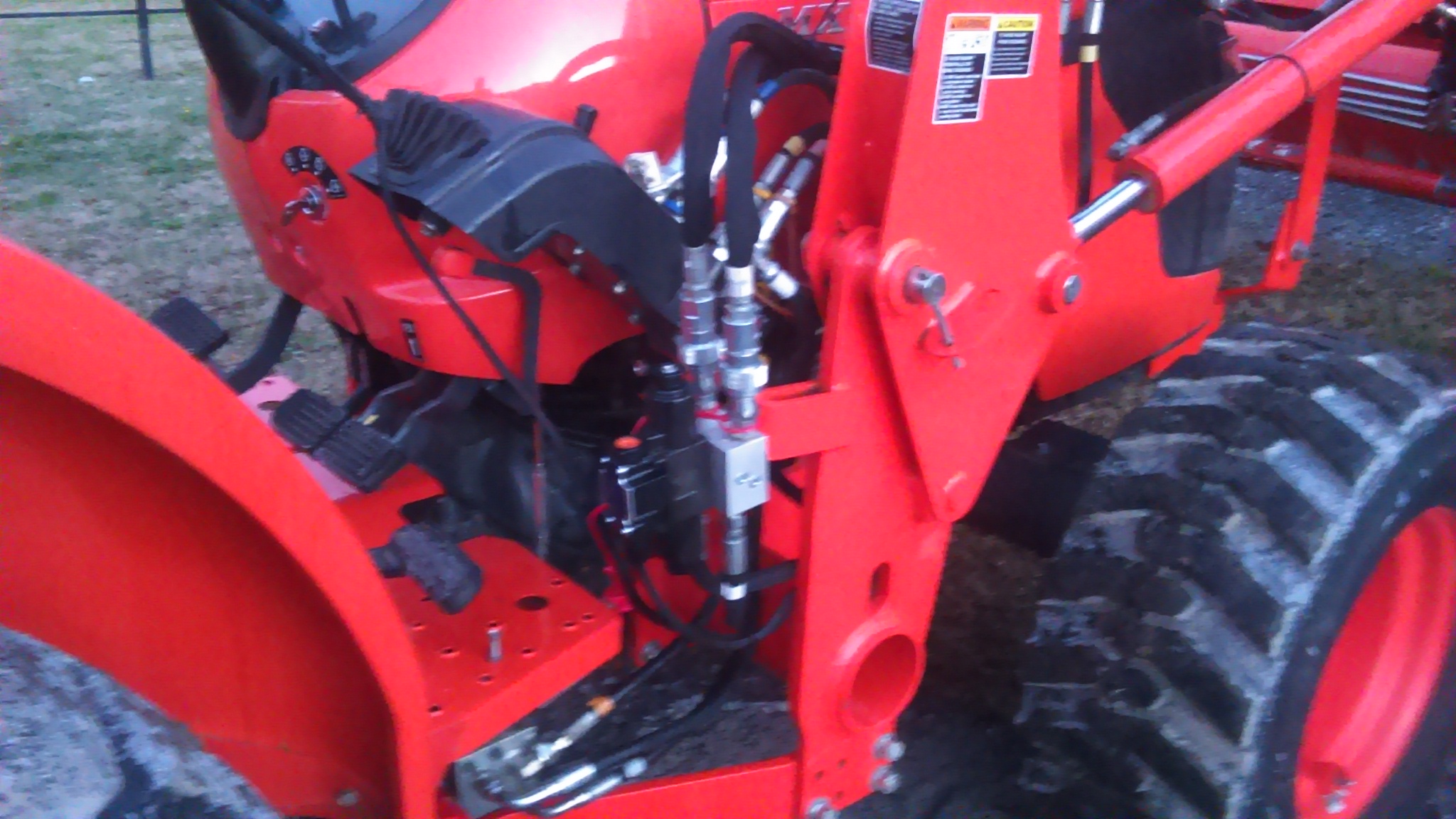

Appears the dealer added 3 function did a neat job.
Anyone got an after market # for the HST filter ? I was able to locate the Hydraulic filter buy not the HST filter

Looks good, I just use kubota filters the hyd has a magnet on it
