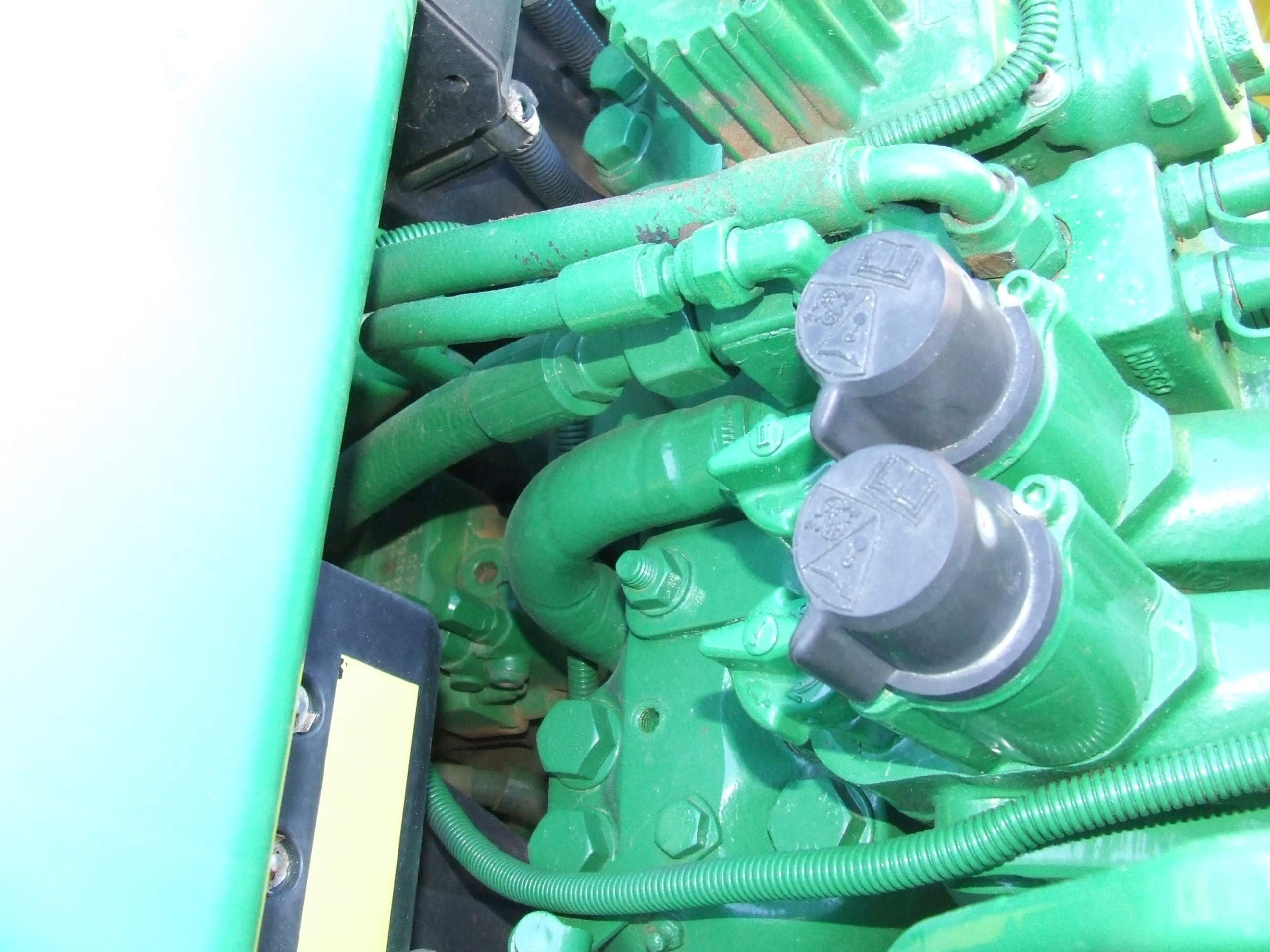

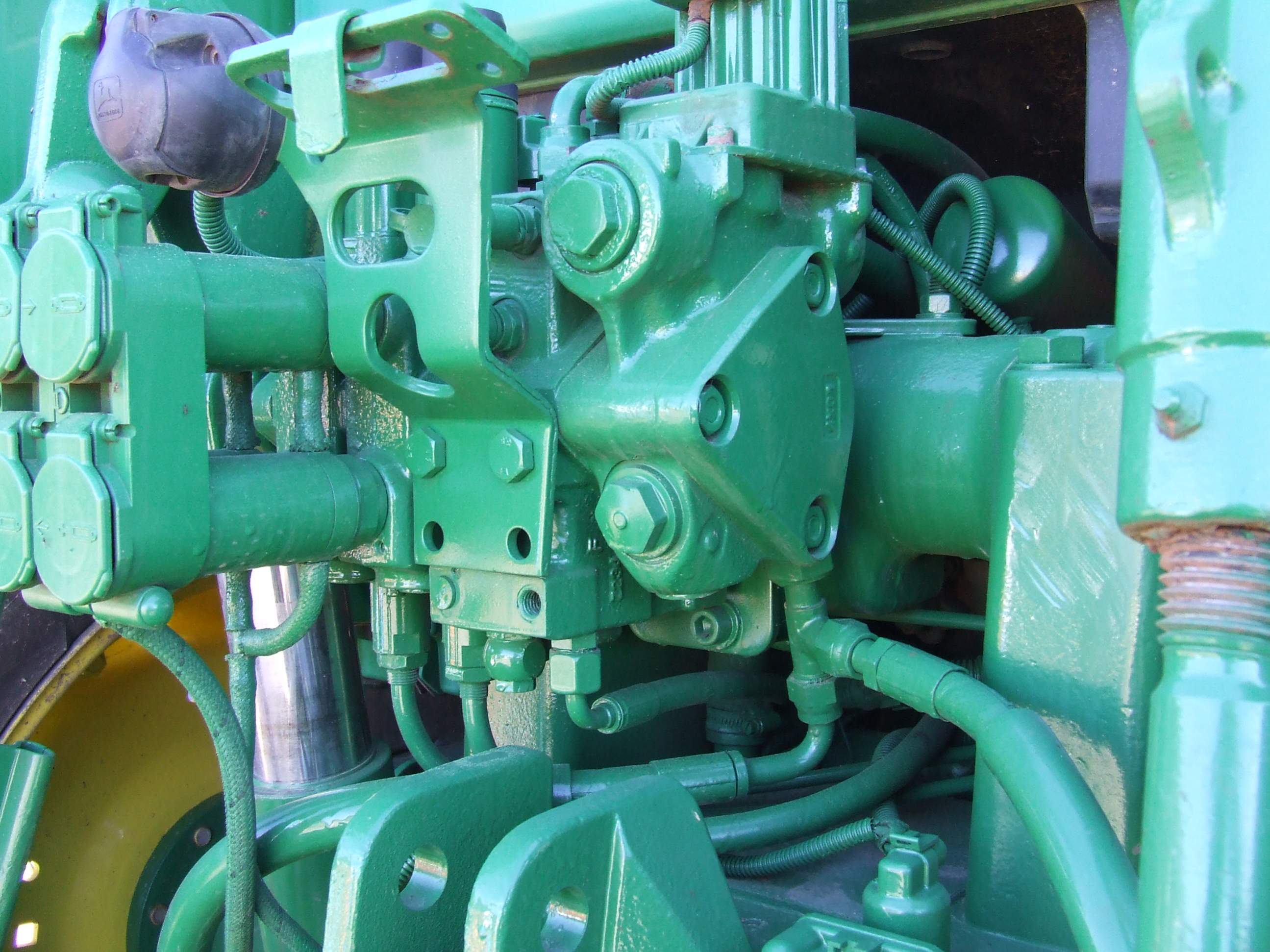

I am buying a Quickie loader to fit to a 6120 purchased recently.
Want to keep the remotes available, so need to know where to connect the hydraulics at back of tractor.
Have read threads about power beyond port & know I need to find out the configuration of my tractors hydraulics first.

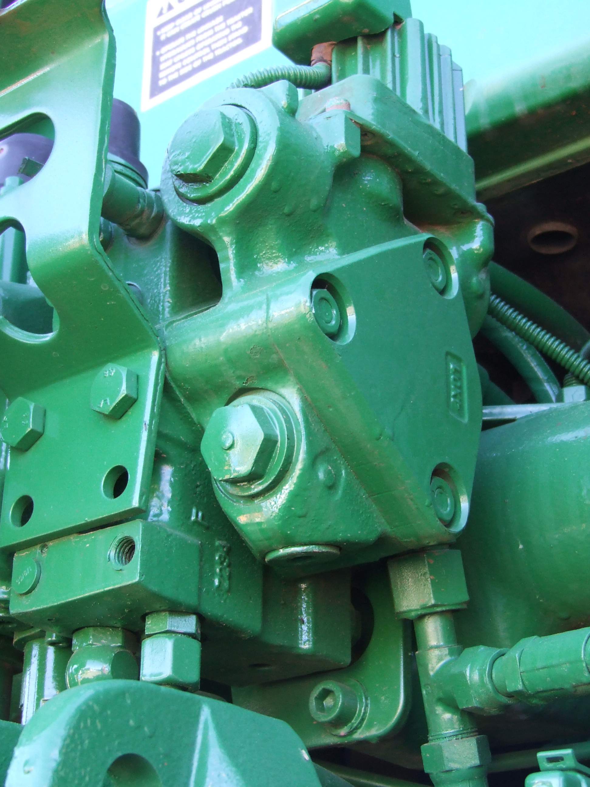

The 3rd attached photo shows where I guess these connections should be.
Shows 2 of 3/4inch plugs, has a plug underneath also. Note the block with these plugs has a hose outlet teed to the 3PL rams
Any info on this would be appreciated
DAVID

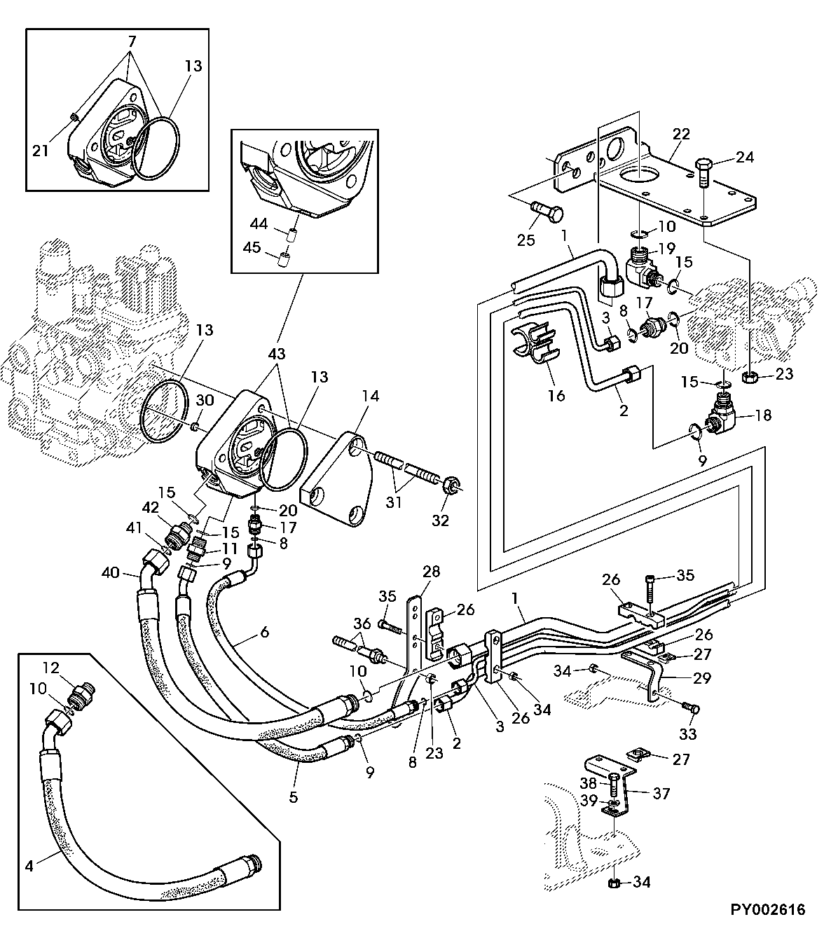

You need a different right side end cover that replaces the current cover which is held on with three nuts. You will also need new longer studs. The cover will have four hose connections. Key #20, top is pressure to loader valve, bottom is return from loader valve. Key #11 bottom is LS (load sense) from loader valve and upper forward is LS to hydraulic pump.
Your loader valve must be LS compatible.

Picture is all John Deere parts.
Dealer might have only been thinking what goes to the loader valve, supply, return and load sense.

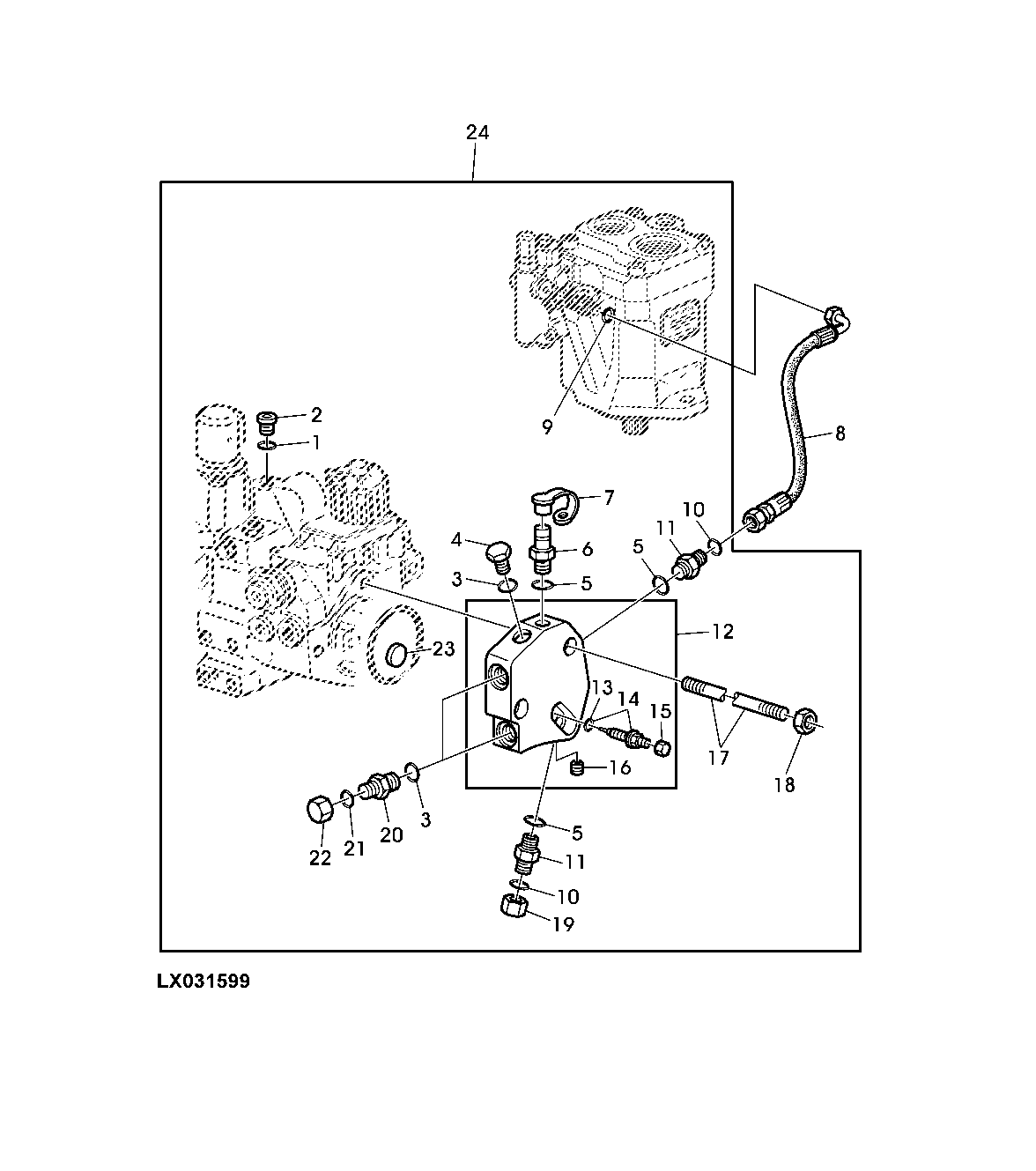

Key #12 is part number AL117097 list is $290.24
Key #24 is part number AL158831 list is $314.60 Gives all parts shown in box 24 of drawing.

AL163533 is key #1 in your drawing, it appears to be included in Ar113482, key #32 in the drawing. Hard to believe you can buy everything for less when you buy the complete FI kit.
/ Loader fitting to John Deere 6120 #8
I think the cover isn't included in the PBY BUT one would have to contact dealer to determine but according to JDparts.com kit weighs nearly 12#s..
/ Loader fitting to John Deere 6120 #9
Service department should be able to print out install instructions. That should have a parts list.
