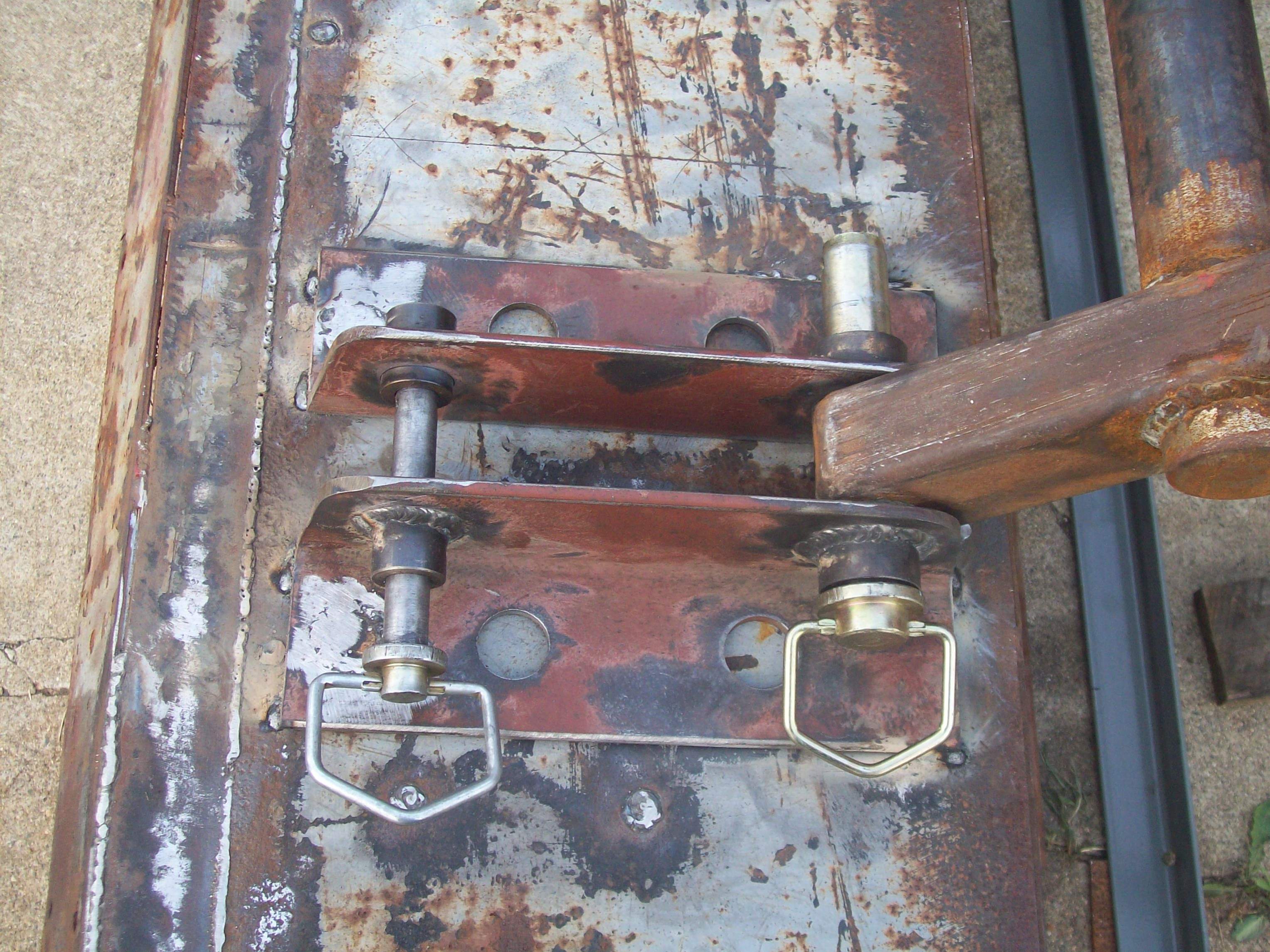

Remarkable work!:thumbsup: One thought on the bucket if you still have concerns. Maybe get a bolt on cutting edge. That will greatly stiffen the bottom which is your longest unsupported span.

Great job. Like the pins you chose. They should be real easy to change when the time comes. What did you use for bushings?
I used standard DOM tubing for the bushings. Trued them up in the lathe (Not absolutely neccasary, but it makes for a nicer job, and I get to use the lathe!) The pins fit very well in the bushings, with just a slight clearance for grease.
The bolt on cutting edge is a great idea. Now you've got me thinking of cannibalizing my seldom-used rear grader blade for the hardened cutting edge...
Thanks for all the replies
Dan
Before you go "cannibal", try your local highways maintenance division and see if they will give you a used one. I've gotten them from our local municipality for free. Sometimes they will only wear down one side of a two sided blade and leave the other side virtually unused. It's worth a shot!:D
