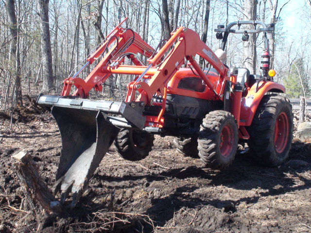

My former neighbor told me a long time ago to remember that I had a farm loader and if you try to use like an industrial loader, something is going break. Making the whole bucket out of abrasion resistant plate seems a little excessive for a 50 HP tractor.
/ Loader Bucket Build #22
Yeap. This bucket is too heavy for my uses and would reduce my load capacity too much. I have a rock grapple bucket for my rock digging.
However, I can certainly appreciate the skill involved in building this bucket. Nice job :)
I agree that it is "overdesigned". The only disadvantage, however, of building out of Hardox 450 is cost. The weight is the same as it would be if I used mild steel. For that matter, a mild steel bucket would probably require additional reinforcement on the front edges etc, making it heavier than what I built.
I understand living within the machines capabilities - I've seen fishplated loader arms and would like to avoid that. However, my tractor will bend the 1/2" x 4" cutting edge on the OEM bucket to 3" off of straight without much effort when prying on a decent size rock - that bucket would end up destroyed if I kept using it.

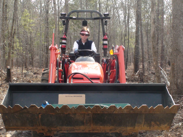

Same here. The conditions you would need a REALLY strong bucket for seem to be the exact conditions you would want a bucket that was SMALLER, not larger, than the factory bucket too. I have a 72" for the skid loader and tractor, which is the stock bucket size... for digging hard stuff I swap out for a 66" bucket. I wouldn't want to go wider at the same time as heavier duty.
Also not sure why you'd need/want to spend for hardox, my factory Kubota bucket with 4200 hours on it had a few welds but the wear stuff was still in-tact, you'd have to put a LOT of really hard work to wear out a stock well-built bucket with wear strips.
I tore the edges on my old John Deere bucket pretty drastically removing a section of asphalt. And I've already bent, on several occasions, (though it's mostly popped back) the stock bucket on my mahindra. I try not to abuse, but I won't say I'm easy on my equipment.
And for an extra $400-$500 tops for the nice material, it's worth it IMO.

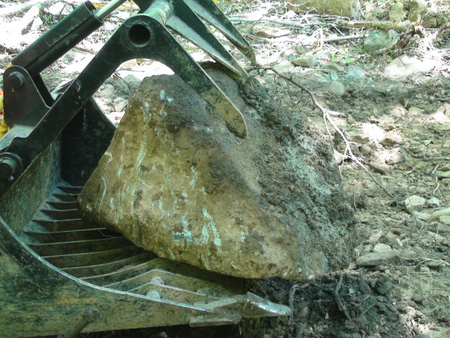

Here is what I dig rocks and stumps with. 48" wide and 550 pounds. Great multipurpose tool that is extremely strong. I have dug out and carried many rocks this size and larger stumps.
This is a better digger due to it narrow front, but is more difficult to carry with without a grapple.

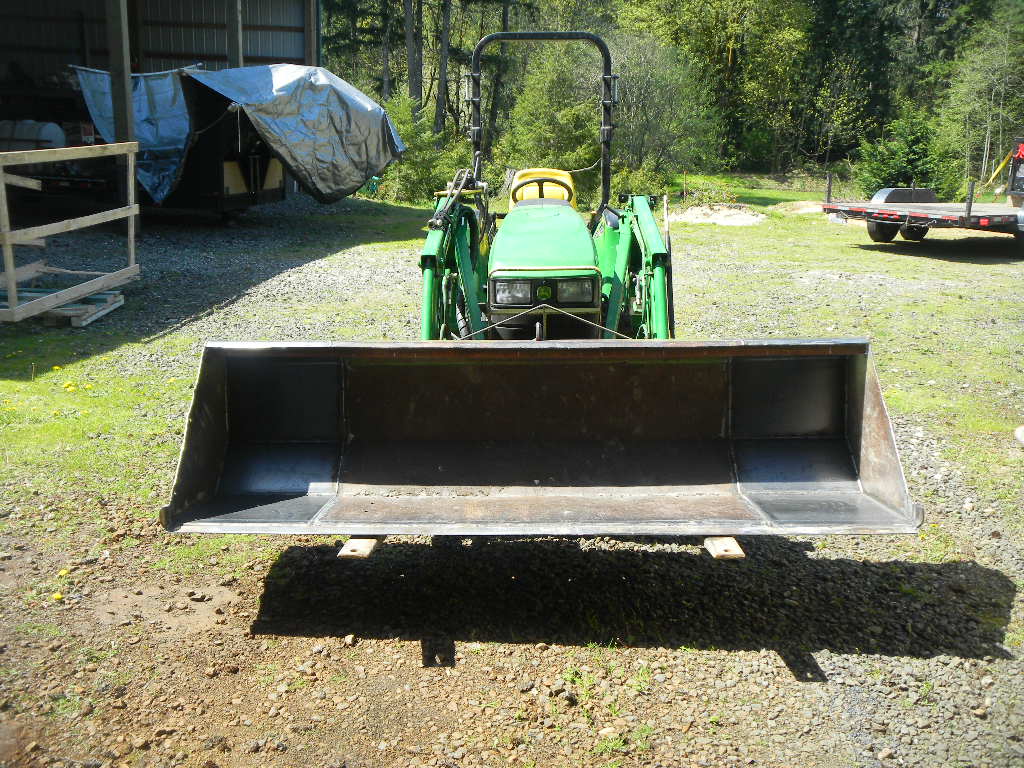

Few years ago I lengthened a bucket for a friend. I think it looks just right for my little tractor! :laughing:

Will your loader be able to lift it full of gravel ?
I think the capacity of the bucket is 1/2 yard or so, which would be about 1500 pounds of gravel. To full height, it'd be close since the weight is forward of the pins, but I think it may be able to lift to full height. That being said, about the highest I need to load is a dump trailer or the bed of my truck, which is well below full height.
I also move the machine a lot to do various things, so I wanted a decent all around bucket so I don't need to bring lots of attachments with me. Most of the time in actuality, this bucket will probably be used for wood and chips.
