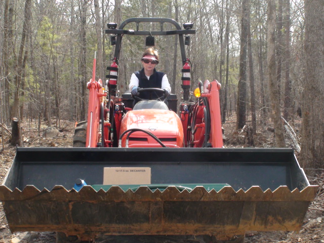

I haven't used it yet, as I wanted to let the paint cure for a few days to harden up before I scratch it off.
I also included a picture of my counterweight. :thumbsup:

Counterweight is a 1/2 size mafia block (3' x 2' x 2'). It surrounded on each side with 4" channel steel, with chains going underneath it to "cradle" it. Not really much to crack unless I'm running into rocks all the time, which I try not to do.
I can get the blocks from a local concrete place for around $20-30 per block. Way cheaper than pouring my own, plus it has rebar in there to use as a lifting hook.

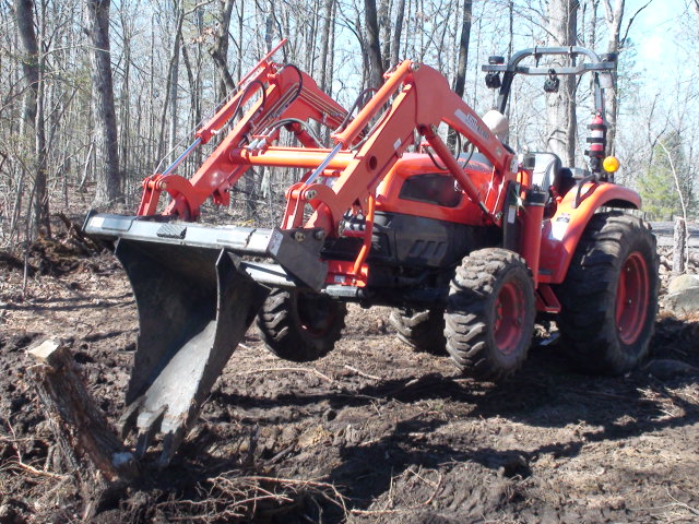

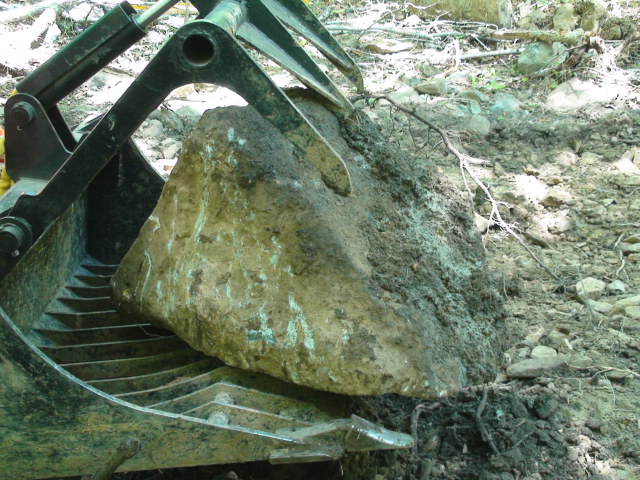

Tried the bucket out. Did pretty well in rocky soil (that was loose from backhoe). I found the larger flat bottom made it much, much easier to get material in the bucket when there wasn't a pile to push against, which will be very useful when york raking or box blading, and wanting to pick up the "junk" at the end of a run.

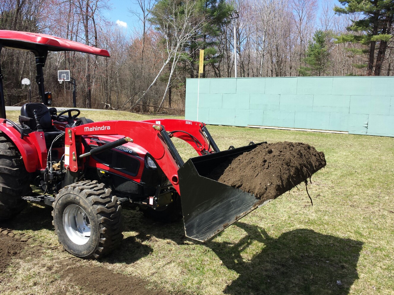

Some pictures of the bucket in use.
My wife was using the tractor to clean up an area of leaves we didn't get with the leaf vacuum last fall. The size/depth of the bucket makes it pretty easy to rake/shovel into, especially compared to the original shallow bucket.
The other pictures are spreading topsoil/compost at a camp in Pittsfield. There's a wiffleball replica of Fenway park there, and we were there to improve the soil/grass. There was 10 yards of compost/soil to spread. I could just about heap the bucket with topsoil, and lift it to around 6-7 feet. Not full height, but would have loaded a pickup. Pretty happy with the design so far for an all purpose bucket.
