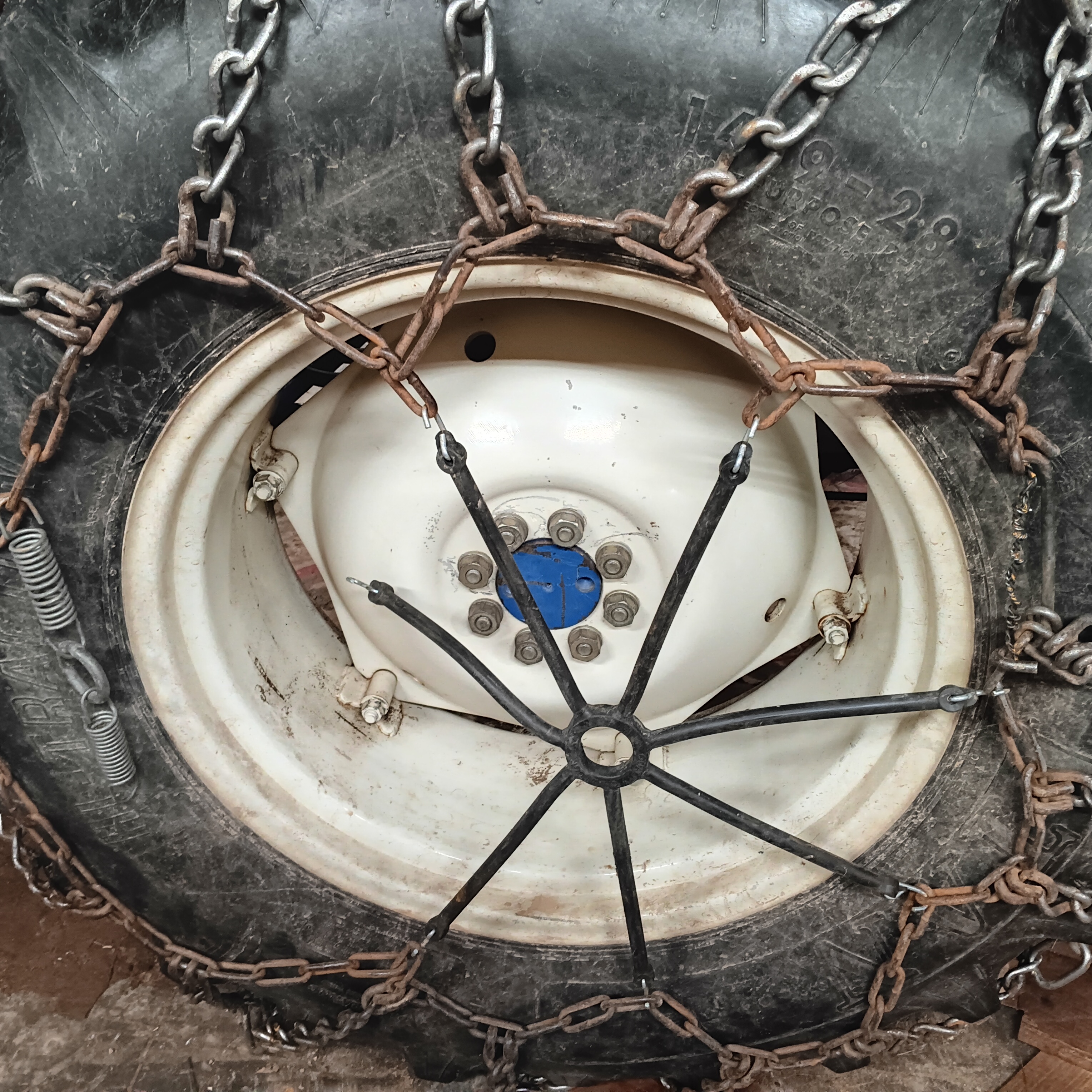

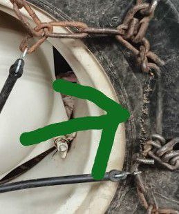

I have a problem when I put the chains on the back tires after I put on the tightner.
I'm thinking it pulls the chain to tight or the tire needs more air.

The size should be on this.
   / Loaded tires psi #6
14.9-28's should be good at 12-20 psi depending upon the load being carried.
Being liquid filled has no bearing on the tires load capacity;
these are 14.9-24's which would actually have less of a capacity then the 28's
   / Loaded tires psi #7
The problem isn't with the tire or it's air pressure. As I mentioned in your other thread, the chains need to be shortened.
   / Loaded tires psi
OK how do I shorten the chain? What end do I start at.
   / Loaded tires psi #9
   / Loaded tires psi
The twisted wire is to keep the chains they do damage when they come off.
I wish I had cams on the chains you turn up and hook into a link. In the Spring I will buy new chains for the tire size.
