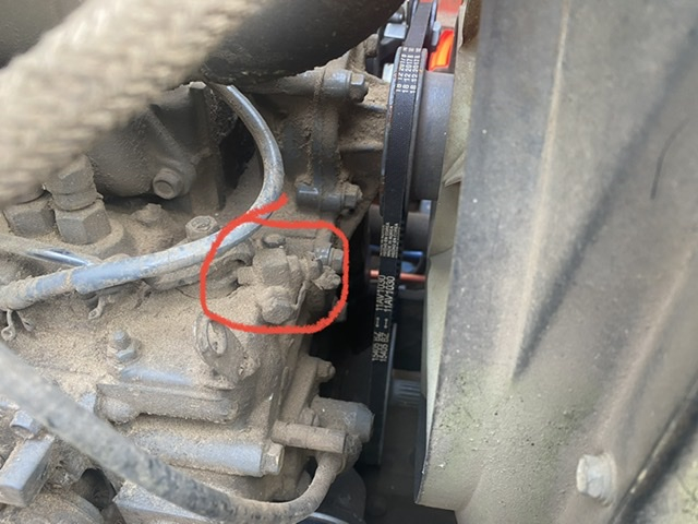

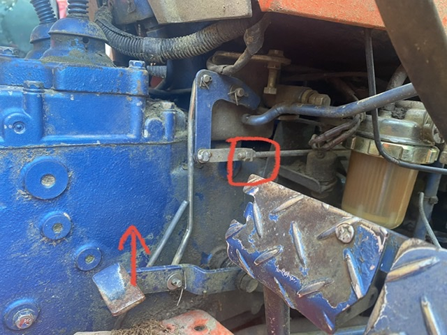

Okay I have your solution. See pictures below.
First you need to loosen the nuts on the linkage I circled in red. Back out on the nut on the left to about where the one in the picture is located. Then adjust the nuts on the right tight against the lever. This will cause the foot petal to come higher off of the floor indicated by the arrow.
Do not worry about the petal getting higher because the actual engine speed is controlled by this stop circled in red on the injection pump.
That will allow The hand throttle to open the tractor up all the way. Just adjust the length of that rod till the hand throttle pushes the injection rack against the stop.
Hopefully that is clear enough for you to fix.

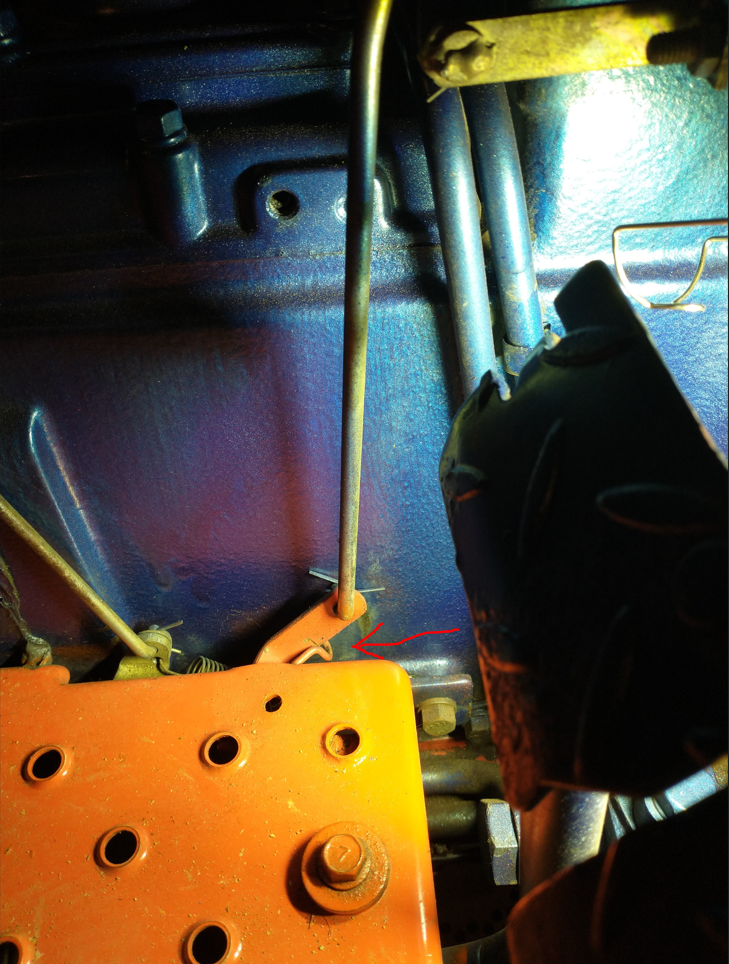

Thanks for the good pics and explanation. I tried your recommendations and when I do, it does move the C plate closer to the throttle lever, just like you said. but what it does is keep the foot pedal too far away from the foot pedal return spring. (see the arrow pointing to raised gap). so the pedal return spring doesn't function like it should
Seeing how everything lines up, it seems like the pedal is supposed to sit flush in that return spring channel. when I do that, I am back to the original problem.

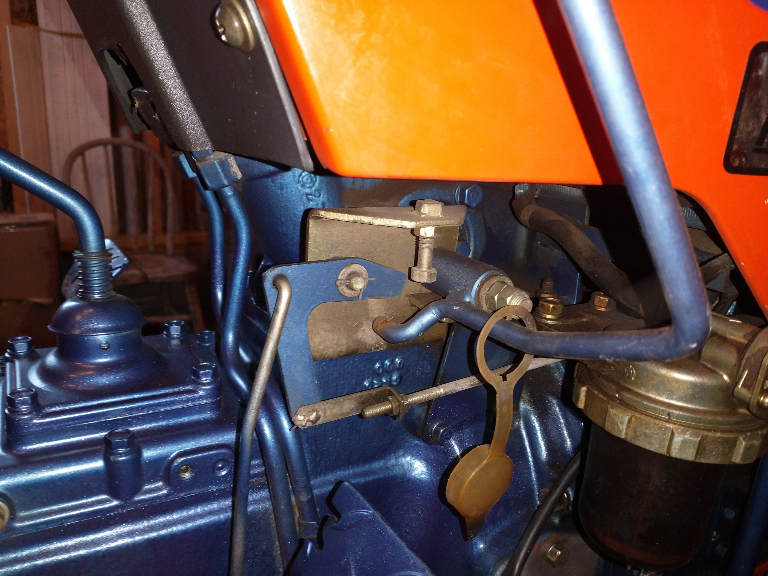

Does your hand throttle hit max rpm when in the full forward position? Can to take a picture of the C plate when you push the hand throttle forward to the max? I want to see where your hand throttle is hitting the C plate. Thanks.
/ LK3054 accelerator lever question #10
Yes it does. I will take a picture of it tonight when I get back home.
/ LK3054 accelerator lever question #11
Is this what you wanted?
/ LK3054 accelerator lever question #12
I see that the linkage from the "C" plate to the foot pedal is orientated differently between your tractors. Not sure if that would make a difference.
