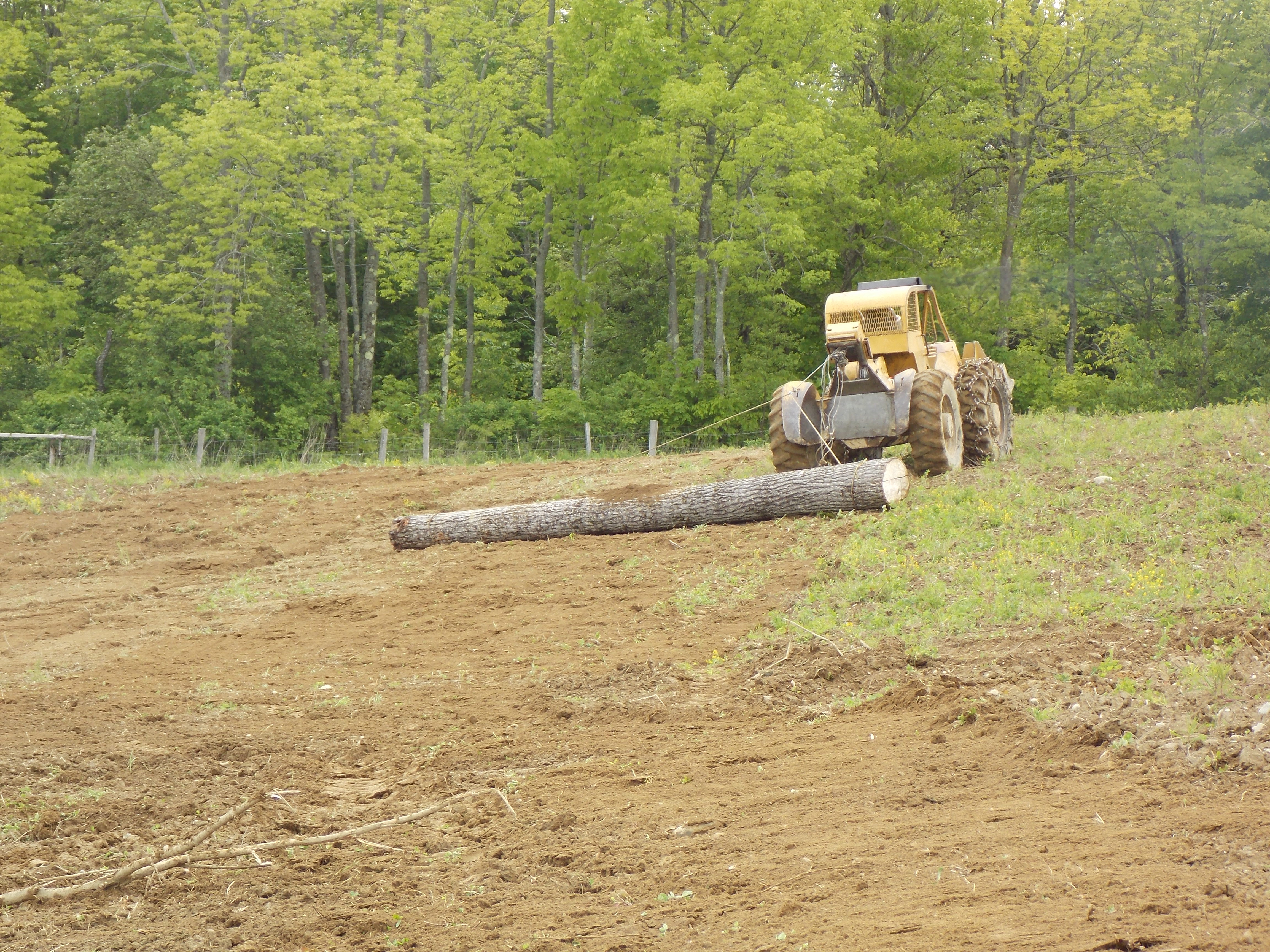

I am super cheap, so I would first start by dumbing-down the ruts as much as possible. A great way to do that is to just buy some cable and drag a log sideways over the area. That works good because the log does not "catch" on anything, but rather slides and rides over stuff, yet knocks down the high spots. After a few passes it should really make a big difference, but attack the area from different approach angles. In this case the log does not have to be that long, but heavier is always better.
After that, you can determine if the log is working enough to keep going and get it super smooth, or get a disc in there and loosen the soil more if it is not. Again dragging the log over the area again after discing it, will further get it smooth.
This is me rejuvenating a field, so I am using a long, heavy log, but you can see what I am referring to. Just do the same thing with an 8 foot log or so. All you will have in it is the cost of the cable and some cable clamps.

/ Little help with what to use #10
Even if you are able to find a disk harrow to use - I would first use a log like Broken Track pictured in post #8. I've found that my disk harrow works a world better if the sod is drug and busted with something first. If the disk harrow can make just a couple inches of penetration - you can go over and over the rough spots and finally obtain a smooth area. In my location - using the disk harrow first requires a really large, heavy unit to get penetration.
Damm good idea !!
Chain probably would be safer.
