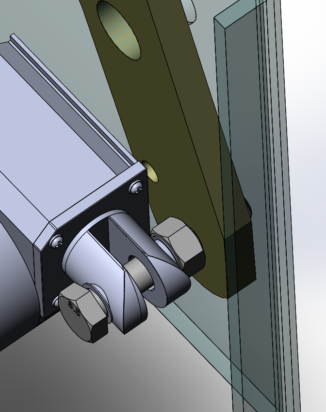

I measured the travel on my SSQA. On mine, the bottom bolt that attaches to the spring/pin etc. travels "exactly" 4". It is a 12x1.25x25mm bolt, according the the parts diagram.
As such.....
8" travel 100lb force actuator from here: Linear Actuator IP66 | Progressive Automations for $149
Replace the bolt that is there with a longer bolt and a nut (mcmaster numbers 91180A731 ($7.48) and 91415A235 ($9.41)).
Probably some washers 98023A033 at $6.00 or locally by the pound.
Seems like this should be able to be cheaper, but some tubing 7767T53 @ $45.16 (or, for another $100 they will make me a custom length shaft). Maybe some black pipe or something? Needs to fit over the 1.1" shaft without "much" slop.
Cost: 149+7.48+9.41+6+45.16 = $217
Still need wiring, plugs, and switches.
See mockup of one end mounting below:
Notes:
  • There isn't a quick-removal if the thing screws up. That was one goal I had originally, to be pinned on for easy removal.
  • With the 8" actuator, I am maximizing my leverage. As such, I'm pretty comfortable using the lower force (and faster!) longer travel actuator. I just didn't like where the 6" travel actuator needed to mount.
  • I don't have to drill holes, tap, or anything.
  • I DO have to lengthen the threaded section of the new bolt, I think. A tap is $6.
  • I am using the intended mounting (including fastener size) of the actuator
Thoughts?
EDIT: A chunk of 1" schedule 40 black pipe will work out real nice cause the O.D. is a bit less than my mcmaster number'd pipe above. Just need to drill/ream/flapper wheel the I.D. a little bigger to slip over the actuator's shaft. Likely easy enough. It's 1/2 the cost of the pipe listed above. Both prices from mcmaster. I think I need a 16" length, so this 18" piece for $8 is even better... LDR Industries 1 in. x 18 in. Black Steel Schedule 40 Cut Pipe-306 1X18 - The Home Depot
So the price would be more like $180.

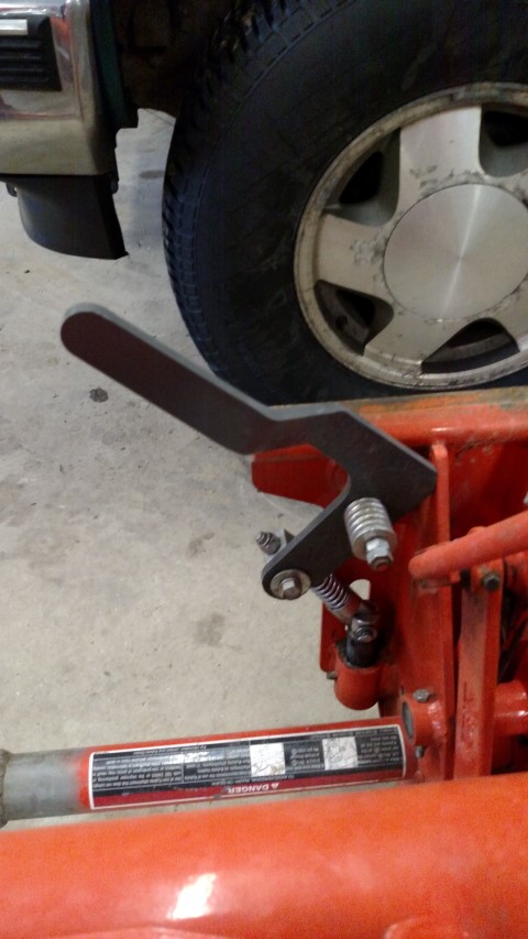

Looking at the lever, I may be talking myself into the 400lb version.....
The lever is probably 3x as long (or longer) where I pull on it, vs. where the actuator will be. I've had to put some oomph into it before.
Then again, that was cause one of the pins needed grease.
I'm torn........

I was always told in engineering things, to go with a 4 to 1 ratio to what might just barely work to what has lots of margin. When you stress things they often fail prematurely. In English, get the bigger one. Take this advice as you see fit.:)
   / Linear actuator for power SSQA? #108
As an engineer (with a dozen years experience, holy crap), I can't particularly disagree. 2x-4x, probably...
However, in this case, which is which? If the levers were the bridge and the actuator is the semi-truck, shouldn't the truck be 1/4 the capacity of the bridge?
To guarantee that you have enough force and not "strain" the actuator, the 400lb one all the way.
To guarantee that I do not F-Up my tractor, well, the 100 pounder.
All that said, I've made myself concerned enough that I think I'll do the 400 pound and under-fuse it, like the OP. I have enough discover miles to pay for it on Amazon too. Hmmm.......
