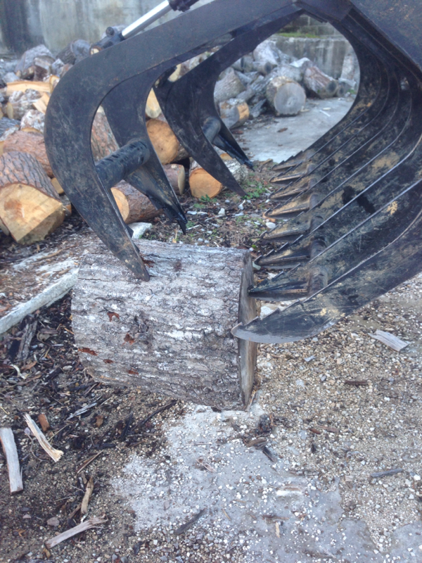

My bobcat ct120 can lift about 400 lbs. could a Linear Actuator with a lift force of 200lbs work for a thumb on a bucket. Mostly to hold brush on the bucket for traveling. I don't intend to lift logs with the bucket tilted down position.

From what I can see online, a 12" stroke 2000# linear actuator would take between 24 and 48 seconds to move the 12" which seems like a long time.
A lot of people have learned the hard way that the force on a thumb from a curling backhoe bucket is much greater than they expected. Things usually don't like compression loads unless they have excellent pivoting connections on each end as a connection with friction under load puts a bending force on the push rod resulting in damage.

I falsely read 200 pounds for 2000 pounds. I think it's severely underpowered now. My grapple doesn't bite hard enough to suit me and assuming it had 2" bore cylinders at 2600 psi that's about 8100 pounds of push. I could calculate it fairly accurately by taking some measurements, but just taking a guess the closing pressure at the tip is about 1/4 that much. I want to build a grapple with about a 4" bore cylinder, but it's not practical because of the strength it would have to be not to self destruct. image-623462789.jpg
