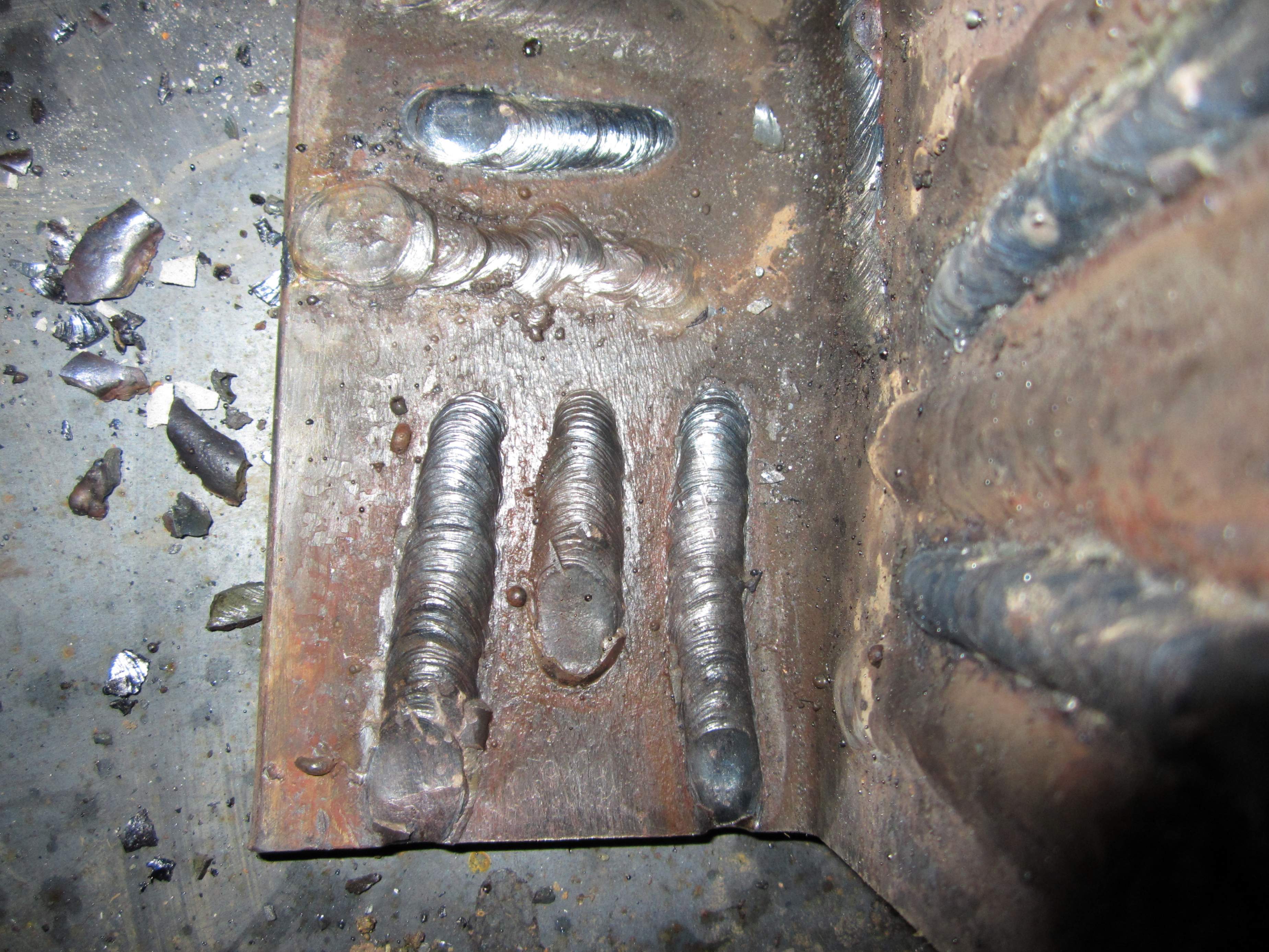

Well here is a picture of some of the beads I made today. 7018ac 1/8, 130 amps ac. The dull one second from the top is an old weld that was on the plate already.

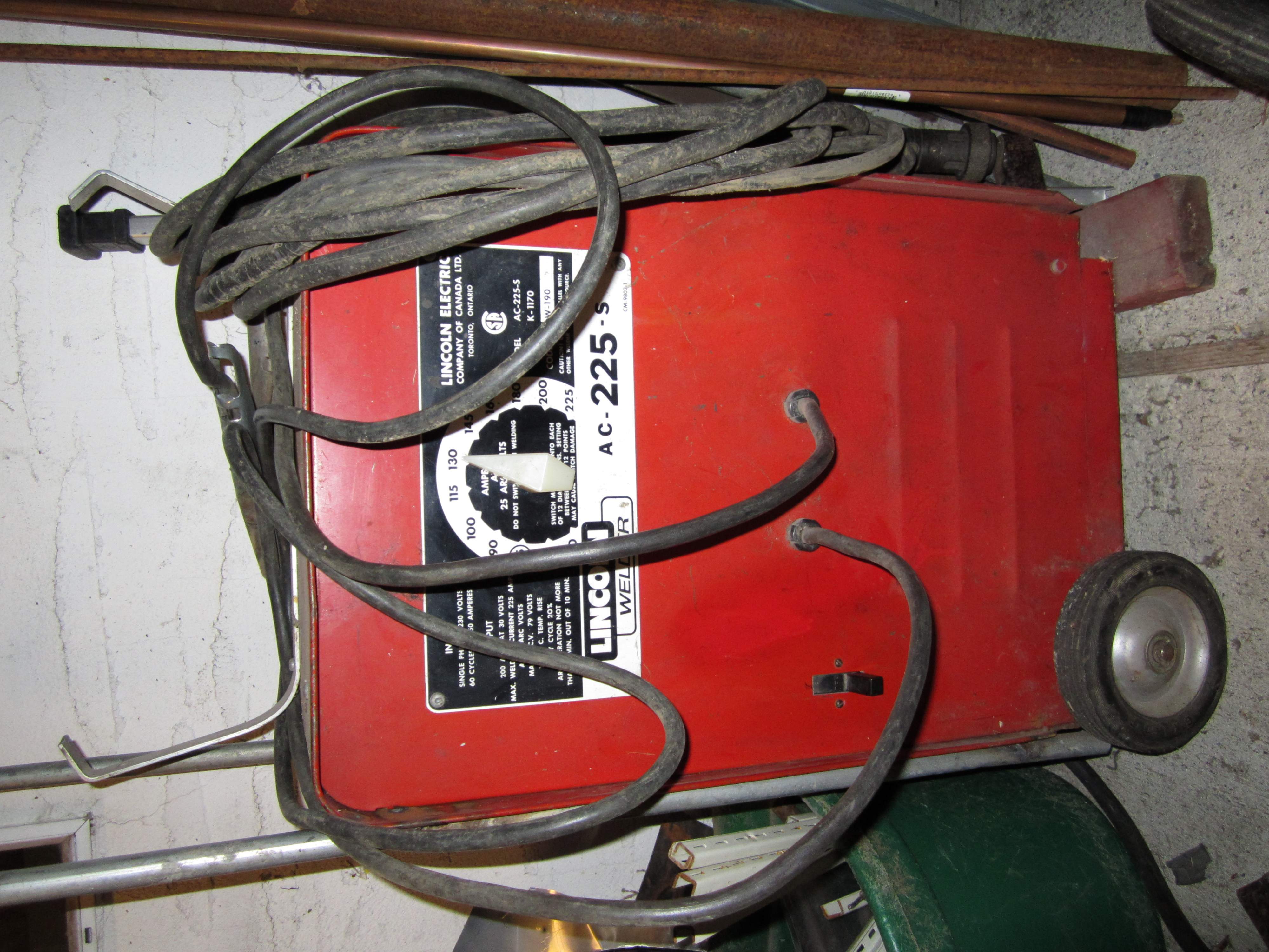

And just for the sake of it, here is a picture of the welder that did it all.

Looks like your travel speed is a little to slow. It's hard for anybody to make welds look good on a flat piece of plate, soon as you can start working on fillet welds.

Ok, I actually had to speed up quite a bit to get them this good, I guess I will try again moving faster. I think I will try doing a few fillet welds tonight.

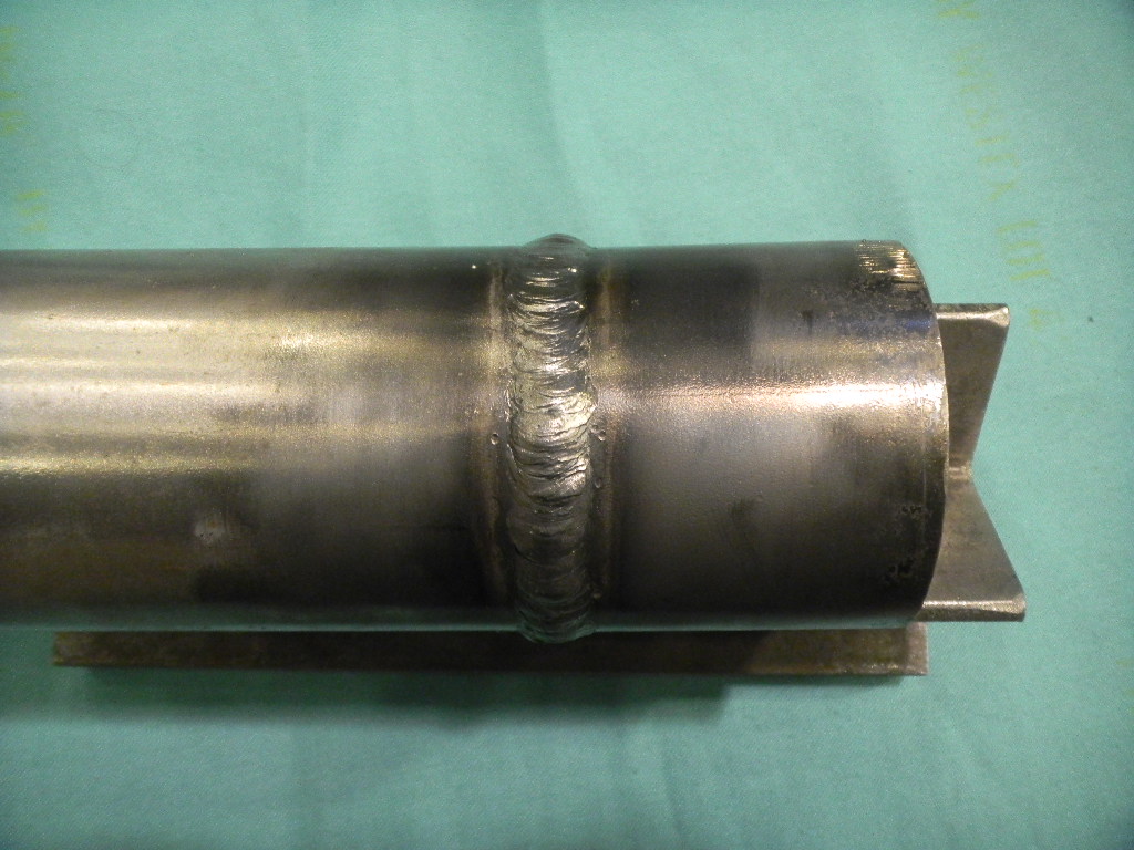

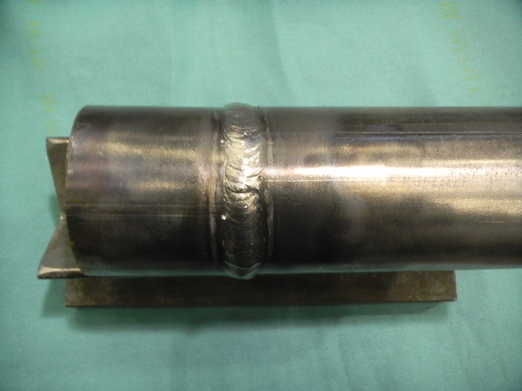

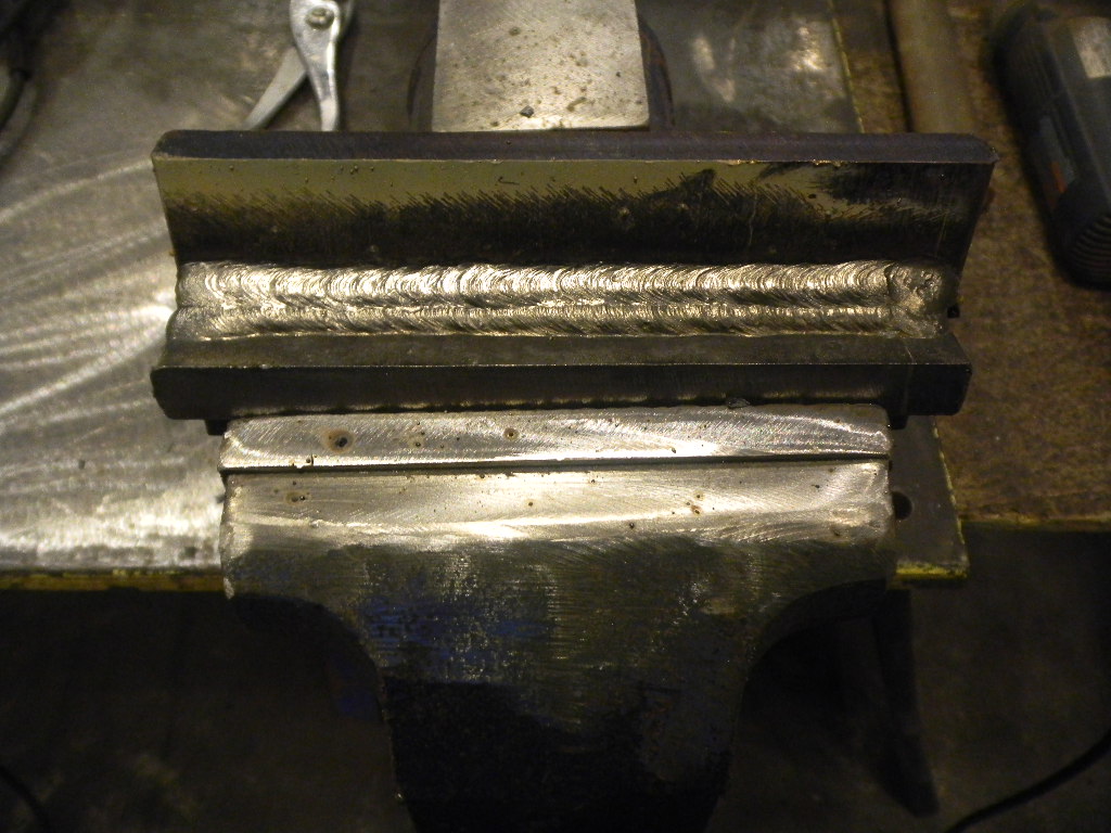

I thought I might wake up my 46-year old Lincoln, and my neighbors this morning:laughing:. So I played a little with some 7018.
