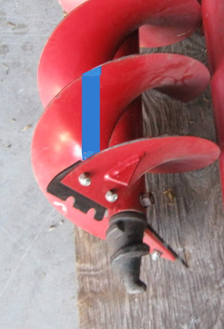

Now living where there are too may rocks and roots, I've never tried this. If I lived where there was "screw-in" soil, I would make this modification and see what happened.
A sharpened strap, maybe 1/4 x 1 1/2, welded between the bottom flight and the one above, like the blue shape in this photo.
I think it would stop the screw-in problem, if you don't have rocks to get trapped.
