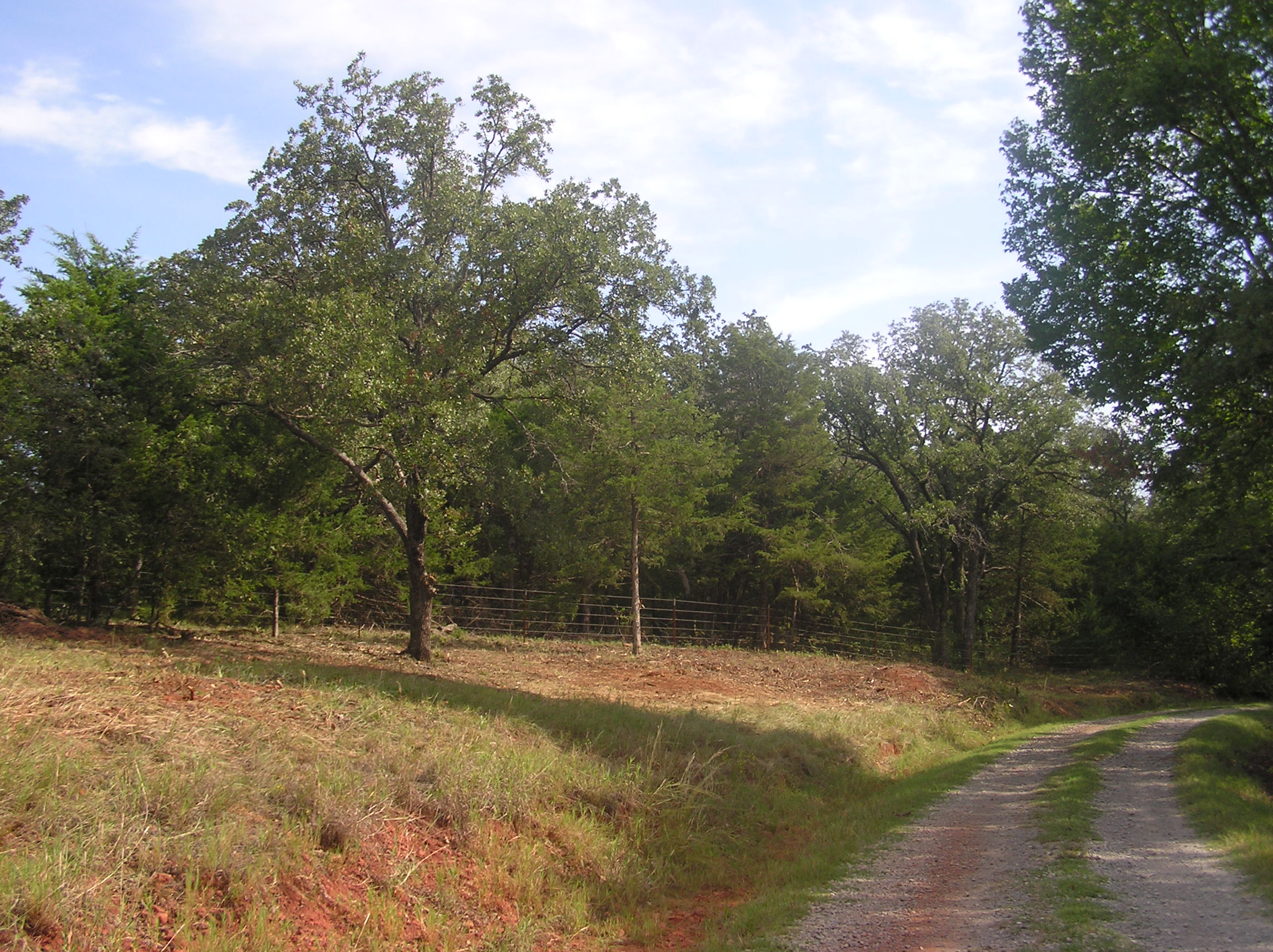

Man, is there ever a lot of confusion over this stuff. Different dealers are saying completely different things.
What is your comment on "differential only working in 2 wheel steer mode"???
I just tested ours in 2 wheel steer, by approaching this steep rise at the edge of the driveway at an angle, so only the left front wheel goes up it.
As soon as the right front lost traction, the left rear would spin also, so the limited slip is not working on our 5610 F.
