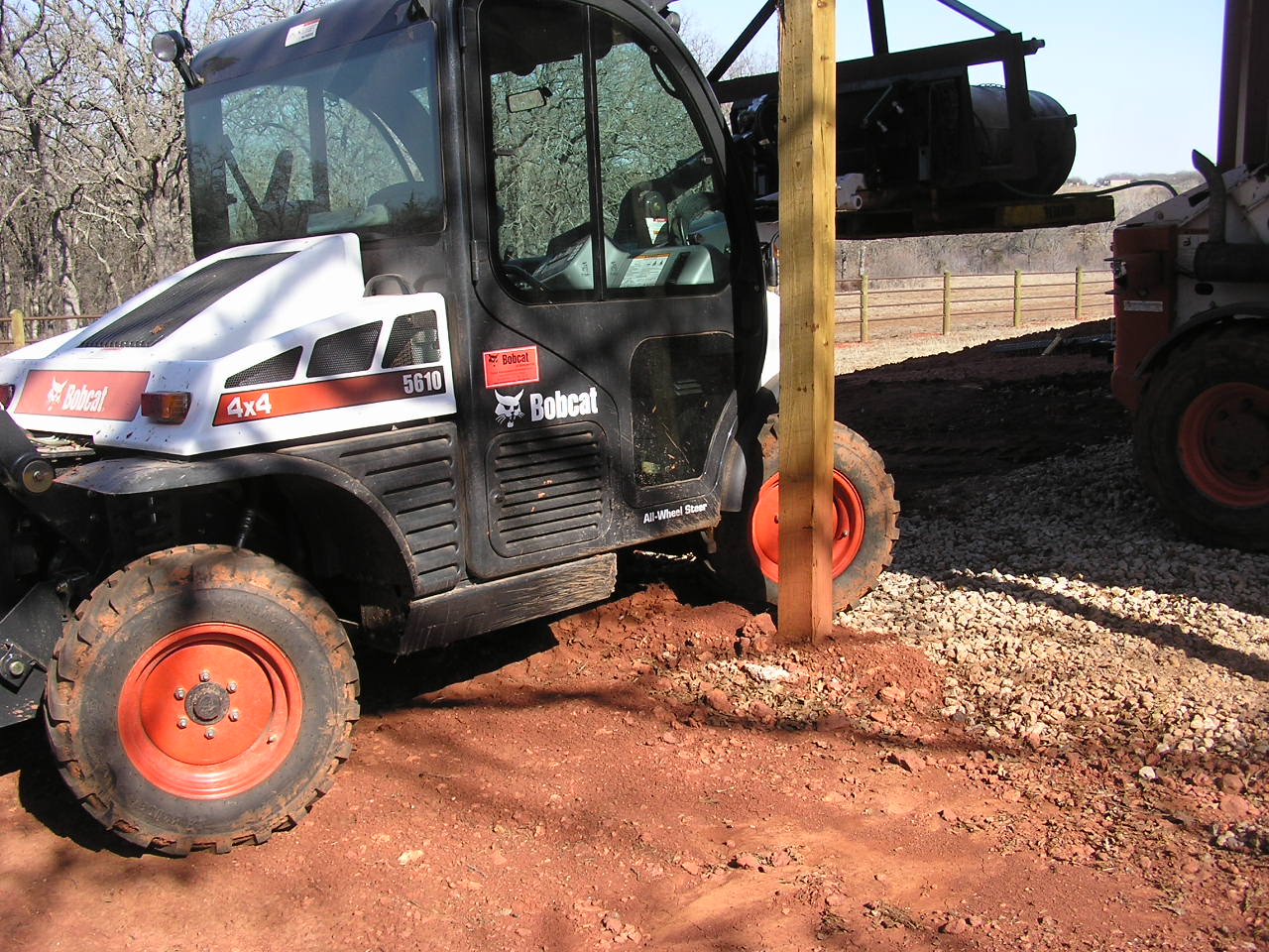

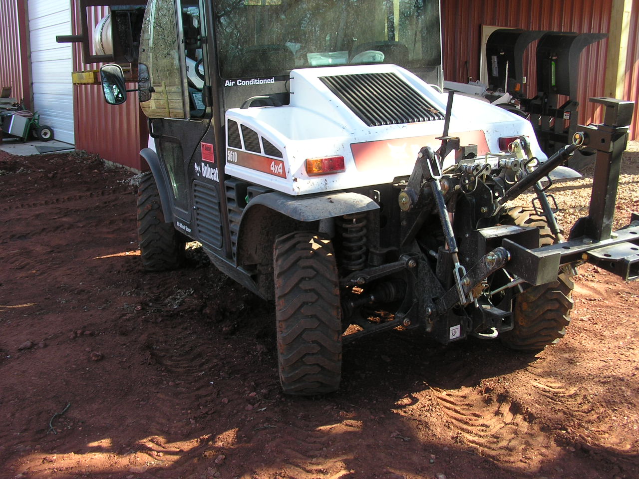

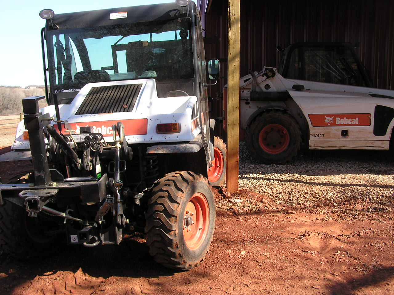

You can put the rear wheels at the needed angle, then switch to two wheel steer. The rear wheels will stay at the angle, giving you crab steer to get out of trouble or get close to something.

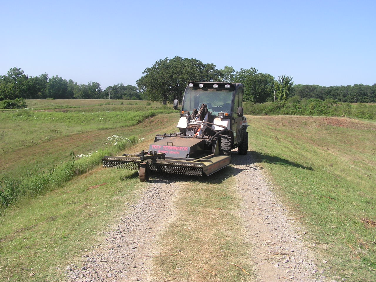

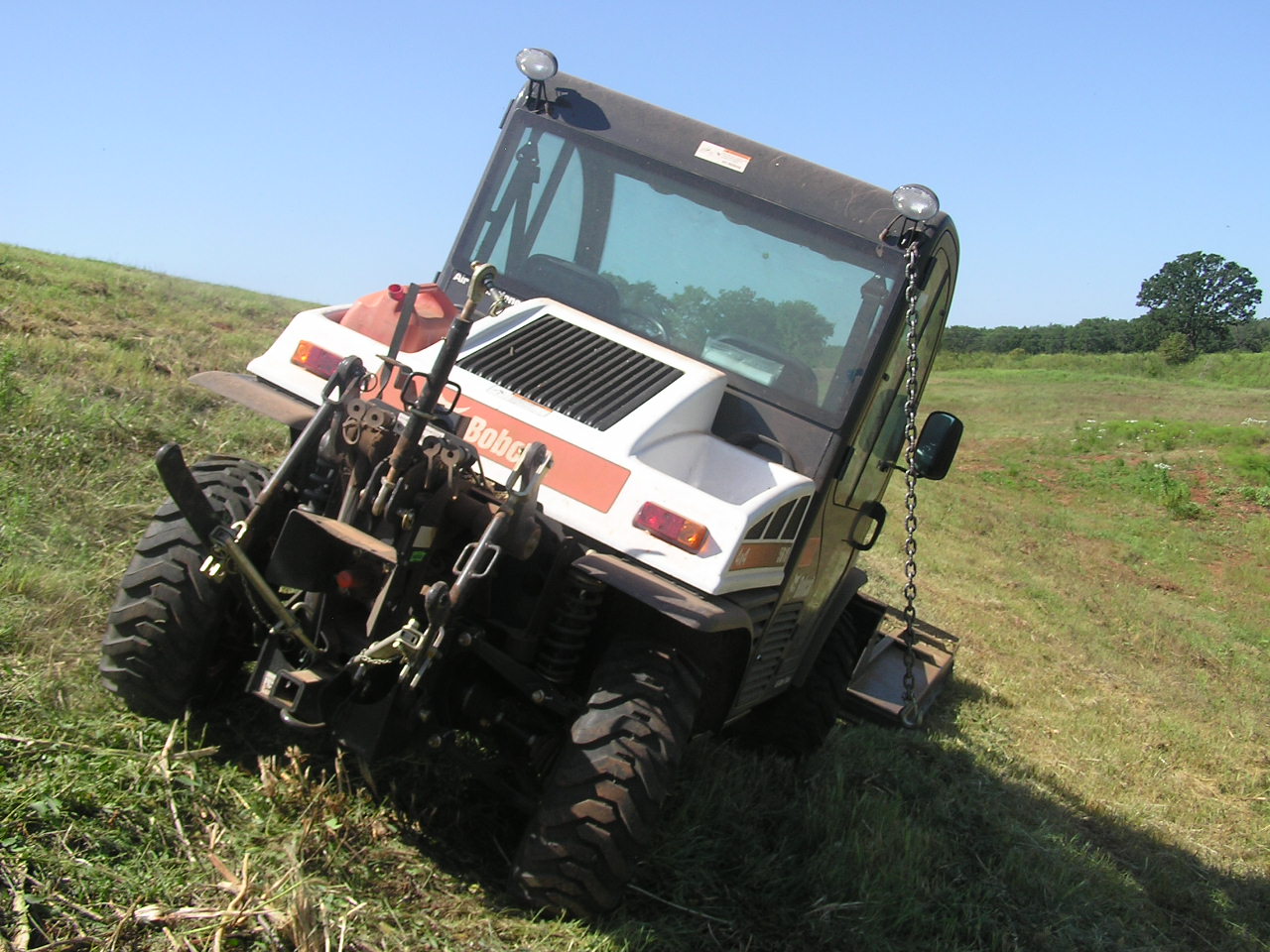

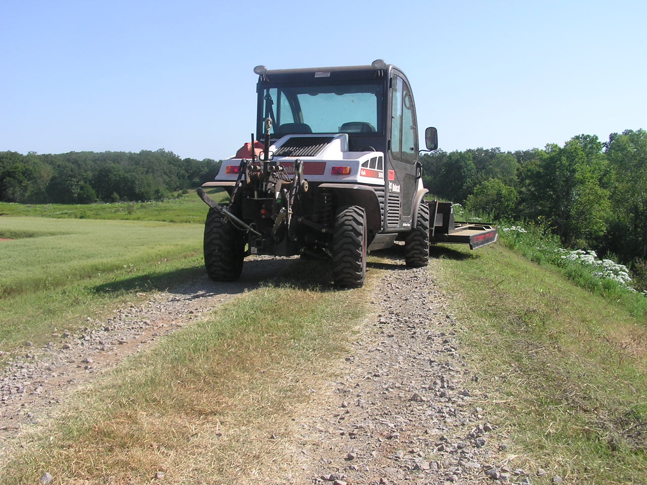

I set an angle when mowing the dam, feels less likely to rollover.
