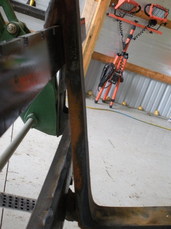

Good news, Fedex just showed up with the ATV Express forks and rails, and they look great. Rails are 1/2" as advertised, nice and clean, and smoothly cut/beveled. The frame from Chris is due tomorrow afternoon, so in between half a dozen other things going on around here I can soon break out some 7018 rods and get started welding things up.
I have actually considered taking the rails to a local machine shop and having a couple of extra fork locking "notches" cut on each side of the top rail, to allow five different widths for the forks vice the current three. Haven't made up my mind yet on that, but of course if I'm going to do it I have to do it now. Any opinions on whether having five locking fork widths available vice three would be worth the machine shop expense?

I received a very apologetic e-mail from ATV today, as well as the new tracking number for a new 1/2' bottom rail at their expense. Even though this will cost me time, money for a 1/4 additional plate, ATV has been very helpful in resolving my issue and I can't complain about that. My suggestion to ALL, ordering the rails and forks from ATV is to Clearly specify that they are for Chris Perry's frames and are to be 1/2" upper and lower.
Also, it is very important to note that Chris had absolutely nothing to do with this mess, but he has been more than helpful in calling me at home, diagnosing the problem and offering to help fix the problem. I would buy from Chris again without any worry.
The only other "odd" issue I had with ATV's parts is that the forks are unpainted and have slight surface rust. Yet the rails, which are to welded have this cheap, gummy, greasy, black paint that smears more than it sands or grinds off.

Yeah, and so did I. However, ATV sent me a 1.25" top frame and 1/2" bottom frame.
They don't line up, post welding. I am trying to resolve this with AtvExpress. Chris' work is excellent.
Make sure you receive a 1/2" top and bottom set of rails. NOT a 1.25 upper and 1/2" lower set, as I did.
Resolution pending with AtvExpress.

Frame arrived right on time, Chris. Excellent packing job, and I was surprised at how clean everything was. I'm used to seeing a big ugly layer of mill scale on new steel.
The welding is going ok after some initial hiccups, namely yours truly had forgotten how careful you have to be to weld thin wall tubing to 1/2" plate without blowing holes. Started out with DC+ @125 amps which turned out to be a little high. Settled on 115 amps after the first few inches of weld and everything went a lot easier after that. I was tempted to use 3/32" rod but I was afraid the penetration might not be sufficient in the 1/2" plate with that, so I opened a fresh can of 1/8" and it's working fine now that my "technique" has improved. My welds won't be as pretty as you'd have done them, but in spite of that I don't think they'll come apart. :laughing:
Nice fit on everything, thanks for your quality work.

The original unit that I built for myself was with regular structural steel which has mill scale. Everything built since then has been with HRPO sheet which, not only has no scale, but is also 25% stronger in yield strength. It's good stuff, the perfect material for this application. No pre-grinding whatsoever.
It is great that you got the parts in and were able to get right to work on it. Too bad about the blowout. Hopefully it was on the bottom of the frame or you were able to fill it in and grind it back. If it was near an end on the top rail (near the hooks) definitely get it patched up as you don't want to leave a stress concentrator in that area.

Rocket scientist me, I started my weld stitches from the top of the top rail, instead of warming up by starting on the bottom of the bottom rail, so the only "bad" weld was right up there on top. :) However, I was able to grind it out and fill it cleanly, so I think it's ok. I got better as I went along, of course. I should have started at the bottom of the bottom rail. Lesson learned.
Tomorrow is weld wire-brush and cleanup time, might even get some primer applied. I've built a lot of Heathkits in my day, this is even more fun.

A new unpainted 1/2' bottom rail arrived today. So next week's project is set to cut off the bottom tabs on the current 1/2" plate, shim out the new bottom rail about 1/4 and reweld.
Pics next weekend.
