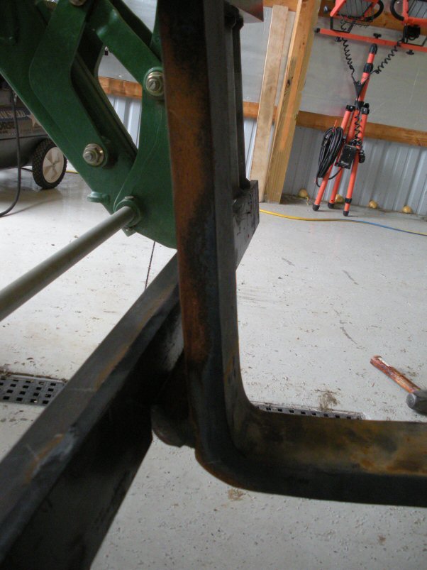

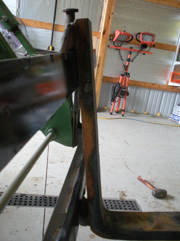

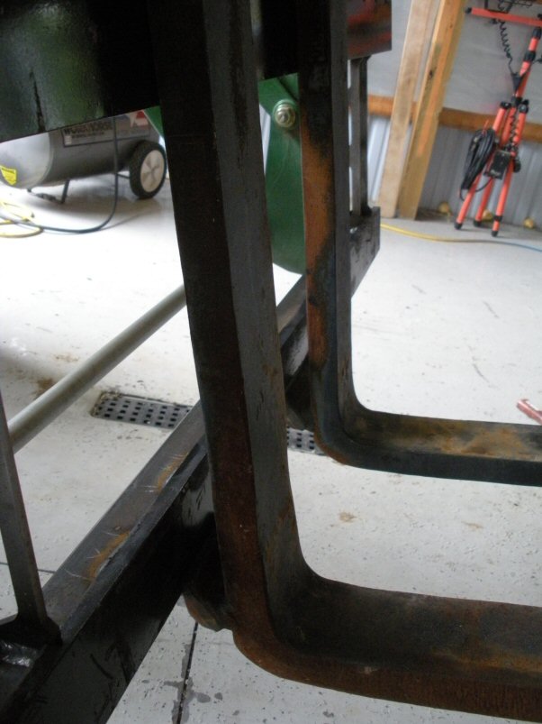

Yeah, and so did I. However, ATV sent me a 1.25" top frame and 1/2" bottom frame.
They don't line up, post welding. I am trying to resolve this with AtvExpress. Chris' work is excellent.
Make sure you receive a 1/2" top and bottom set of rails. NOT a 1.25 upper and 1/2" lower set, as I did.
Resolution pending with AtvExpress.
