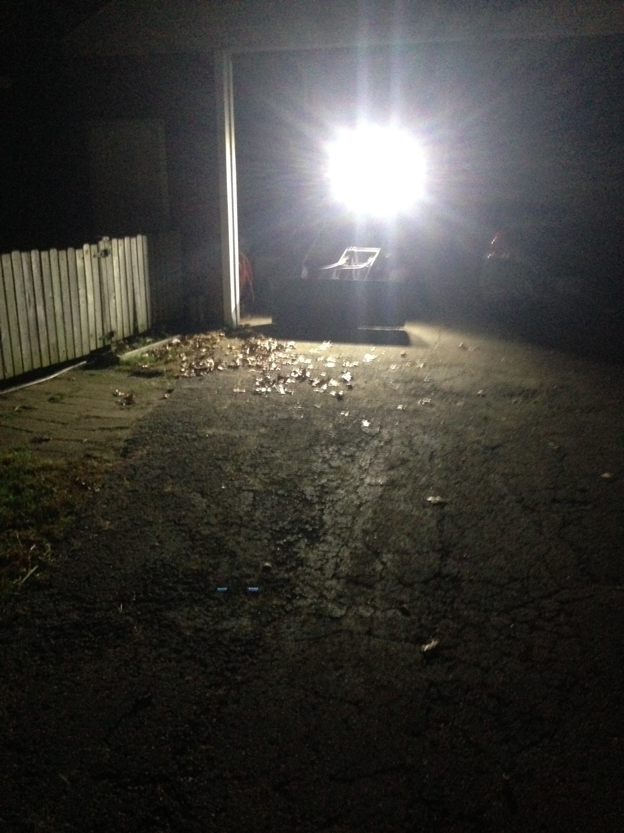

Here's some pictures. I'll get some closeups of the mounting tomorrow in the daylight.
Photo 1 is my two working existing lights and one new one. Side-by-side you can really see the yellow of the old incandescent and the white of the new LED.
Photo 2 is two of the new LEDs only. Pretty nice white light if I do say so.
Photo 3 is just the two of those little buggers blinding the camera! :laughing:

Well, the verdict is in. I used these in the dark to plow snow the other night and all I can say is I am VERY SATISFIED with the lights! :thumbsup:
What a nice, white light they cast. Really easy to see around the tractor now.

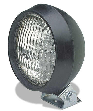

We all got lights like this standard on our PTs.
They are about $10.00 to replace. They consume 35W of power and they aren't that great.
These LEDs are about $16.00, only consume 18W, are smaller, appear to be a heavier all-metal case, and cast a much nicer white light VS the yellow light.
So, if I were going to spend $10 I might as well spend $6 more and get something a lot nicer that uses about half the power.

yup. I bought the round ones, put them on and didn't like them. Then I got the leds, mounted one on one side and compared them. Took the other round one off, and put on the second led.
The leds stay. The round ones are now in a box somewhere.
