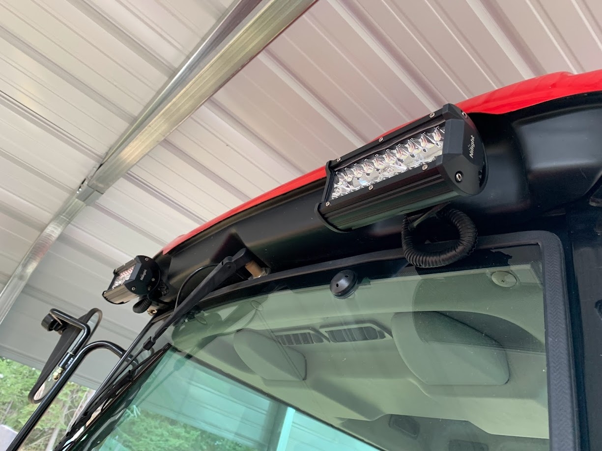

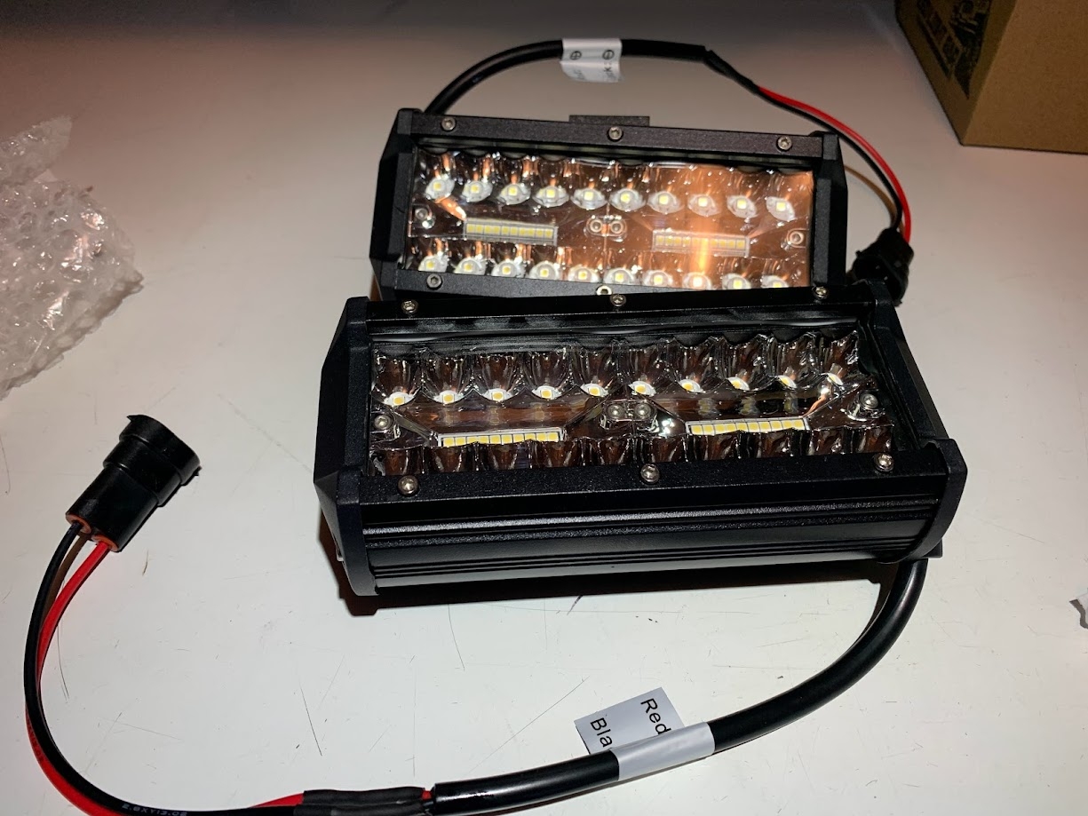

What's the wattage on the bulb? I don't know if this is for you, but I bought whole LED Nilights from Amazon and put on female 880 connectors using the stock wiring. It is a whole world of difference.
Front and rear
880 female adapters that I soldered onto Nilight harness.

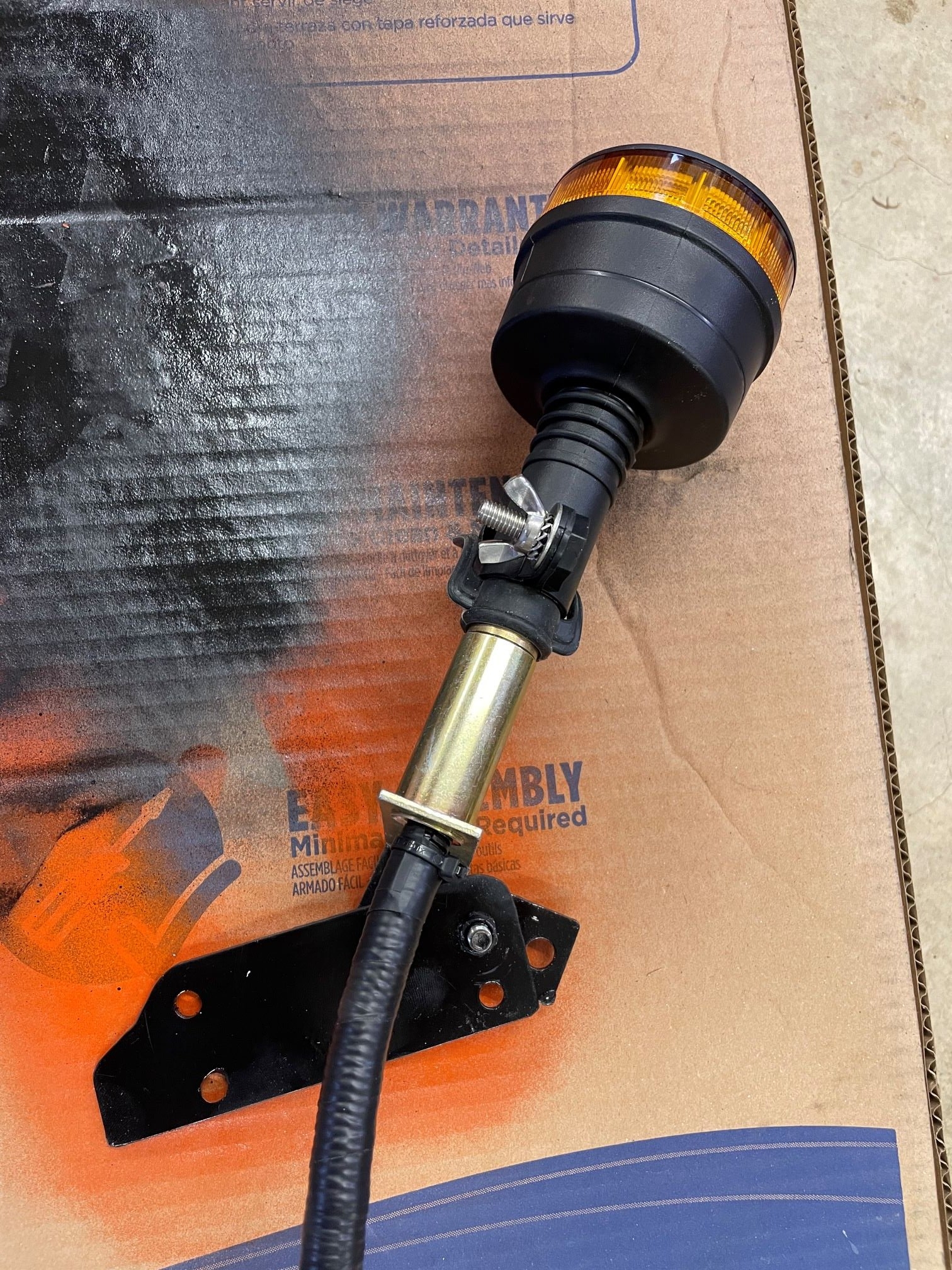

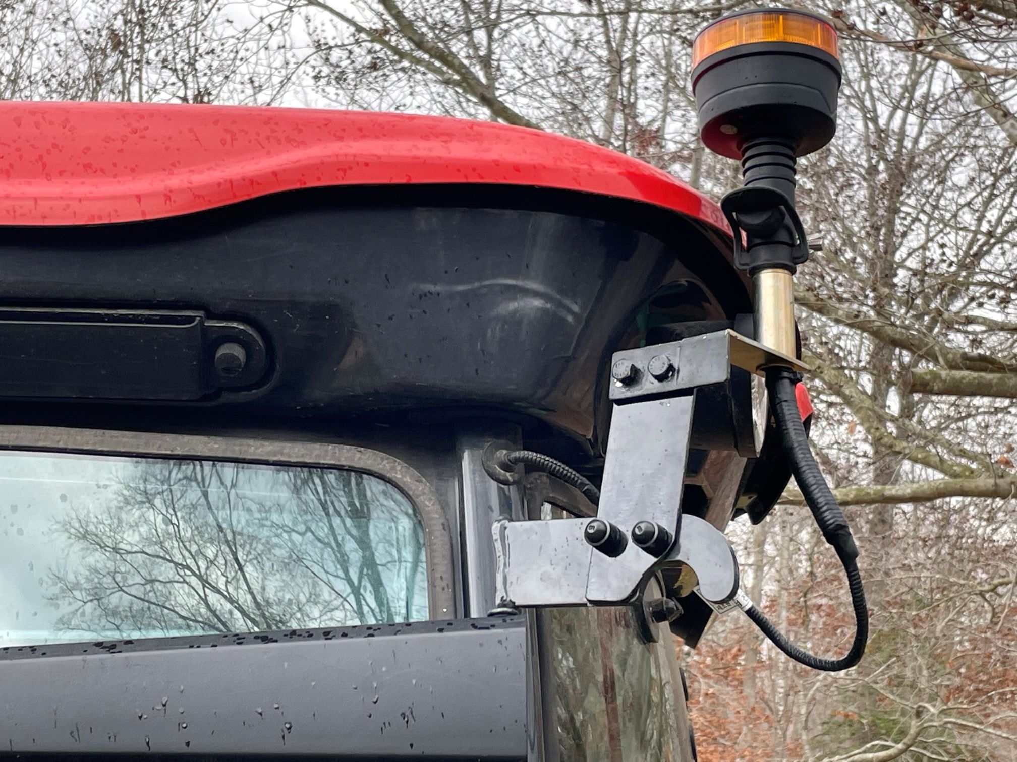

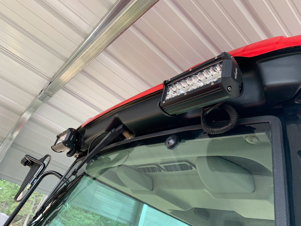

Never heard from Kioti about lights, no real surprise. Because of you all I ordered some nilights to replace the factory. Waiting on my helper to lift cab roof.
While waiting, I got the Kioti Beacon lamp kit DKA149 (~$40) to power the rear plugs. I also ordered an Agrieyes pole mount beacon and bracket (~$42)
The beacon kit provided the relay, wiring harnesses (one for switch, one for light) and switch. Pop the hood, add a relay, remove 3 console screws, pop in new switch and harness. The extender is a steel piece 2"x6"x 1/8"

I put 3M hefty double sided taped steel brackets on my composite roof, and added a magnetic LED beacon to mine.

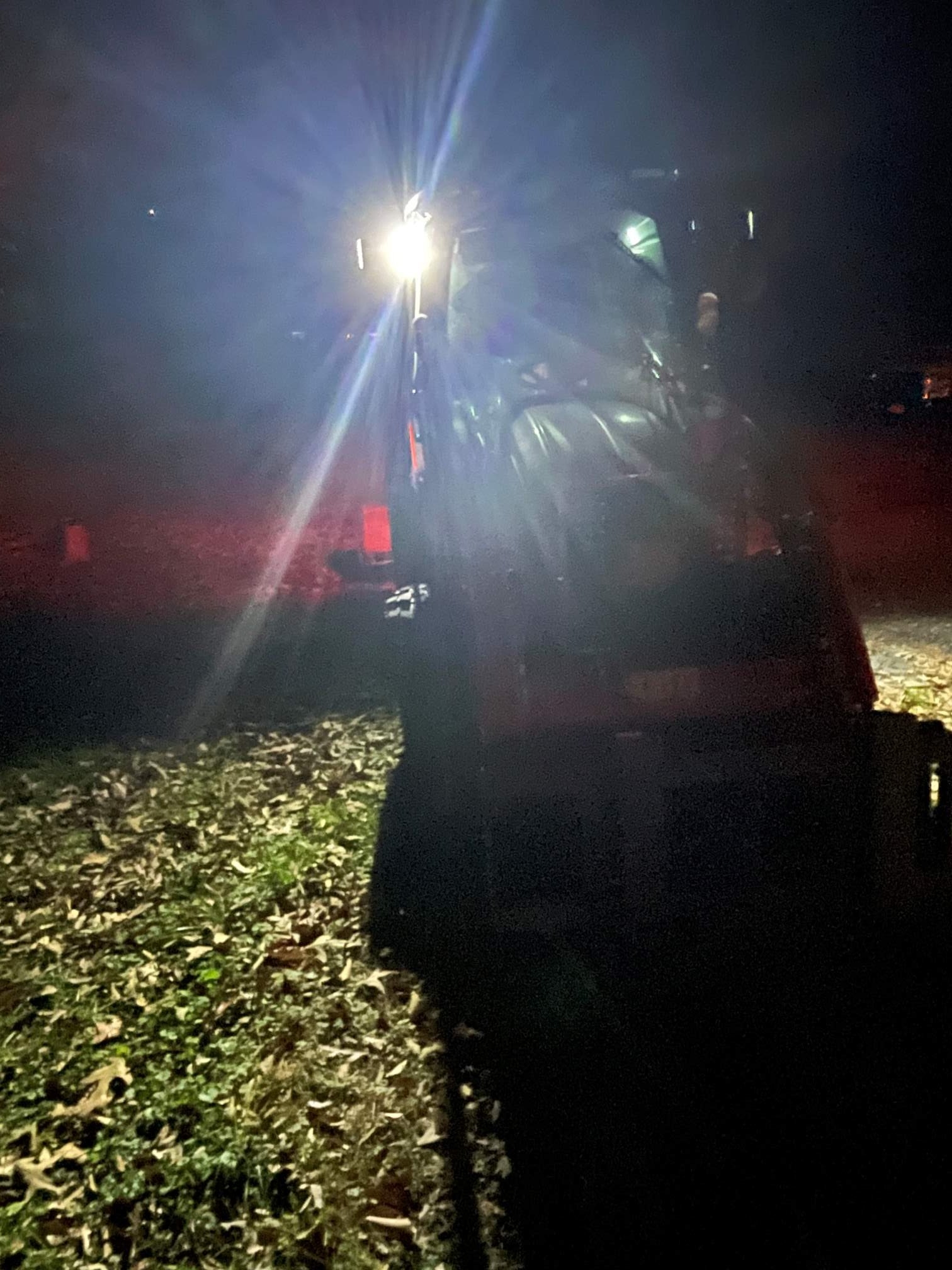

After some use shifting the manure pile, I decided some side lighting would be helpful. The Dk has the same plug and mount on both rear sides so I sourced a new plug 7222-1424-40 - Yazaki | SWP-2P - Corsa Technic | 2-Way Kit for the other side (beacon kit had one) and added 2 - 6" leds to the beacon circuit

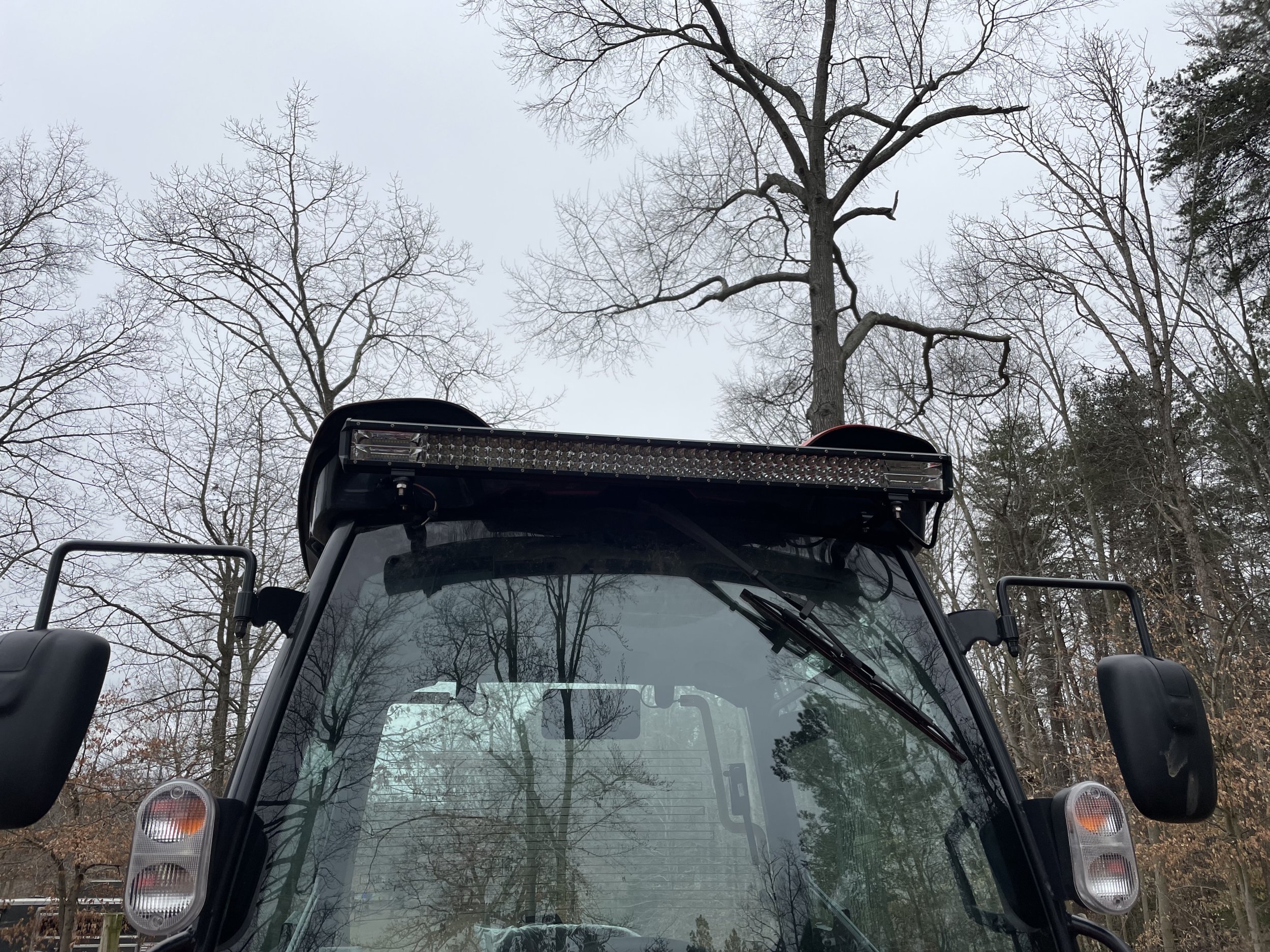

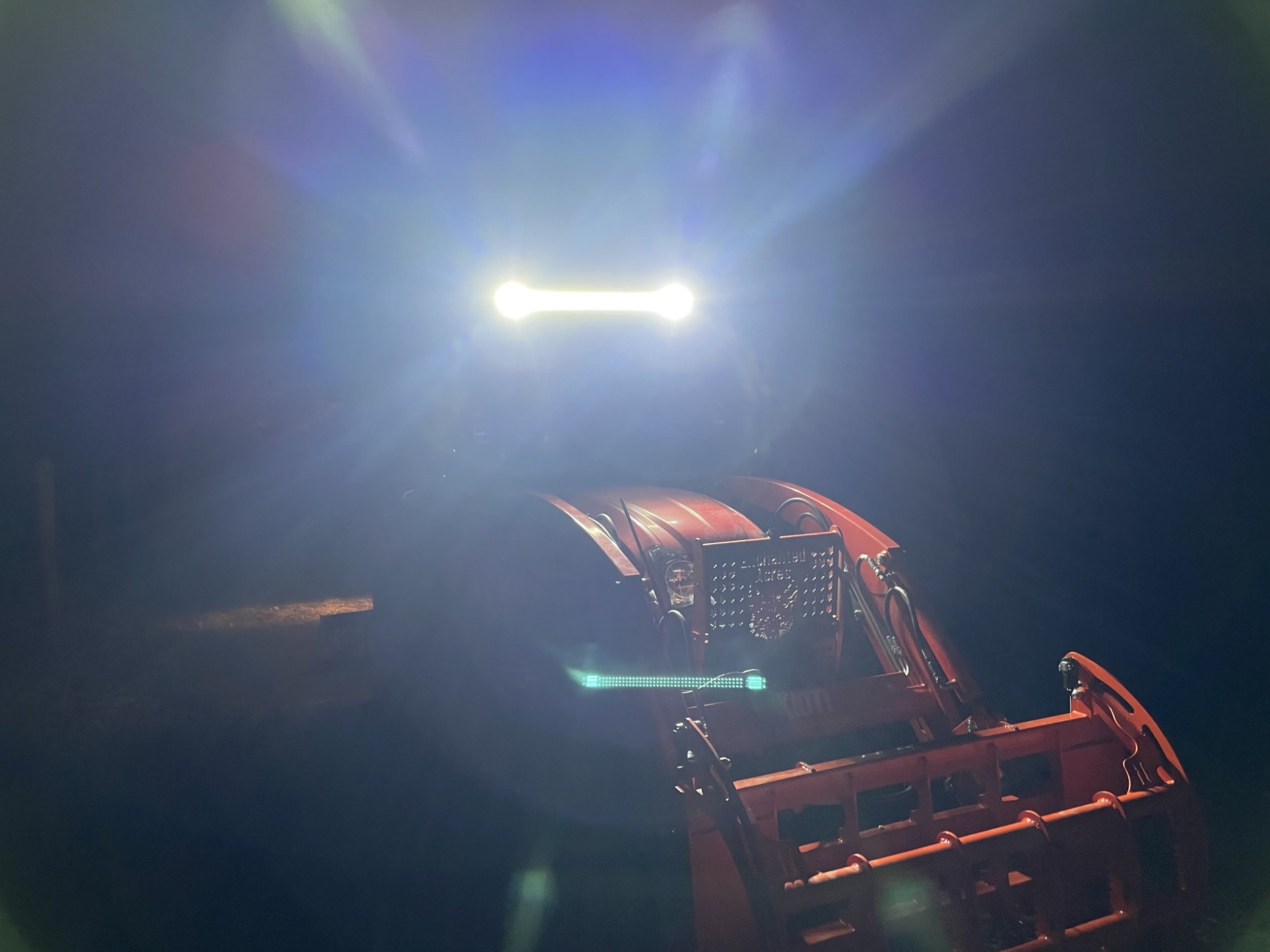

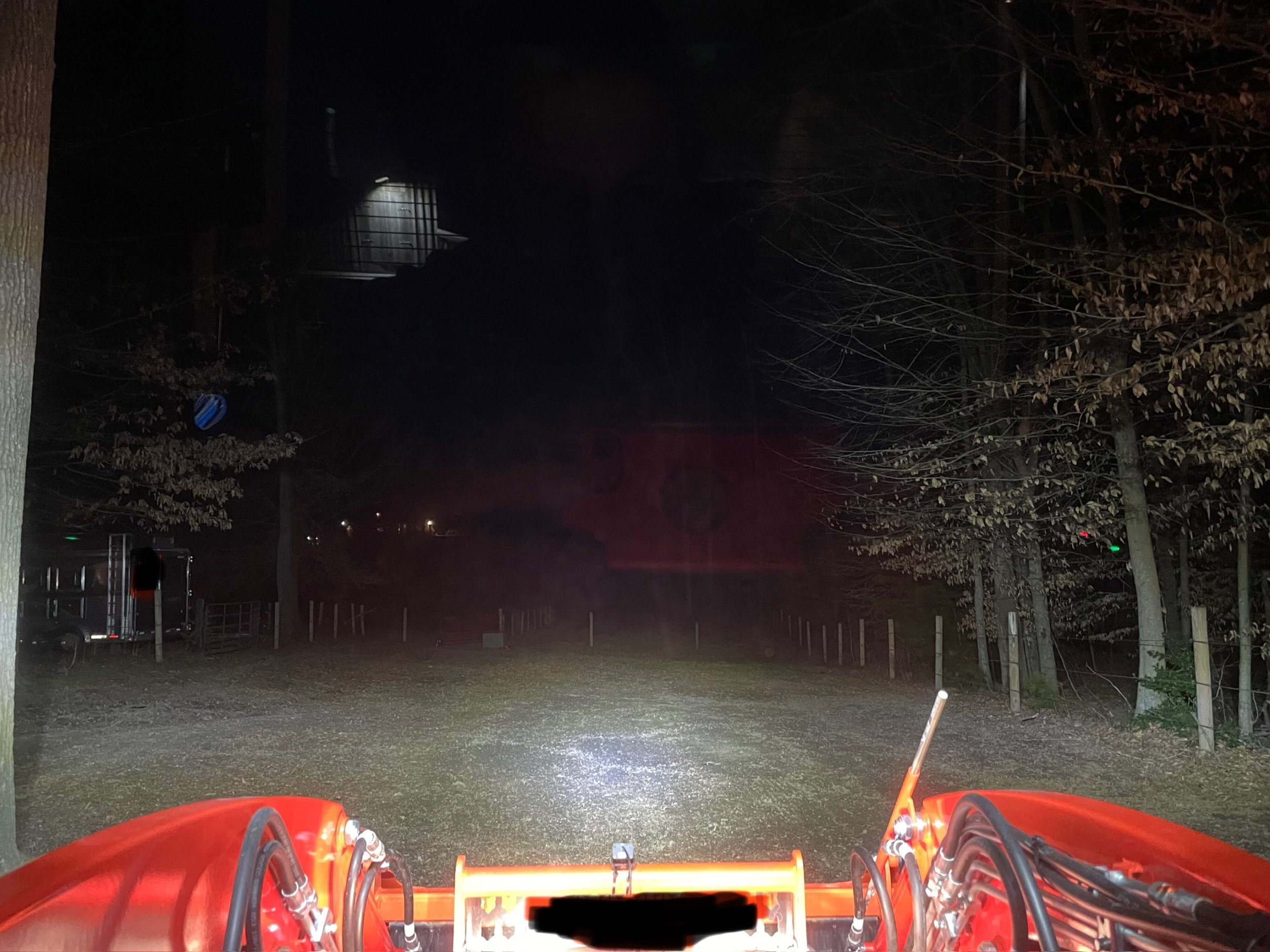

Today , I added a 37” led light bar. A friend came by and I was supposed to put it on his truck but it was 1/2” too big for where he wanted it on the headache rack. Fit pretty good on the tractor.
Nilight 468w

Are those 880 connectors what's on the factory harness so you don't have to splice on the factory wiring?
On the DK, yes. However, if you disassemble the light fixture, there should be 2 spades connectors on the bulb. Either end, you can make a no-splice connection.
