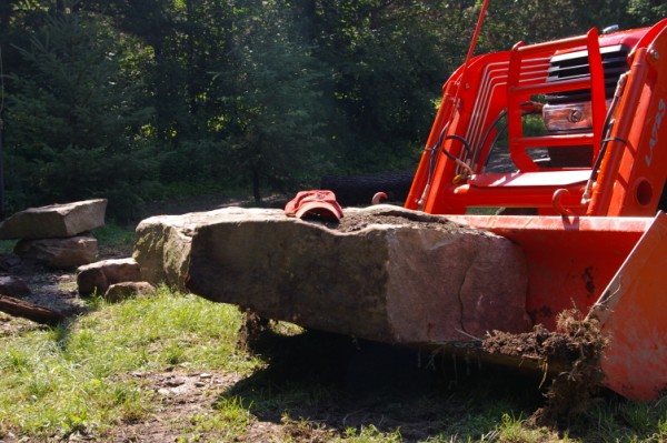

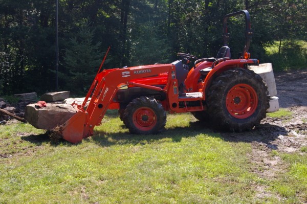

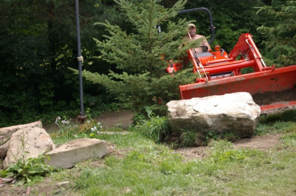

Great images to help explain the effort.
Did you do all of this boulder dig out using the FEL and toothbar?
I did not have a toothbar on our previous tractor, but I do plan to add one when we buy our next tractor. I am so impressed with the toothbar and how significantly it adds to the FEL job list.
Thanks for sharing the images. What's happening in the background? It looks like you have been very busy on the Kubota.
Do you have plans for that boulder? That's about as round a boulder as I have seen unearthed in my many experiences.

Yes, the FEL and toothbar were pretty much all I used .... although I might have used a shovel to shove away some loose dirt on the backside of the boulder once I had it loose so I could get the chain around it. The toothbar was very handy in that it extended the reach of the bucket just enough to get under the boulder and pry it up ... as well as making it possible to dig the ramp down to it.
Re: background - I'm clearing the pad for the new polebarn. Yeah, pretty busy .... I've managed to rack up about 800 hours in the 2 1/2 years that we have had the B2910.
The boulder will eventually be moved someplace on the property and incorporated as a landscaping element ..... not sure where quite yet. It was surprisingly round .... it was a nice find. :D
