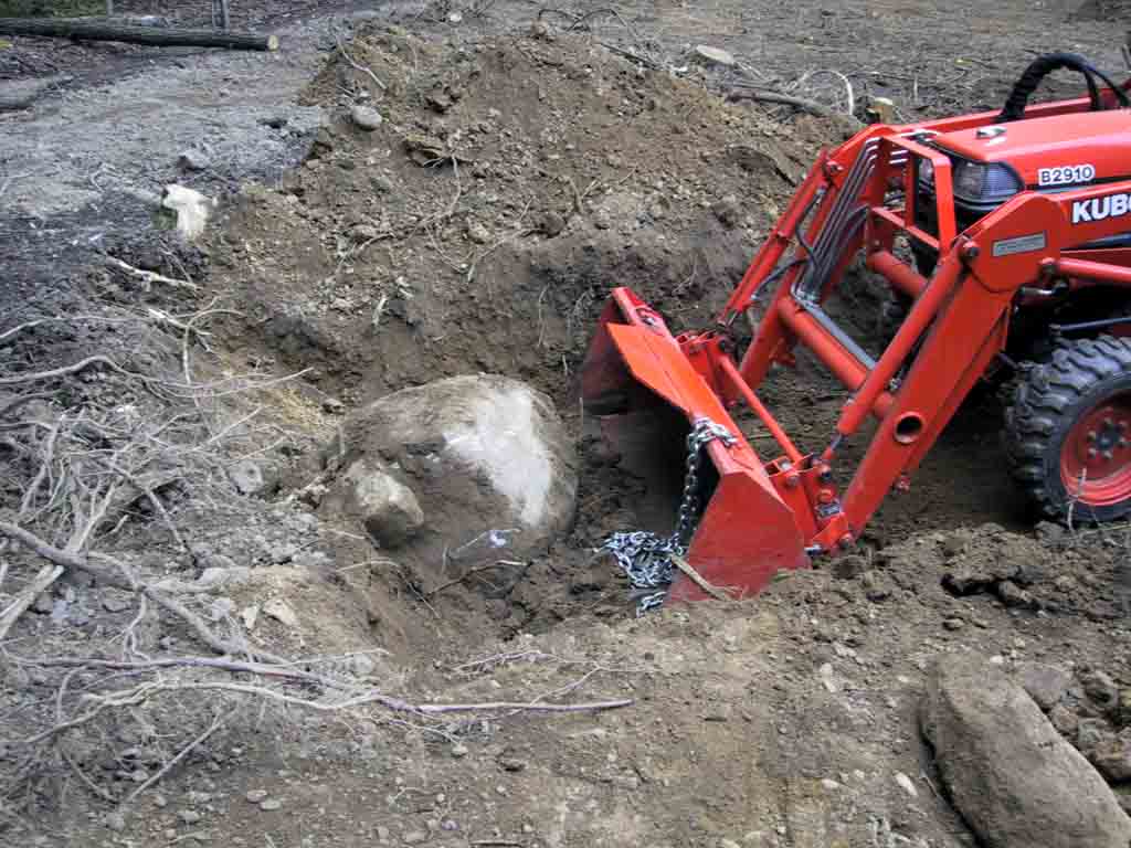

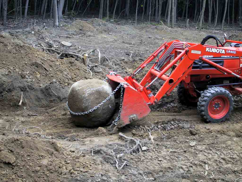

Here's one I dug out with the LA402 on our B2910. Couldn't lift it but I was able to use a chain to drag it up out of the hole and then roll it to where it currently resides. It's granite and was probably 28" or better in diameter.
