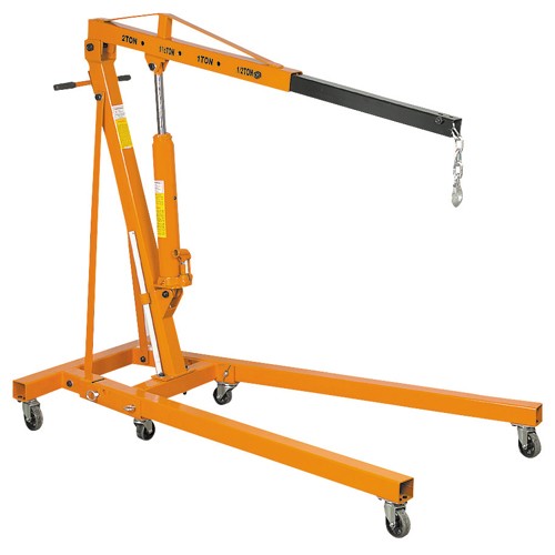

Or I could buy a 2 ton collapsible crane from HF, but I don't have experience with these and don't now how well they work for things like a giant rotary cutter instead of your basic engine block. It also might not slide under the cutter if the cutter "front" (with 3ph hitches) is too close the tractor or a wall.
Or I could buy a better basic hydraulic floor jack (as for a vehicle), though it was really hard to get the old crappy car jack under the side of the rotary cutter (not much clearance on the forward sides, had to position it way back).
So I like the crane type options best.

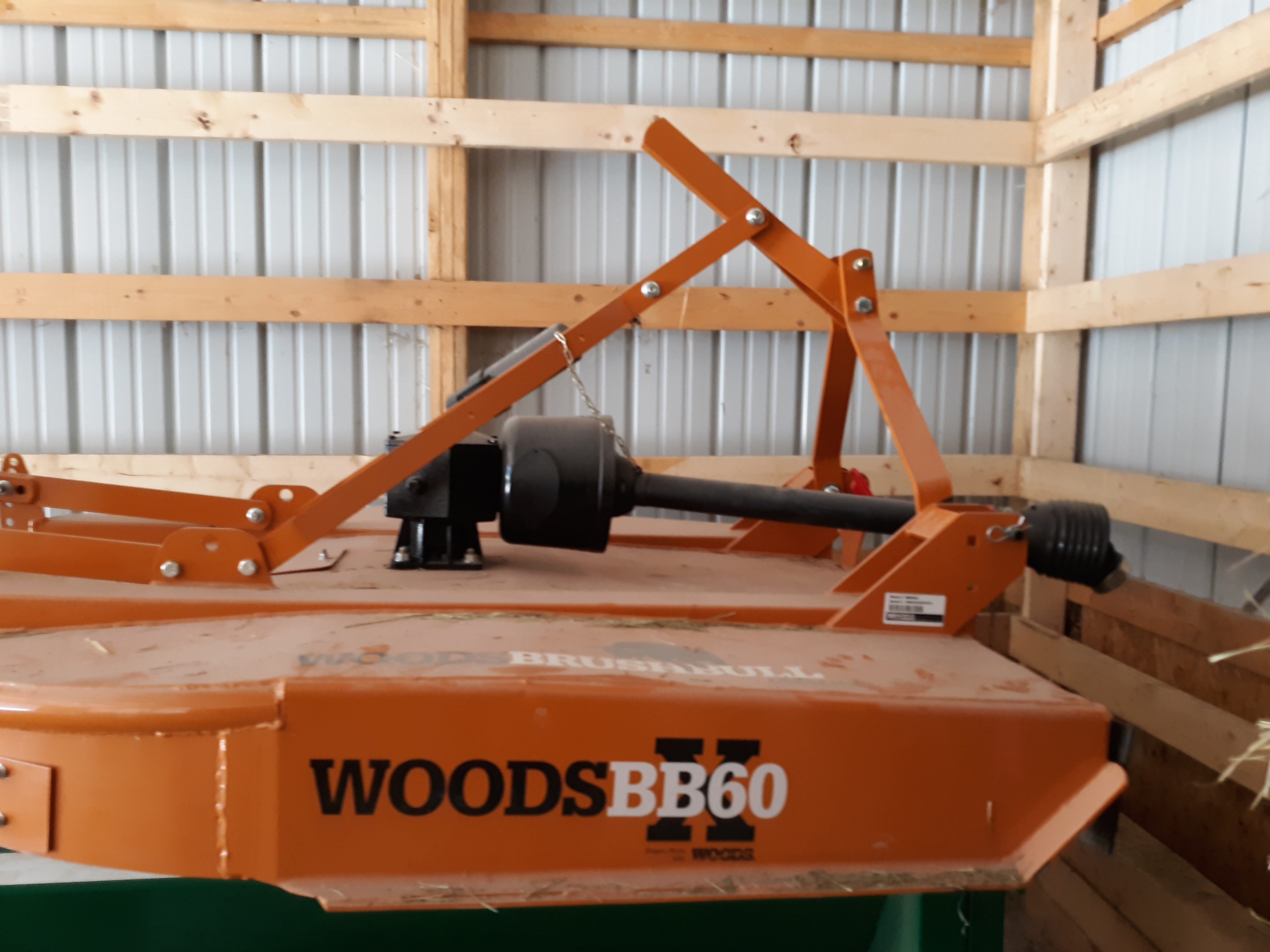

I pickup mine from the side with forks I put chains on the top link and the two brackets on the rear to put it on my trailer for the winter..... woods BB60.jpg

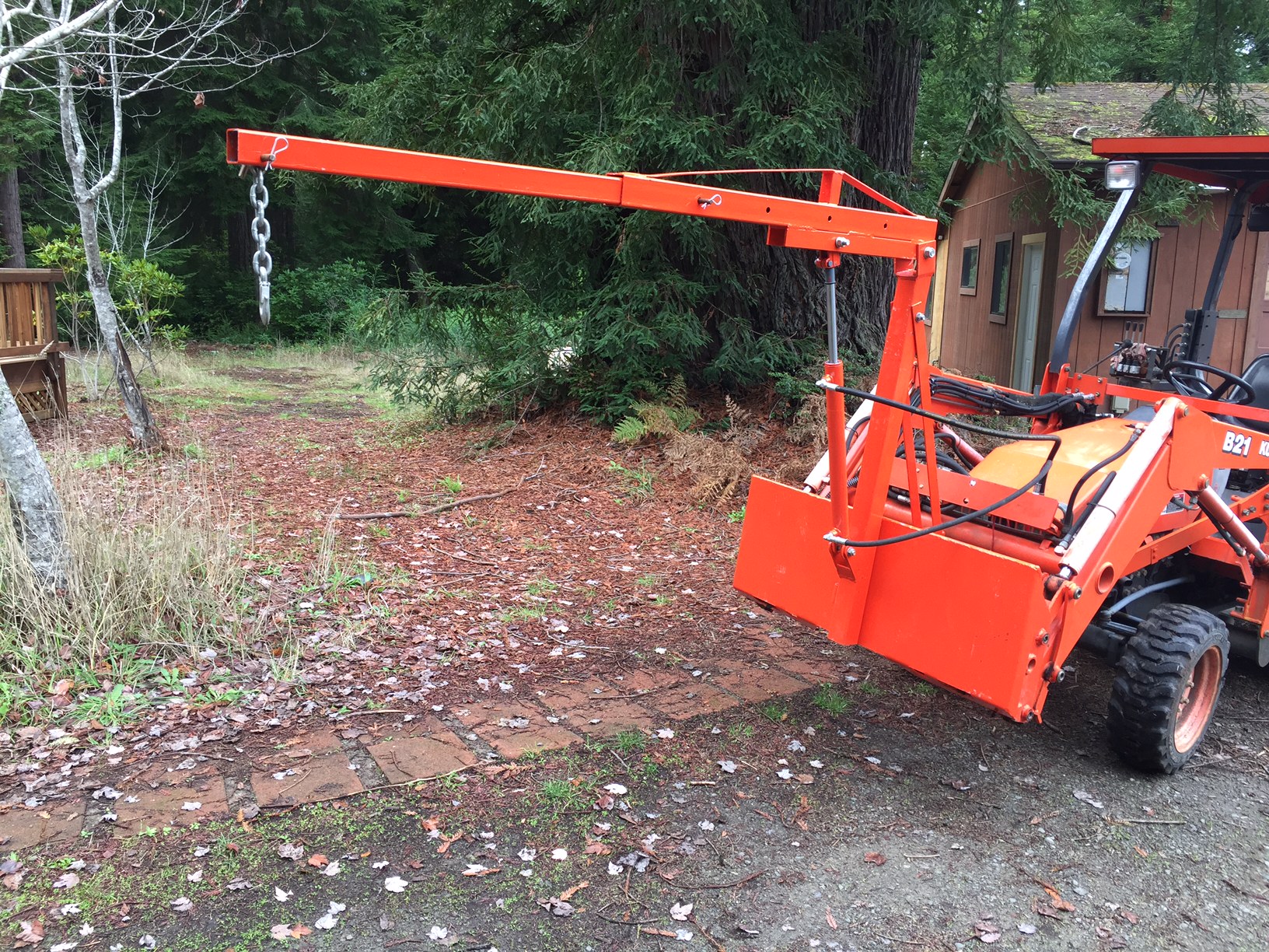

I put my old HF engine hoist on the FEL. As an engine hoist it was just in the way 95% of the time and awkward to use for most stuff because you have to get the legs underneath. As an FEL attachment it is easy to use and I use it frequently. The B21 is low enough to drive into both shop and garage if need be. Having it on the front of the tractor is much easier to position for lifting than on the rear.

The HF crane is the least likely to work. The boom does not extend past the legs so if the mower is on the floor you can't get the legs under it. I have been rebuilding a Bridgeport mill using a HF crane like you mentioned. I ended up putting a pallet on the legs to set the parts on, then wheel it to a point I could get the tractor to, then used the tractor forks to take the pallet off the crane legs.

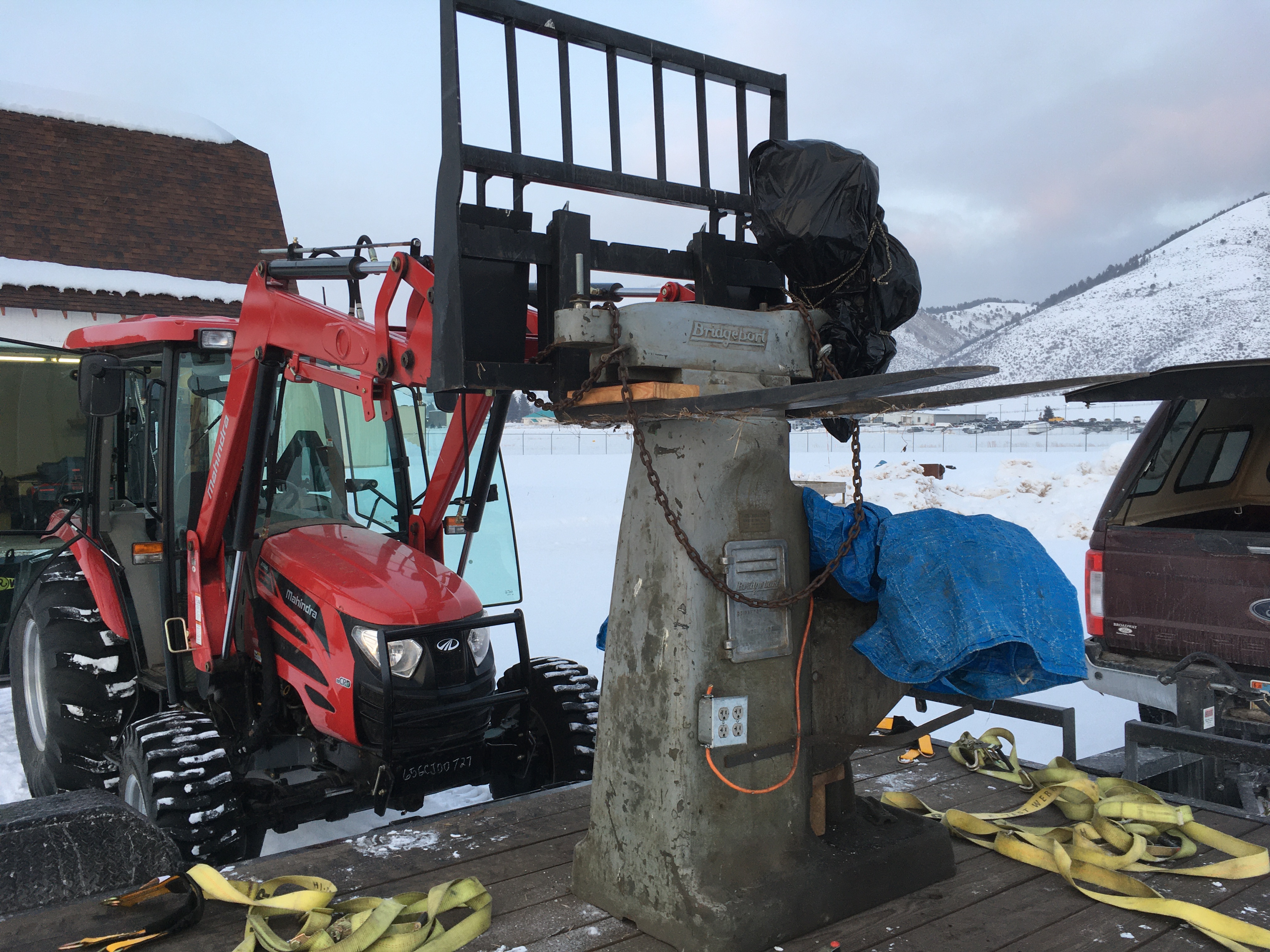

IMG_0327.JPG Notice the two safety chains holding the mill back to the mast.

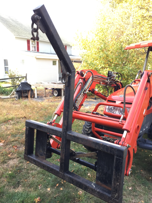

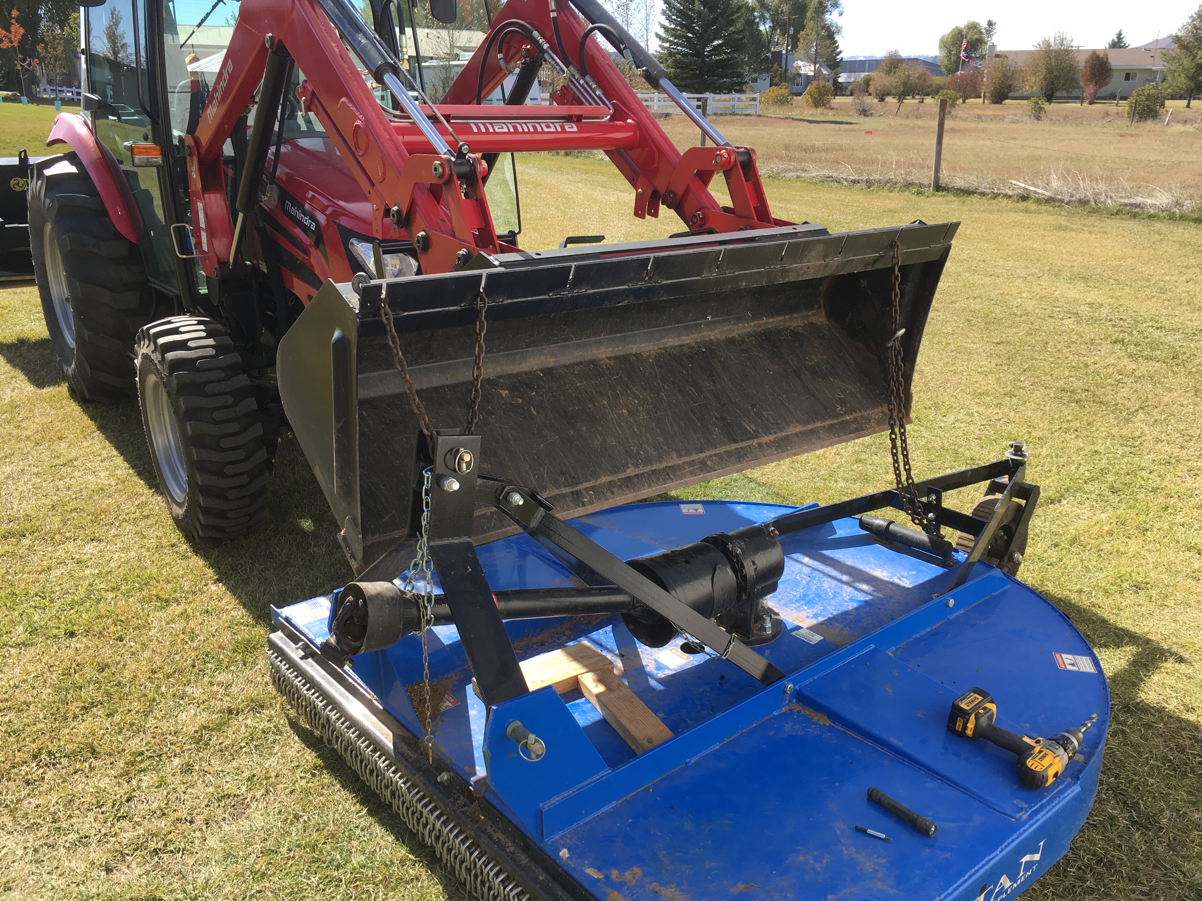

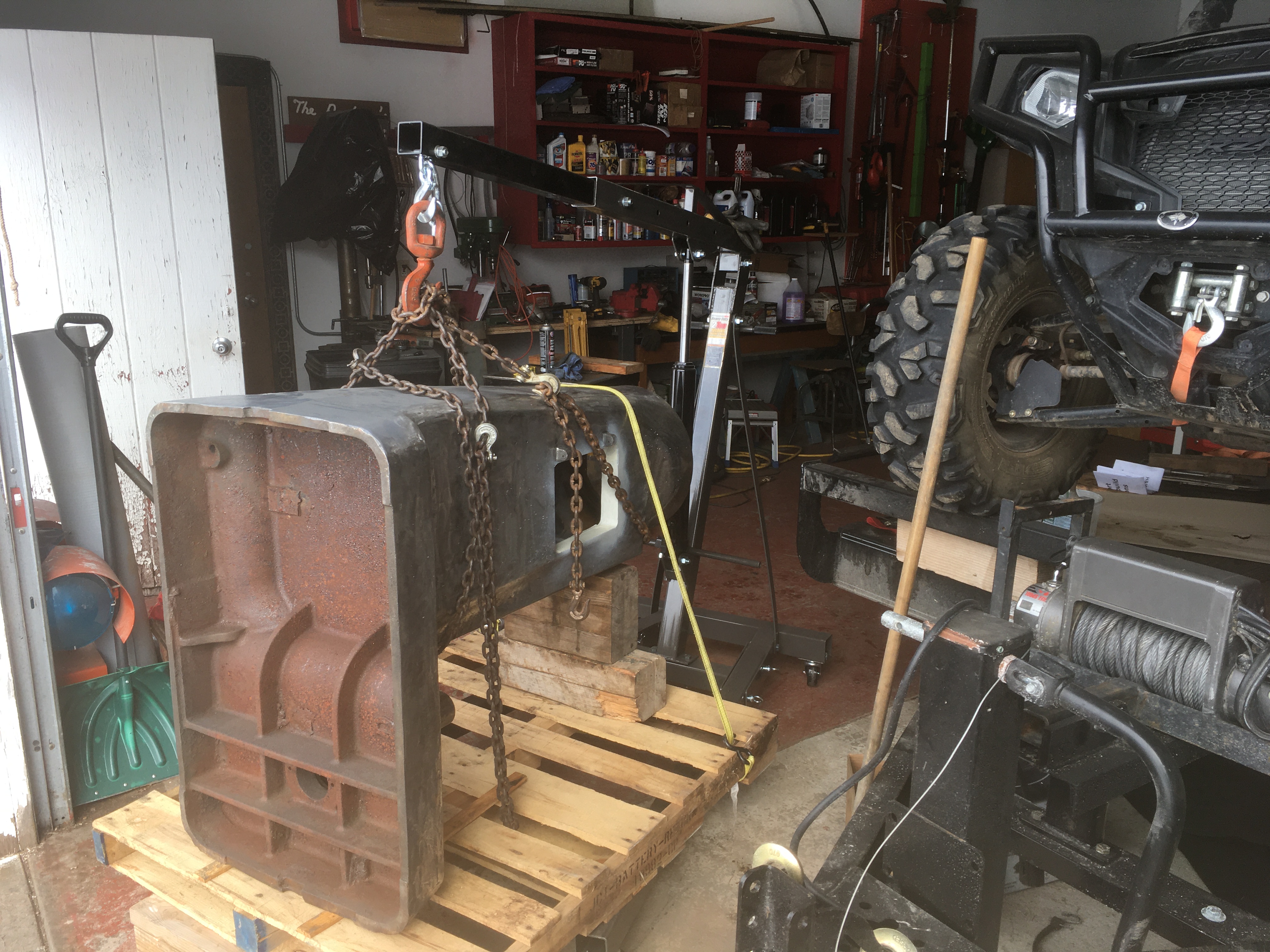

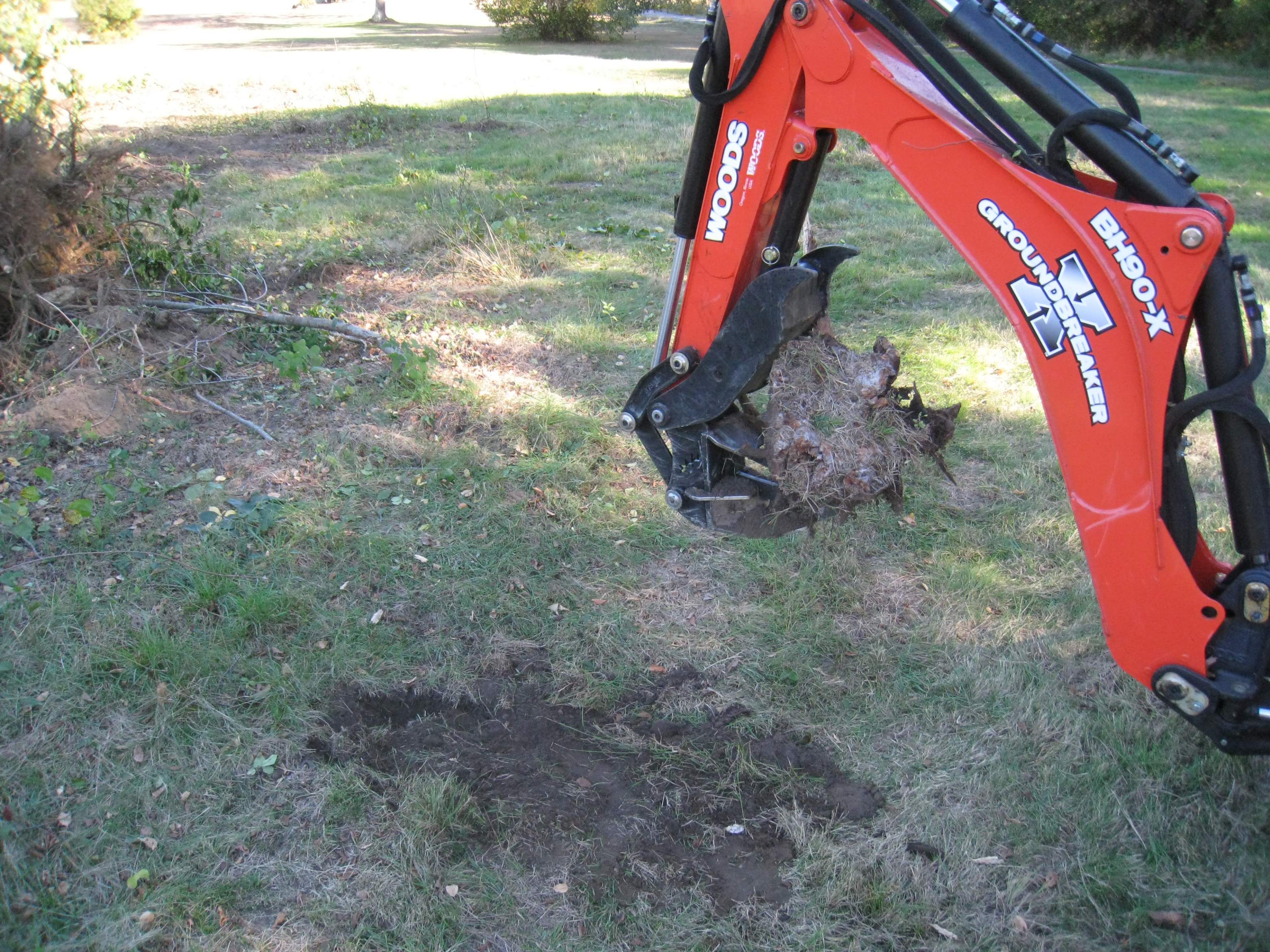

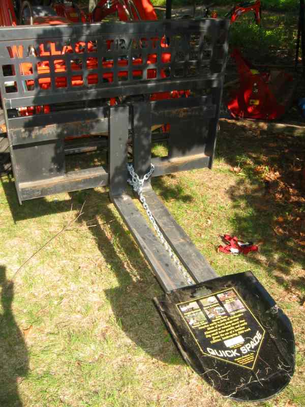

I use either a tree boom, forks or my backhoe in situations like the OP posted. For heavy but smaller items, a HF 2 ton foldable shop crane is handy too.
