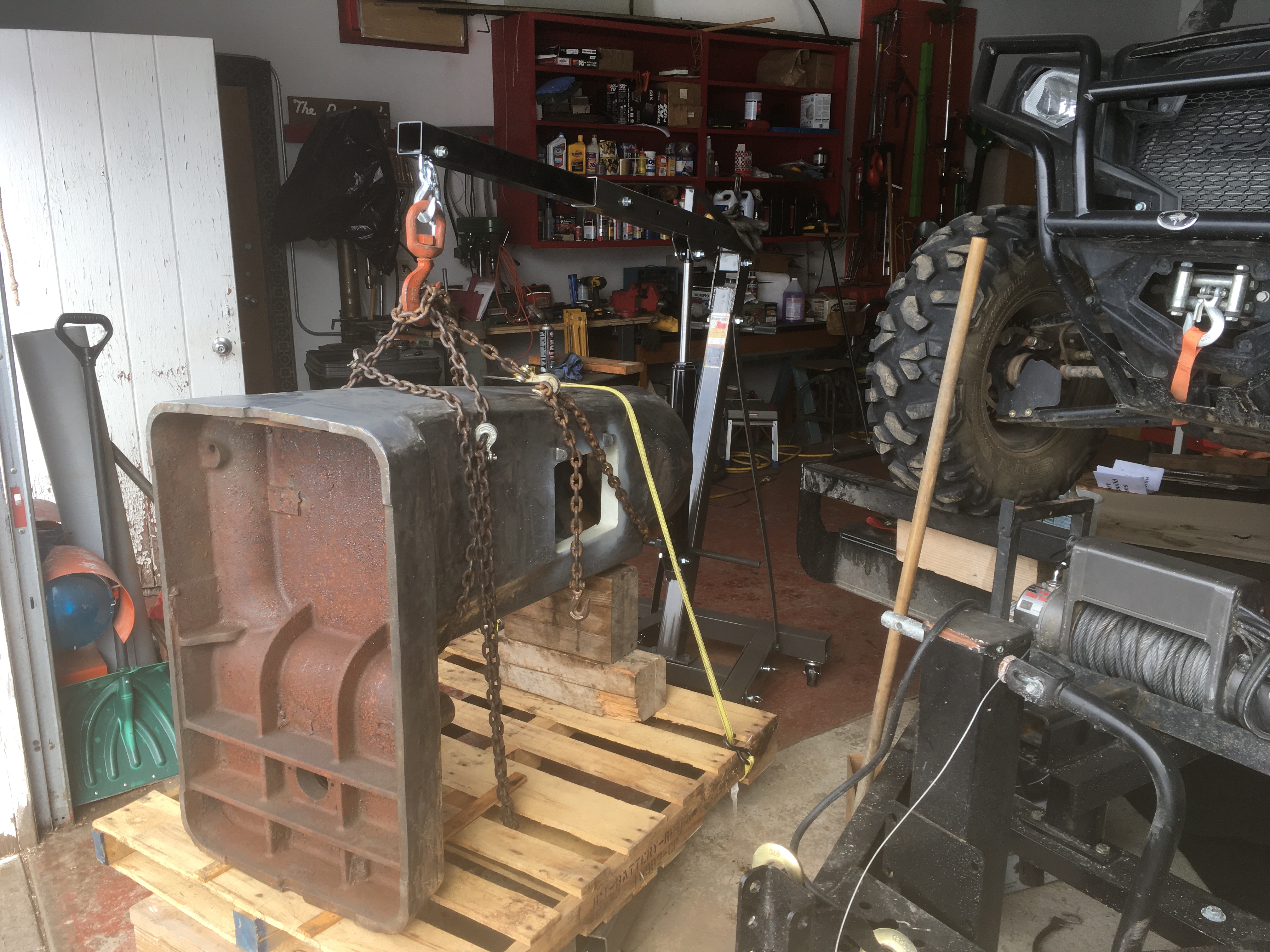

The HF crane is the least likely to work. The boom does not extend past the legs so if the mower is on the floor you can't get the legs under it. I have been rebuilding a Bridgeport mill using a HF crane like you mentioned. I ended up putting a pallet on the legs to set the parts on, then wheel it to a point I could get the tractor to, then used the tractor forks to take the pallet off the crane legs.

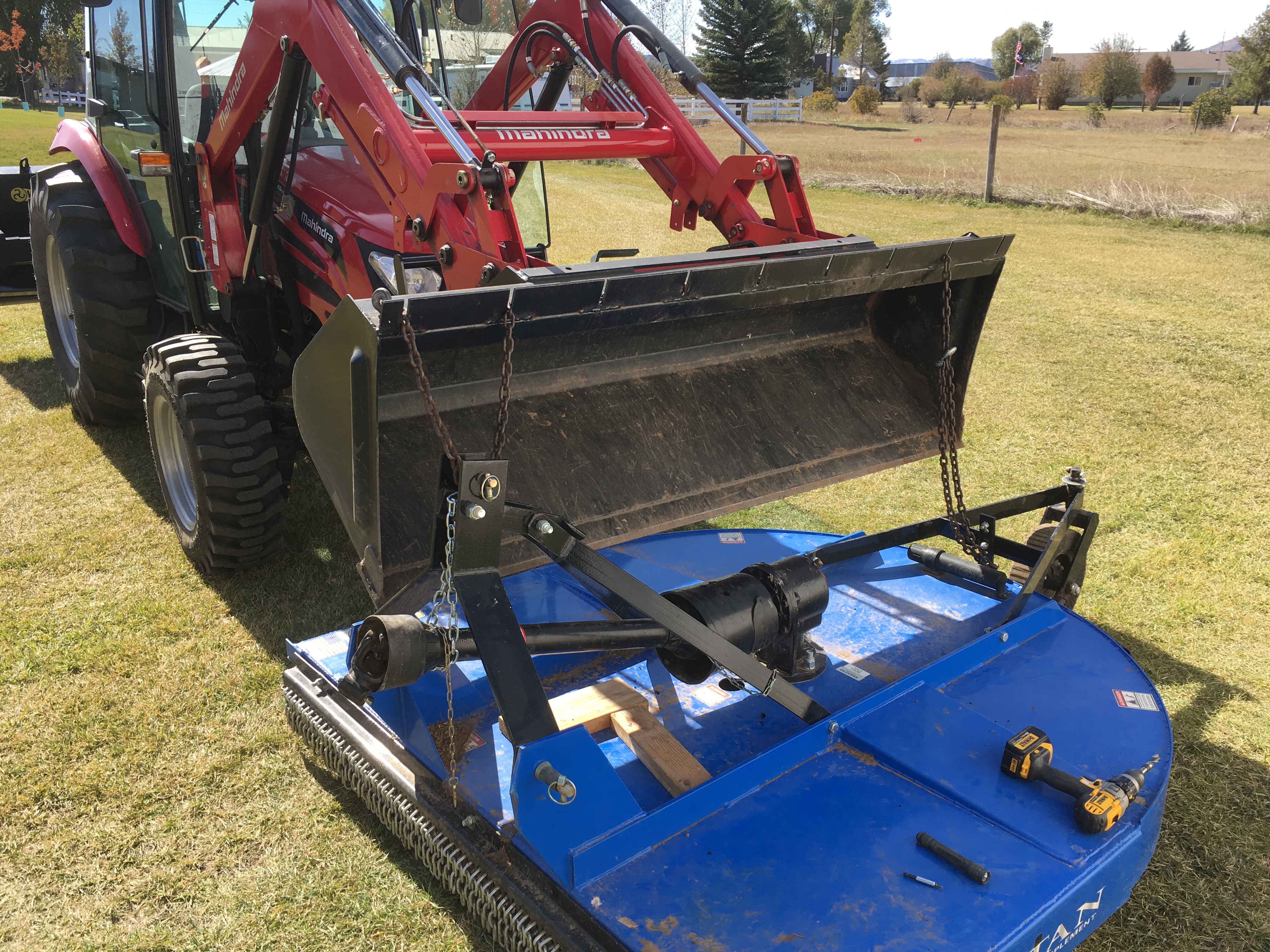

If space allows, using the tractor with forks or bucket works well. You can always weld more hooks on the bucket and beef it up as needed. I use a slotted angle iron which gives me a number of places to hook and beefs up the bucket a bit.
If using my forks to move my mower (no pictures) I just stick one fork in the crotch of the upper 3 point assembly and run a chain off the other fork to the wheel frame work. Practice will help you learn to keep the forks fairly level so things don't slide off but you can run a safety chain to the frame work if needed.

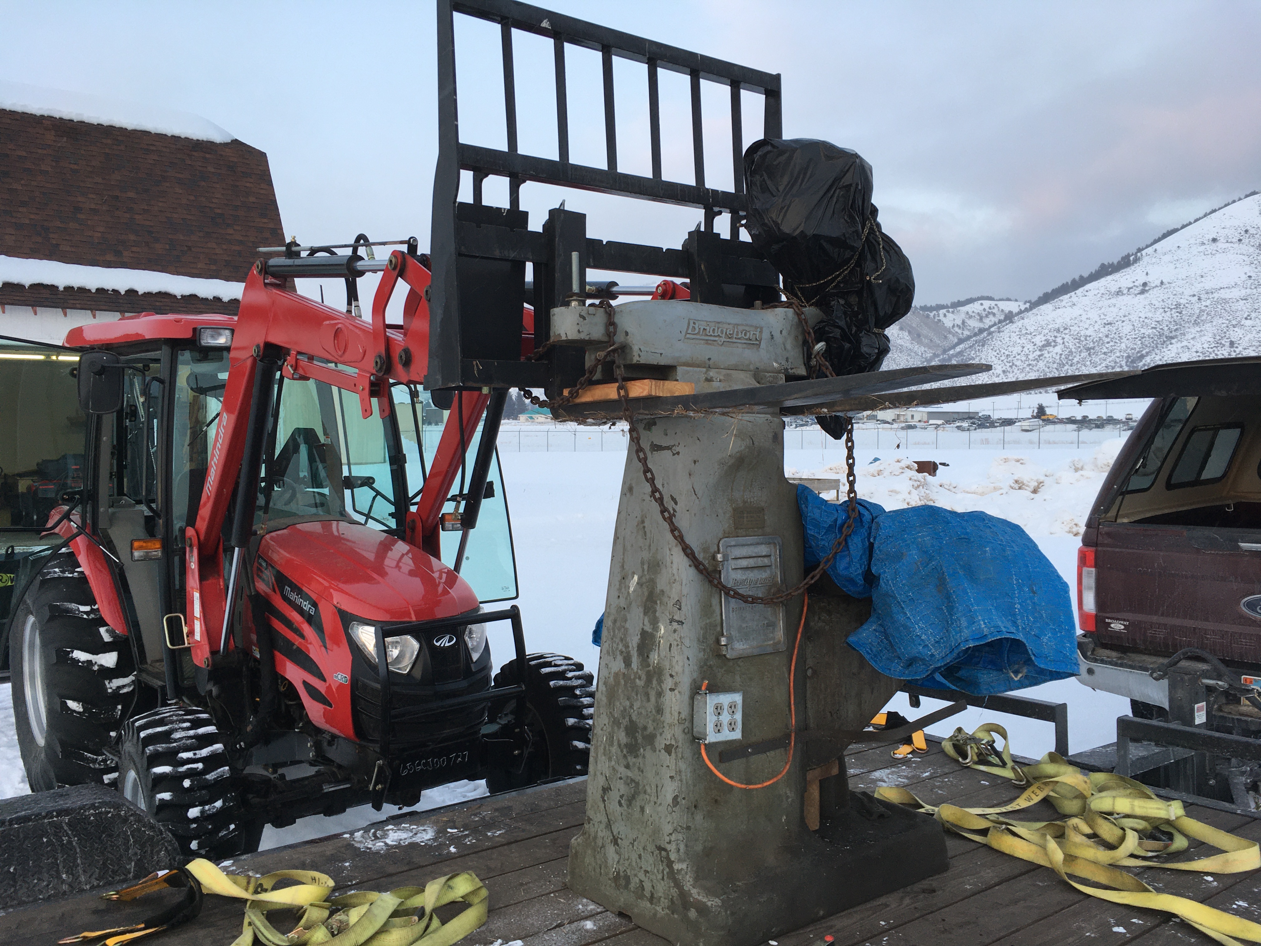

View attachment 652166 Notice the two safety chains holding the mill back to the mast.
