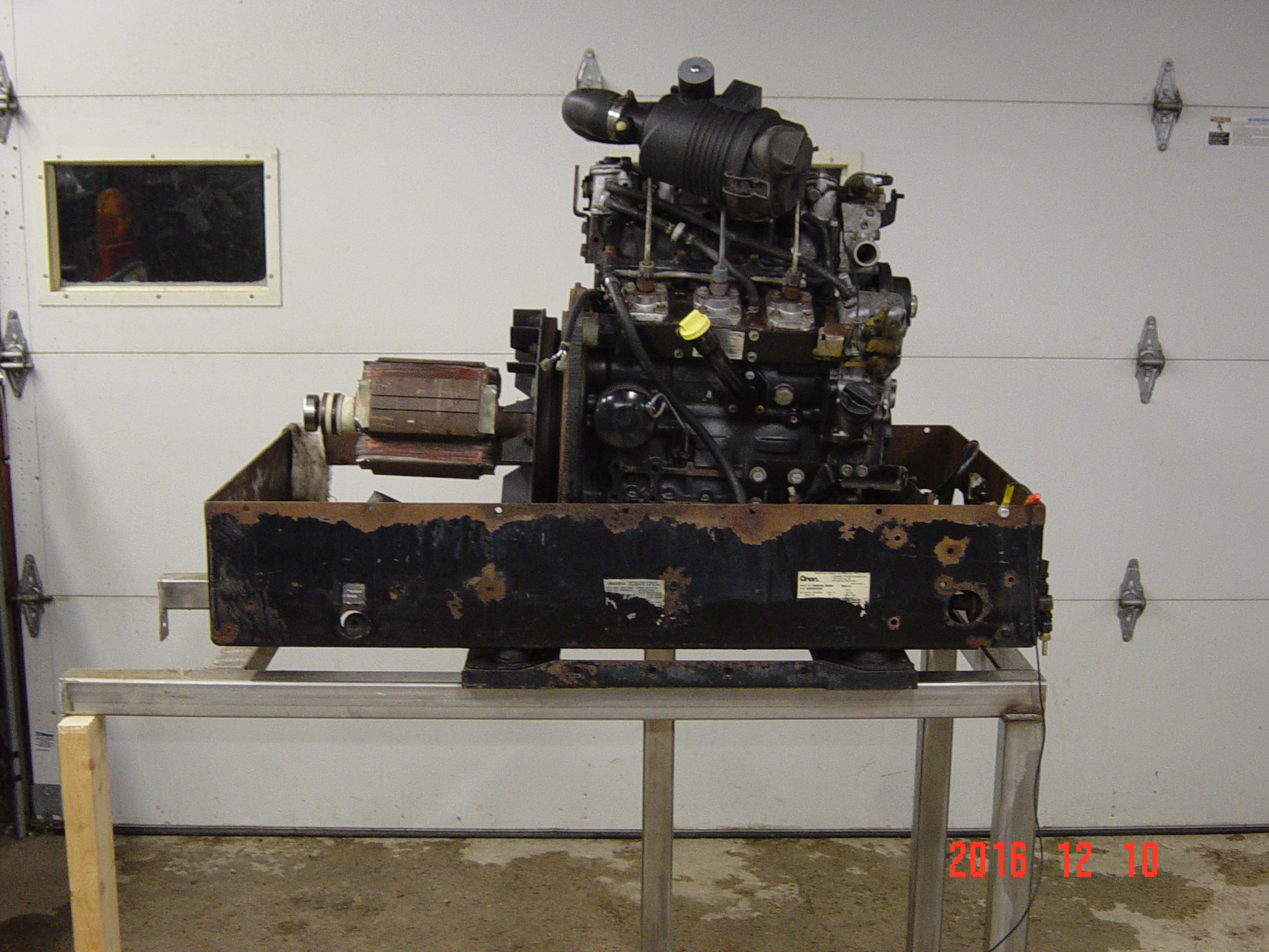

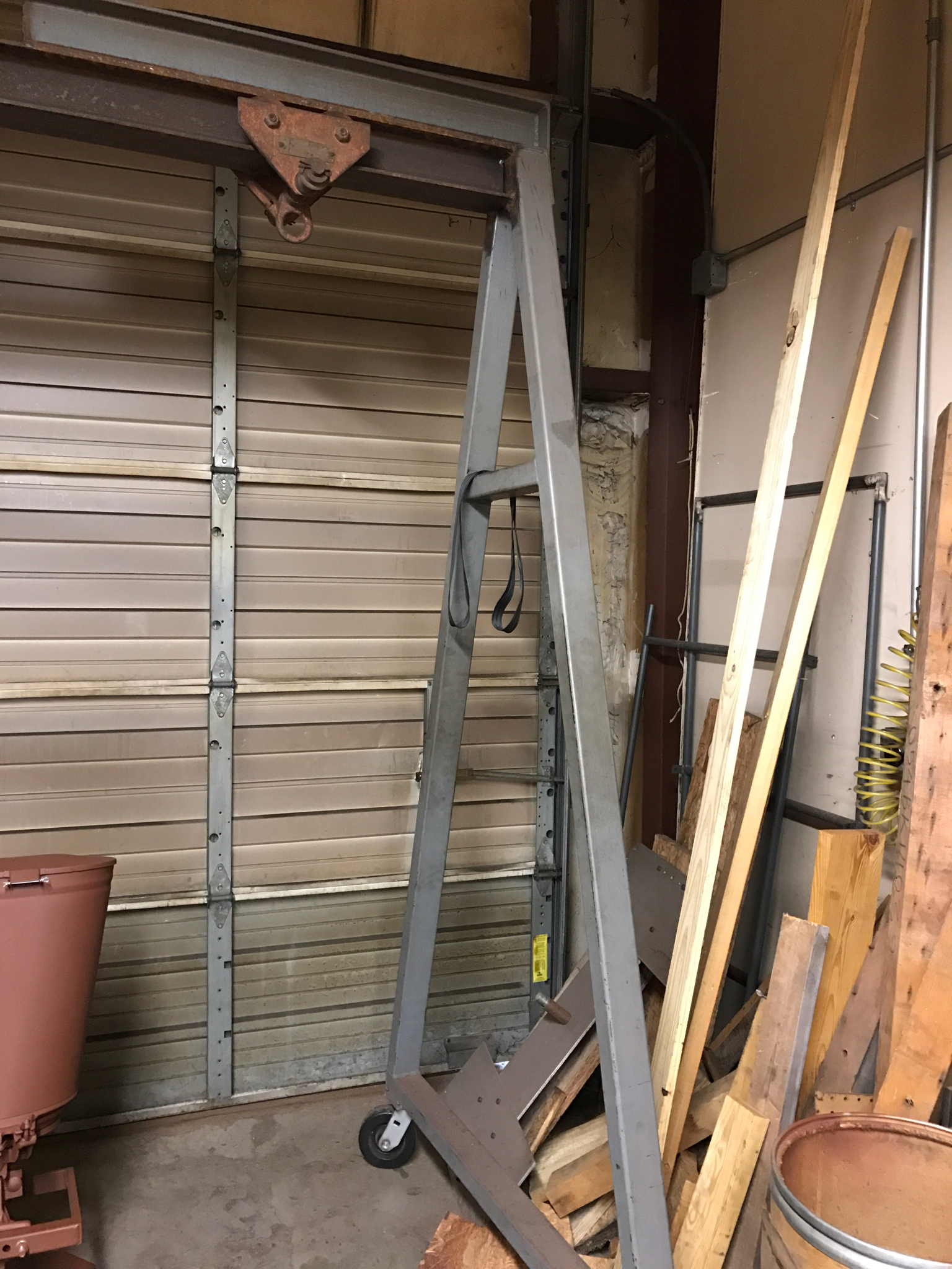

How about a gantry? I made one out of old stuff I had laying around and some donation wheels from my dad. This gray one is one we have at work. It's a tad heavier duty. IMG_3965.JPG

thanks, I've looked at those in the Northern Tools catalog plus at Harbor Freight. About a grand to get something basic, more if all electric.
But what about the thing wobbling around, almost nothing I work on has pick up loops like on my Everything Attachments rake and blade, which pull up perfectly level. Puts a smile on my face when I see it, someone actually placed it intelligently. Good basic engineering.
But my garden tractors don't have them, nor do the mowers. Unless the gantry picks up a self leveling floor of sorts that the equipment sits on.
that will have me thinking for awhile. Thanks

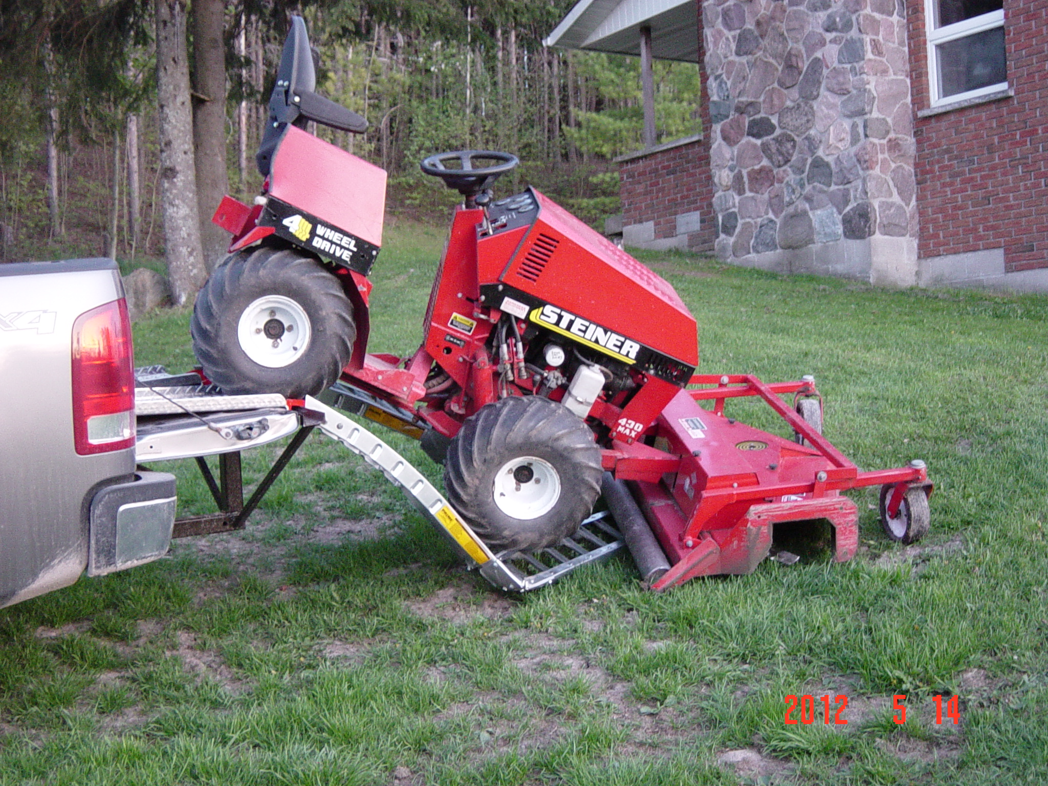

Did youu say Gravely,,, and loader??
Here is my 24G Gravely,, they do not get any heavier,,,
This is the 700 pound mower deck off the 24G

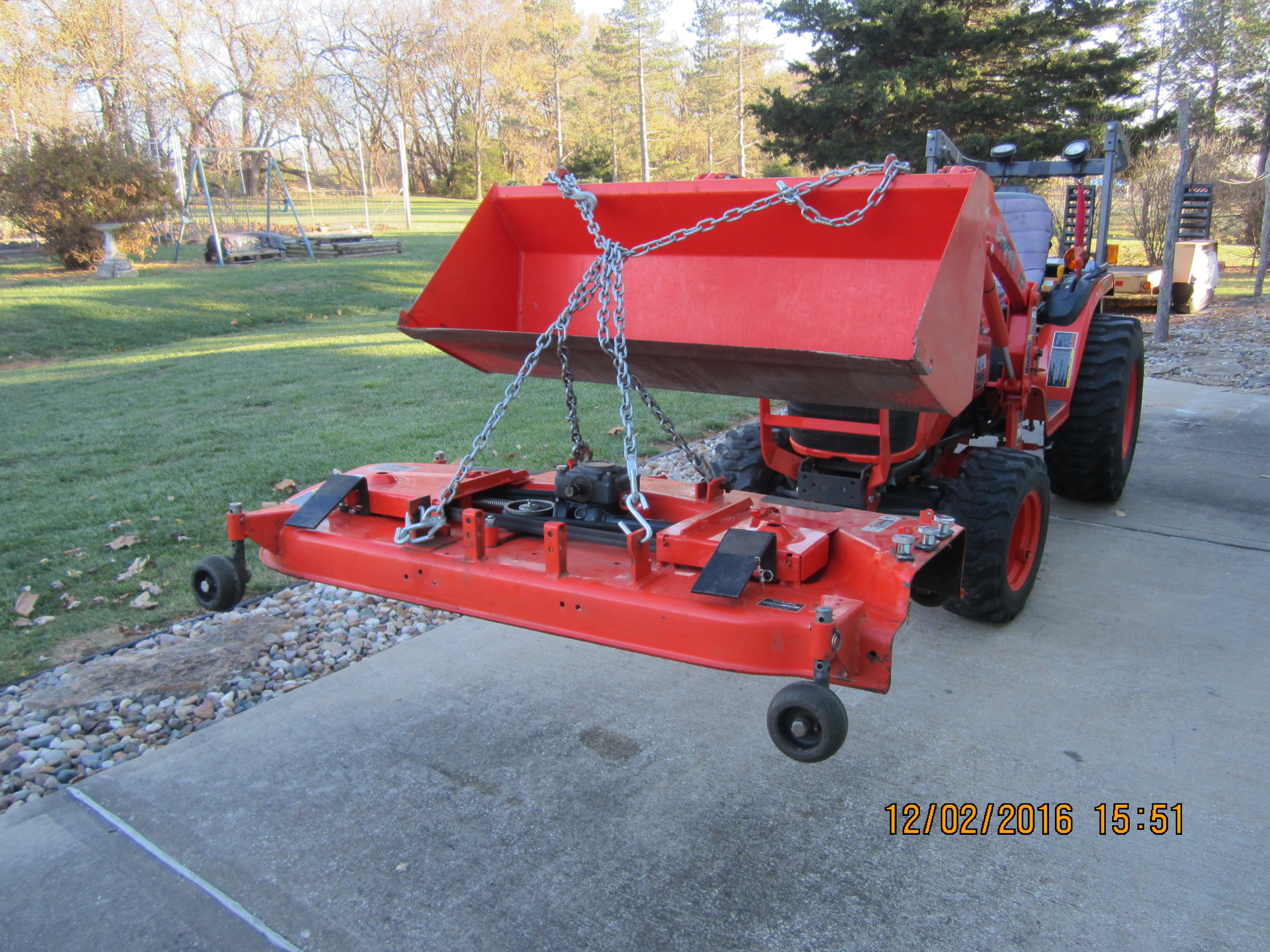

We have an I-beam mounted across above the entryway just inside the barn, with an electric hoist on a roller. I use it for mower maintenance mostly, by using a tow strap to lift the front bumper on the rider, and across the front wheel mounts on the zero-turn.

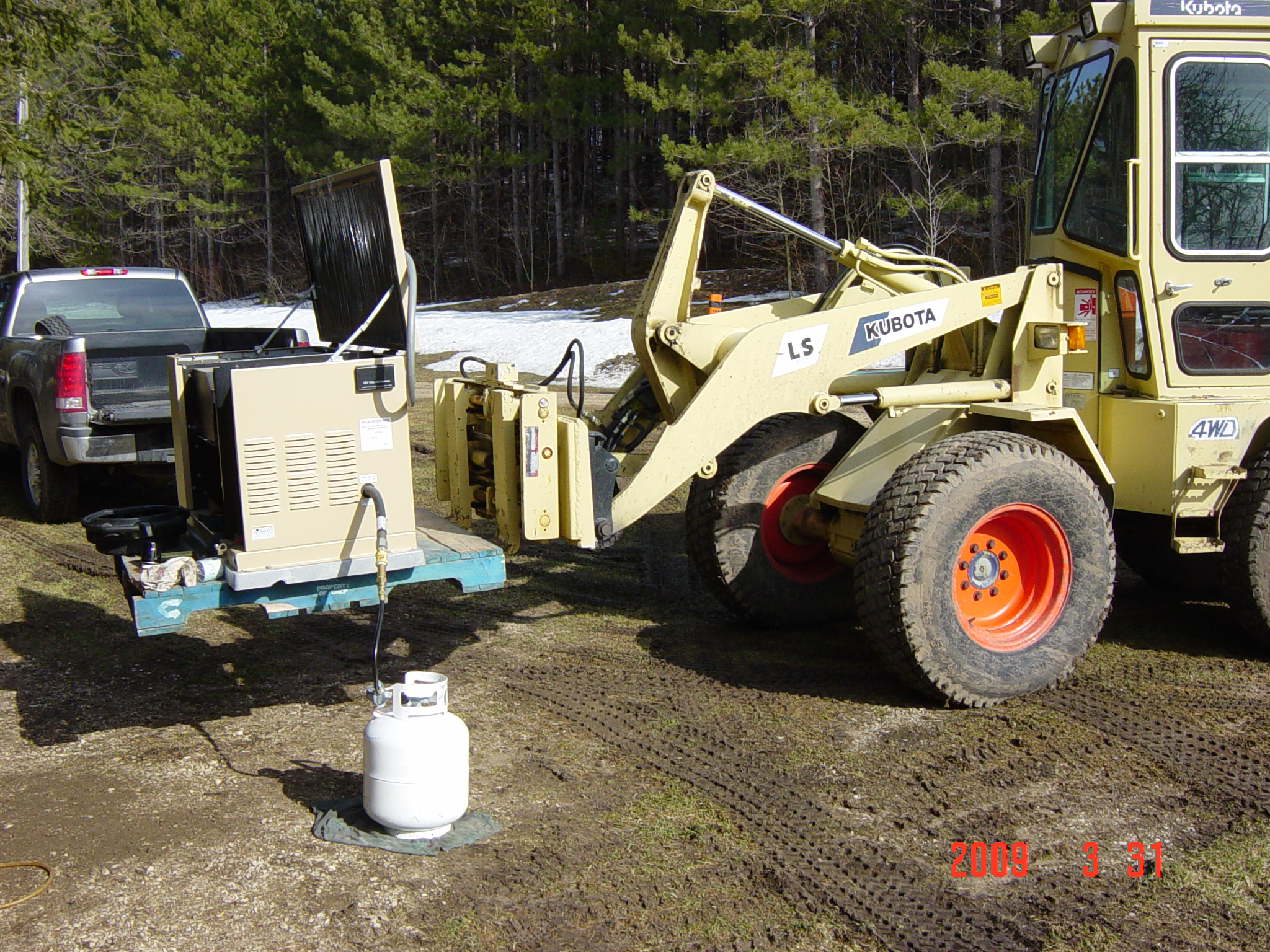

2. With a small walk behind forklift such as Crown Electric Vertical Pallet Jack (otherwise known as a walkie or stacker) and pallets that fit your equipment
I lean toward the forklift because of the other things you can use it for, but to each their own.

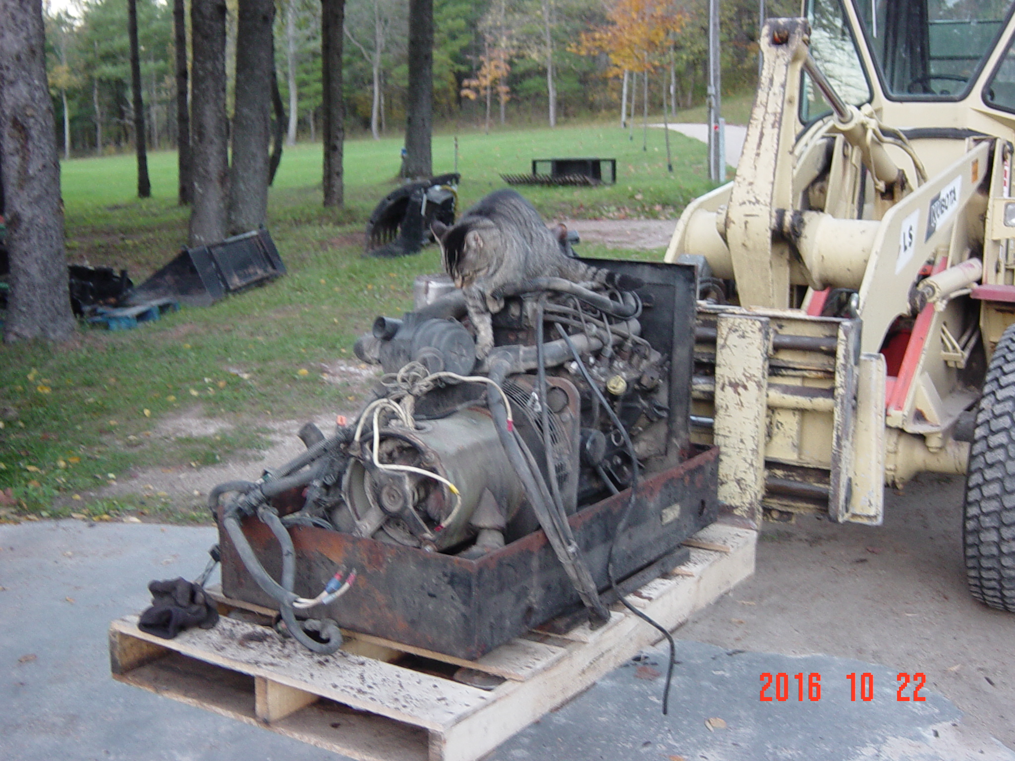

I use a loader for lifting things I don't have to get under. Or on a pallet and I can adjust height to suit. Yes, it sucks to get old.
I also put things on small pallet racking that has been bolted up tight. Or any frame good and strong.

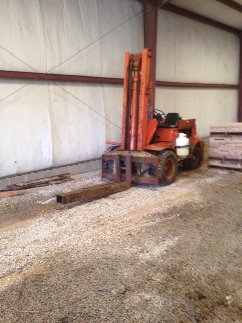

If I had a nice enclosed storage building with a concrete floor, Aaron I'd be chasing after that forklift. In between the barn and the concrete floored implement shed is gravel...not good for hard little wheels.
Now if a Hyster fell of a truck at the end of the lane...
what does a ratty but useful propane forklift truck cost?

$500-3000 depending on the truck. For your uses, I would look for a 2000# capacity truck with dual pneumatic wheels (NOT solid rubber tires), something like this, but smaller:

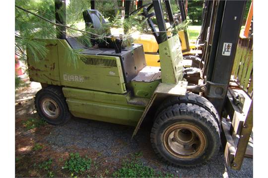

This is the only forklift I have that has air filed tires. I think we paid 700 for it knowing the motor was full of water. It ended up costing about $1000-1500 to get it running and convert to propane. This has far the widest turning radius, but it's the only one semi off road capable. By that I mean gravels and firm dirt. The yellow one gets stuck when one of the 4 wheels rolls of concrete. The Cat goes ok unloaded on gravels and firm dirt. Loaded and all bets are off. IMG_8043.JPG I think my other one was about $1500 IMG_7824.JPG The nicest one and the best deal is the Cat which was a hard worked ( not ) TVA machine. It's a 1980s machine but it has always been kept indoors and only has 900 hours. Paid $1500 for it and spent $500 converting it to propane. The orange one only has a double stack mast which is a big negative in my opinion. It's too tall. This isn't my actual machine but it's pretty similar.

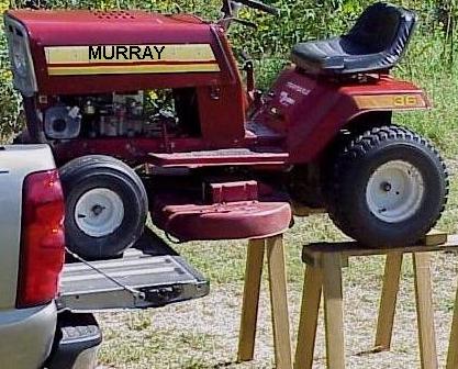

I've put the lawn tractor up on the level for years.

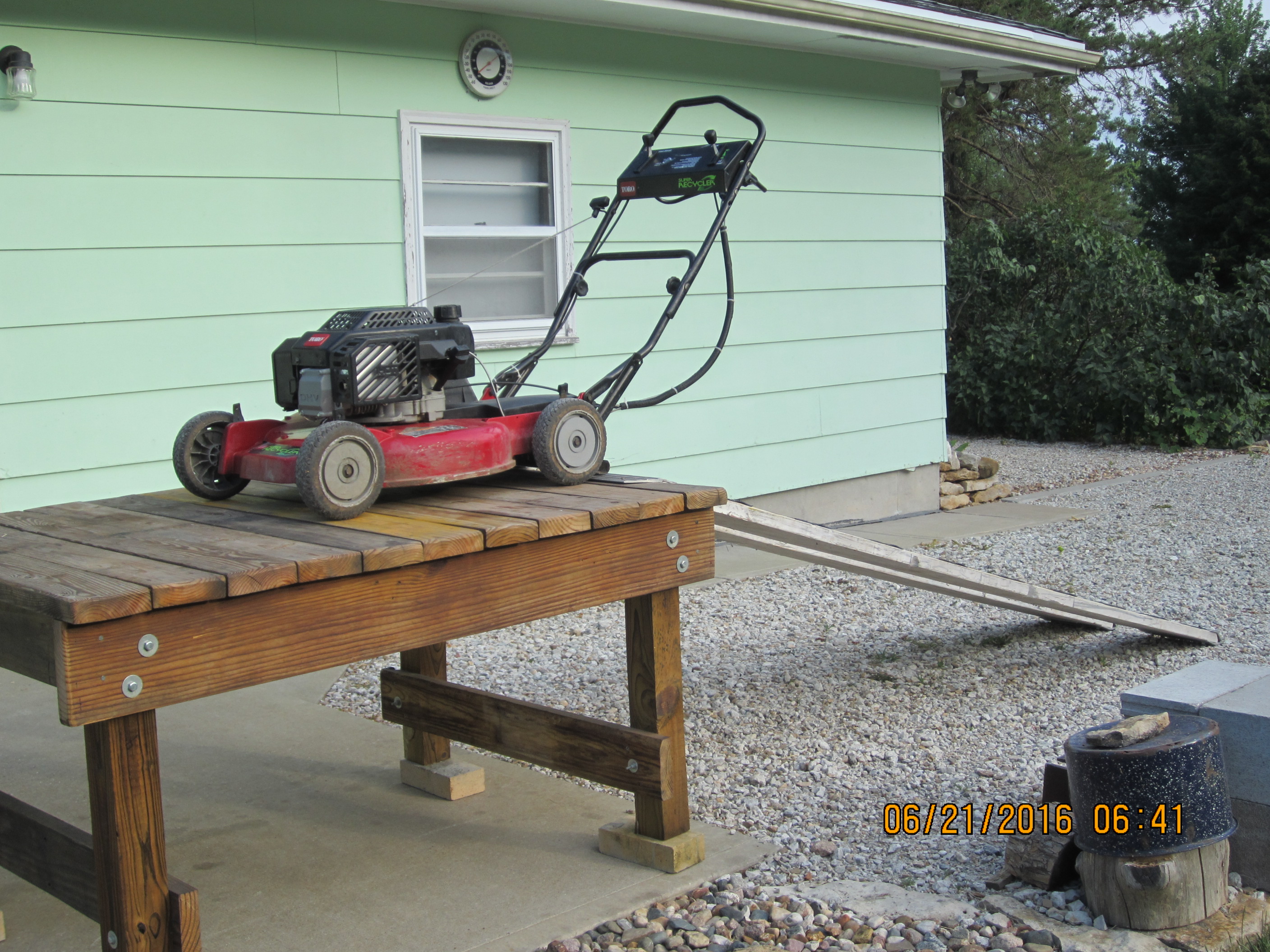

/ Lifting Equipment safely #18
