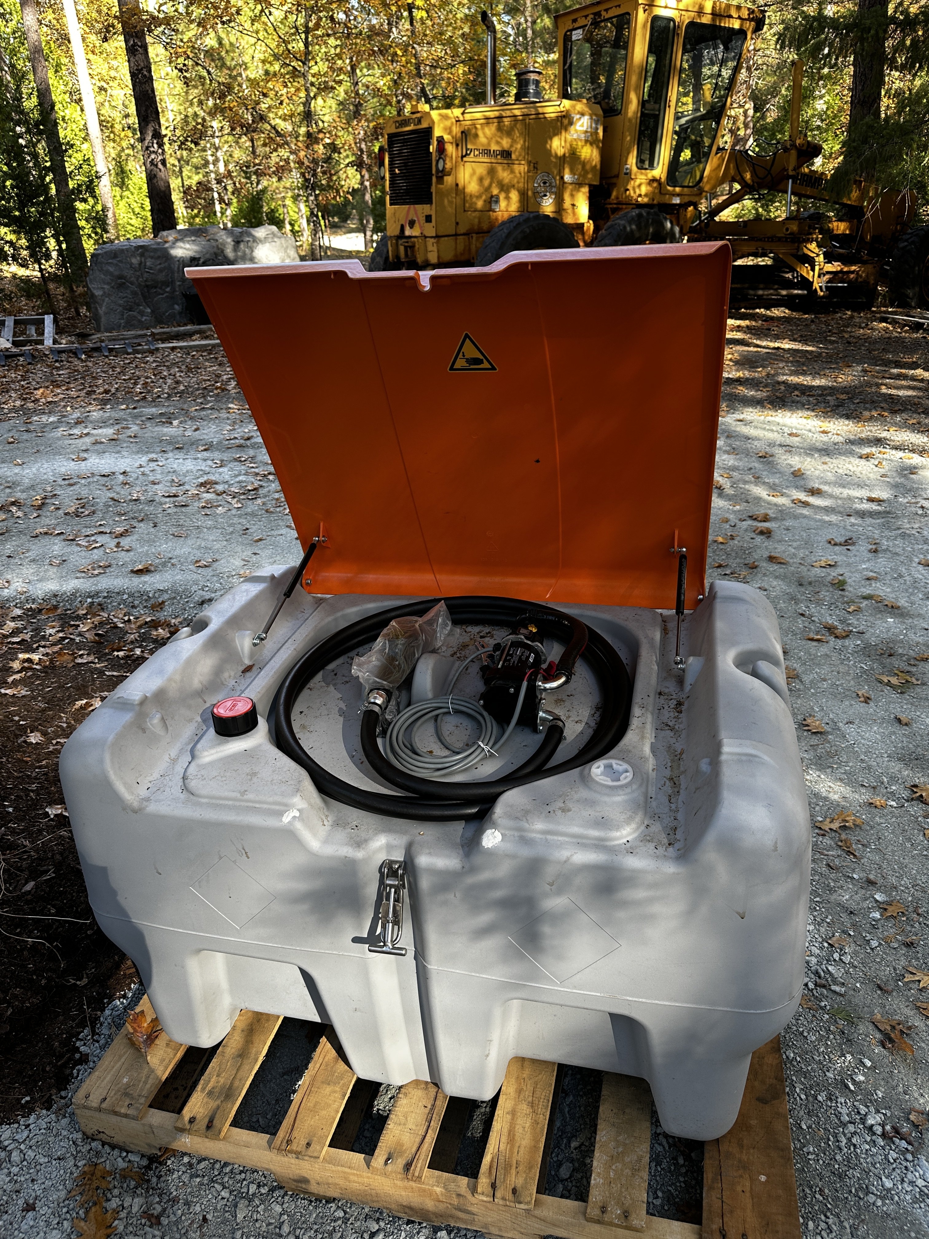

Personally I don't use that much gasoline in cans.
For diesel, my little Ford has about a 5 gallon tank that will keep me moving for about a month or so, perhaps even more. So, a 5 gallon can works well.
My "new to me" CAT probably has a 50 gallon tank. It is a pain to climb up on the tracks and fill the tank. When I was refilling the hydraulic oil, I tied myself to the cab before dumping the bucket. It would be so nice to get a large pickup tank and just drive up to it and start pumping diesel. Plus, I might be able to find off road diesel that would save the fuel taxes. However, it is probably only a short term need, so no need to get a 1000 gallon fixed tank and delivery service.
Go to Harbor Freight and get yourself a couple battery operated transfer pumps, they run on 2 D cell batteries and cost about 12 bucks each. I keep at least 2 in the shop at all times and I run them on Li-Ion D cells from Amazon though HF sells them as well as the chargers. I keep a couple charged up all the time on the shelf just if I need them.
They pump hydraulic oil just fine and gasoline and diesel (if need be as well). They poop out after a wile, usually last me a couple years and I toss them and get a new one. Much less than anything on Amazon btw. They put them on sale every once in a while for like 9 bucks each.

I would NEVER pump gasoline into a tank in the bed of a truck. It is a VERY DANGEROUS action to take.
Could you post a link to an article or news story detailing where this was an issue? I haven't been able to find any. Usually when a particular action is very dangerous, it's not hard to find a story about someone being injured or killed because of that action.

I have often used the gas tank in a vehicle to transport fuel. I connect a hose to the fuel pressure test port, put the other end of my hose where I want the fuel, then start the engine.
No lifting or extra containers.
Just stop soon enough you can make it back to a station for a refill.
That sounds interesting...
Do all gasoline engine vehicles have this test port? Do you have a valve on the discharge to start and stop the flow? Inquiring minds need to know.

I tapped off my service van 34 gallon tank to fill my generator...
I use those now, they don't seem to last me long though. I use them for both diesel and gasoline, and I may get 6-8 months out of them, maybe 50 gallons, 5 gal at a time if I'm lucky. They seem to leak fuel between the top and bottom, and then die rapidly after that. Probably had 6 in 3 years, all die the same way. They work, but the life span is frustrating!
   / Is there a safe way to pump gasoline into a plastic tank in the bed of a truck? #49
Try tightening the top where the batteries go to where the tube is real tight. As cheap as they are even I don't expect them to last very long. I get maybe a year of two out of them myself. About 1/3rd the price of the cheapest one on Amazonian.
All of them do not but many do and it can be added to others.
Most often they are a schrader valve. Open when connected, off when disconnected. Like the valve in your tires.
It is most likely on the feed line in the engine bay.
Something like this.
