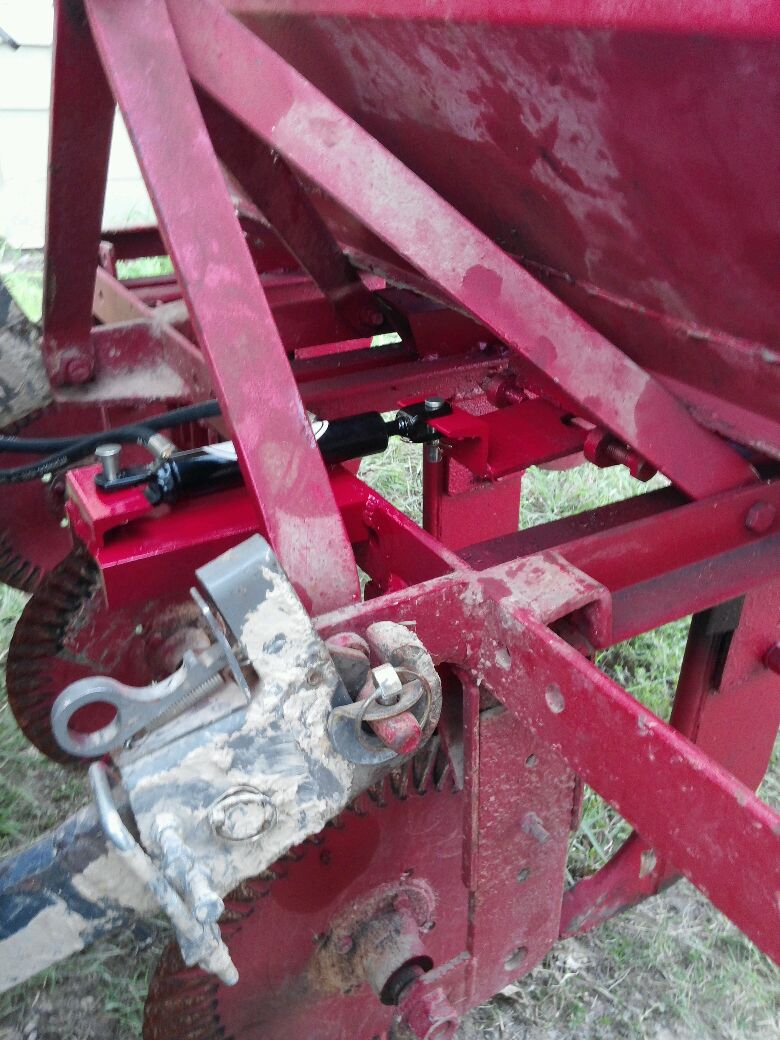

/ lift arms too short? #12
`Put the washers on the lift pins and put a Lynch Pin thru the washer hole to keep the PATS from sliding off the lift pins.
Turn the washer opposite of the picture so pin will snap completely shut on the washer

/ lift arms too short? #13
#14
Yes I got that part, I have 6 linch pin washers and 4 flat washers. So, what do I do with the common flat washers?
/ lift arms too short? #15
I have no idea... thought at first they might be to take up slack on long pins? But you'd hate that because they'd always be sitting in the middle so the Pat's wouldn't work... i'd add them to my washer stock.
#16
Goood idea.
Thats what I think I will do.
