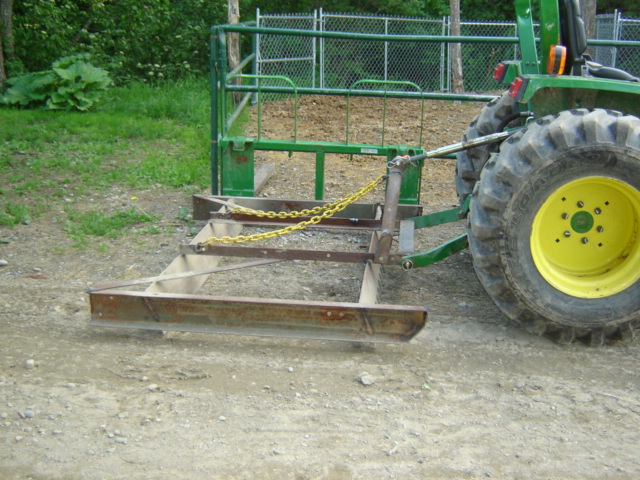

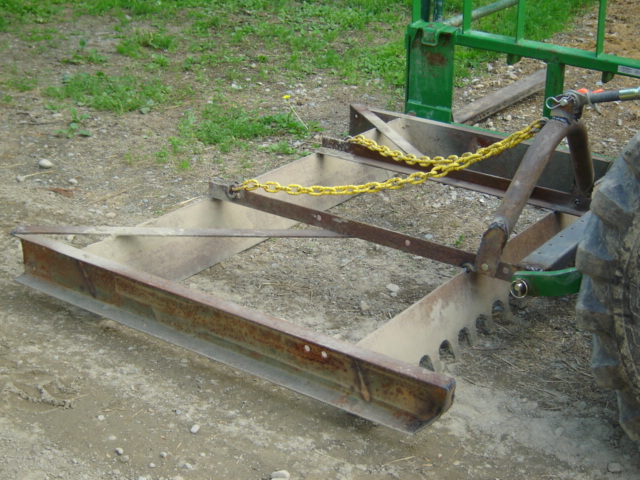

After trying a number of attachments to level and smooth my 1/4 mile+ driveway I Built something that works better than all of the factory ones including a rock rake, bow blade, grader blade and chain drag. I designed it by looking at several factory versions and a little of my own input. It works very well although I have to stop and pick the rocks out every now and again. If I let too many rocks build up inside they tend to roll under the blade leaving ridges. All the steel was scrap I had on hand. Total Investment to build it was $13.00.

It is 6' wide, and I guess it is a box blade. It is 5' long which makes it ride over the holes and fills them in much better than my factory box blade. The front blade is cut out with teeth every 4" so it breaks up the gravel so the second blade can level it out. The chain allows me to lift it and have it float when it is down so both blades do their job.
I pull it with a 95 John Deere 790. I own a small family farm and the 790 has turned out to be a super tractor for us. It replaced a Massey Fergusen, which was a good tractor but I didn't like the dealer.

It weighs about 500 lbs. The angles for the 3 point connection are designed to hold a 2' square concrete block that I have that weighs an adittional 300 lbs. I have not put on the additional weight, mostly because I felt it was not needed.
I atually considered buying the DR grader until I looked at it. The teeth on the front blade are 1/2" square bar stock and I felt they would bend too easily. It might be OK if you didn't have many rocks but I dont think it would stand up to my use. It looked like it should be behind a lawn tractor.

At 500lbs and with your design it should work really well as a road grader. Like you said, you don't need to add that concrete. Especially if you got your road somewhat where you want it already and are now maintaining to keep it smooth and groomed. The skids are the magic ingredient, I presume. Where weight really makes a big difference is like on a boxblade or rear blade since they don't have those skids on the sides, and you're trying to establish the road.

Your implement looks very similar to what we call a Bionic Blade here in Louisiana. A Bionic blade has two grader blades mounted in between skids that are about 4-5' in length. These implements are great for leveling driveways and for leveling property. They will scalp off high spots and deposit into low spots as the implement rides on the skids. Once you have used one, you wonder how you ever did without one.

apparatus looks interesting. Im needing to the same thing. used blades, scrapers, etc, nothing works well with my 1" clean gravel, 1/4 mile drive. Question, what is the front bar, made from? the rear bar has a pitch inward. what is that slope from vertical? does the gravel uniformily flow over the rear sloped blade?

drrelaxx, you probably don't realize that this is a very old thread so tessiers may not see it. To me his front blade looks like it might be a piece cut from a serrated cutting edge for a road grader. There are lots of discussion and plans for those type impliments on here. do a search on 'landplane' in the thread title to find them.
