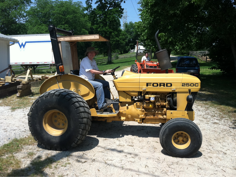

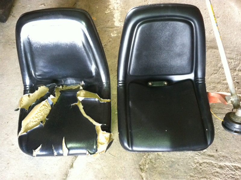

Here are some weekend photos:
1. New seat! Yeah!
2/3. They had a 55' lift at the farm, so I got some shots from a different angle.
4. The Ford, the wooden sun shade that has been on it forever had the wires snap and bonked me on the head 15 min after the photo was taken.

Nice pics...the two center pics look like they were taken from a height. Were you in an aircraft or something?
BTW, were you wearing your seatbelt? If you have a ROPS, you should wear the seatbelt (now that's one thing I am **** about!)
