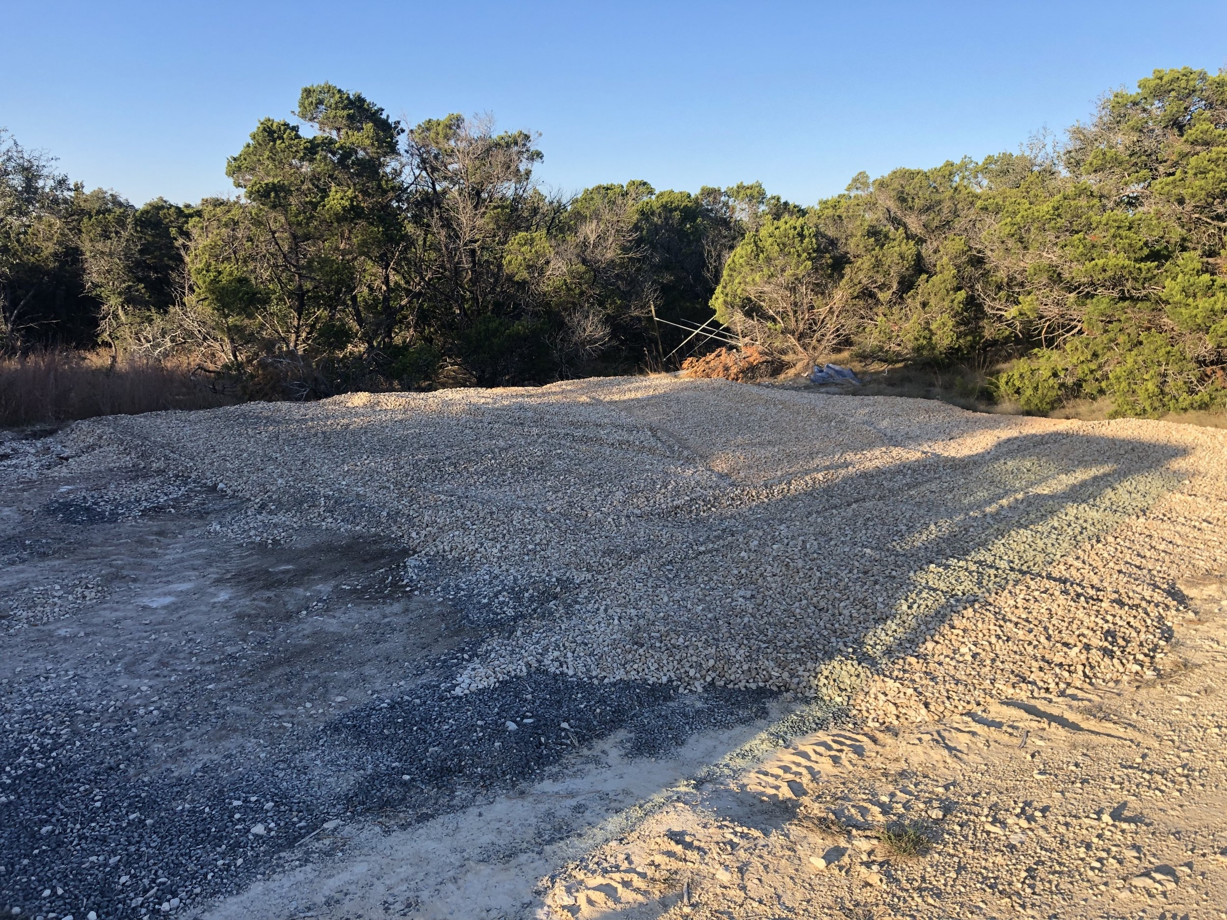

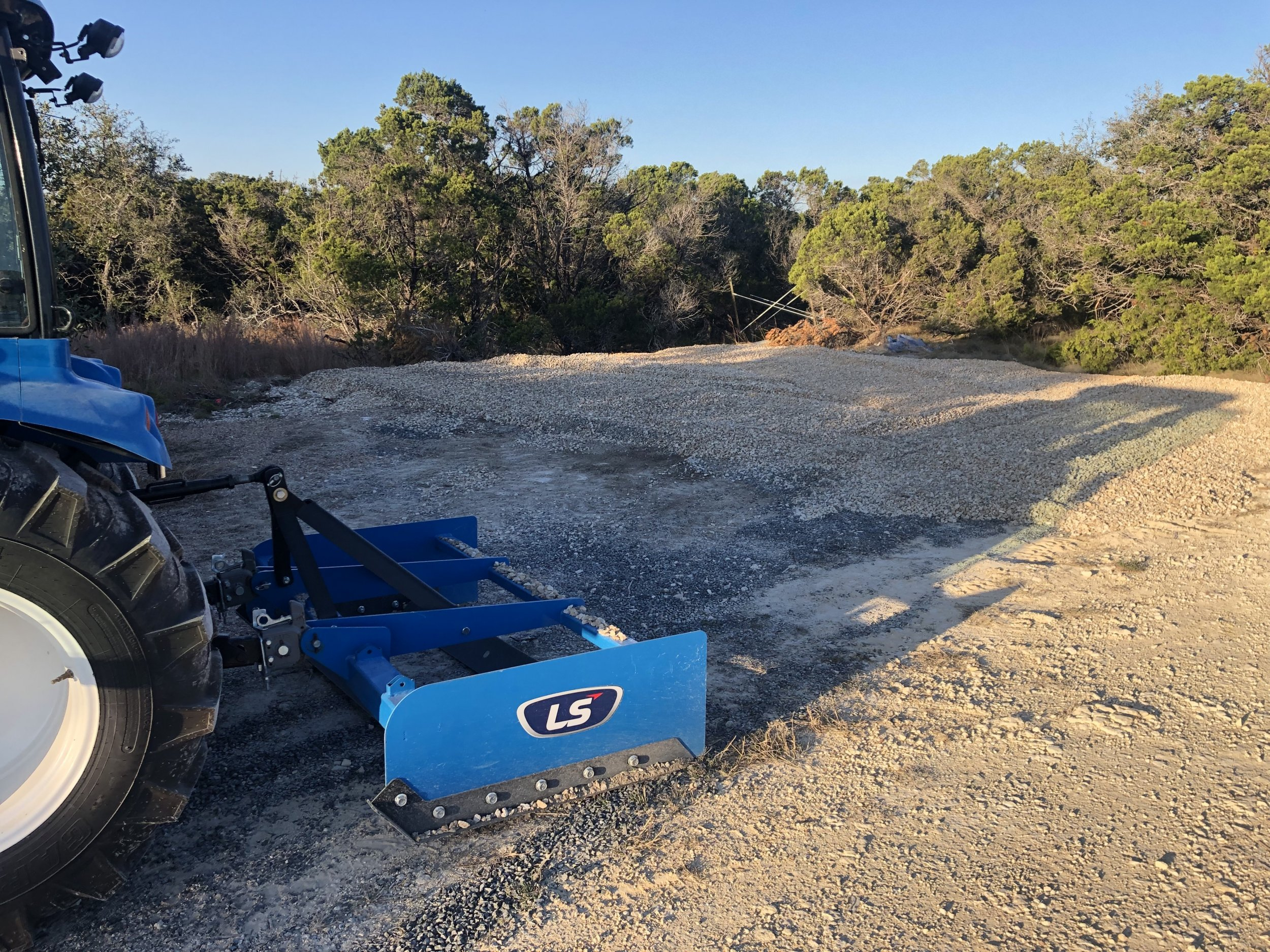

I'm getting a 20X26 Metal shed with 8' walls and enclosed on three sides to store my tractor and some of my attachments. To get ready for the shed, I cleared the ground and had a load of road base stone delivered. Trying to figure out the best way to get it level. I've been pushing it around with the tractor, but cant figure out how to get it level. When the tractor gets off the pad area, my implements are no longer level with what I am trying to build.
Do I need to do this the old fashioned way with a garden rake and sweat? For the tractor I have a land plane, bucket and box blade if needed.

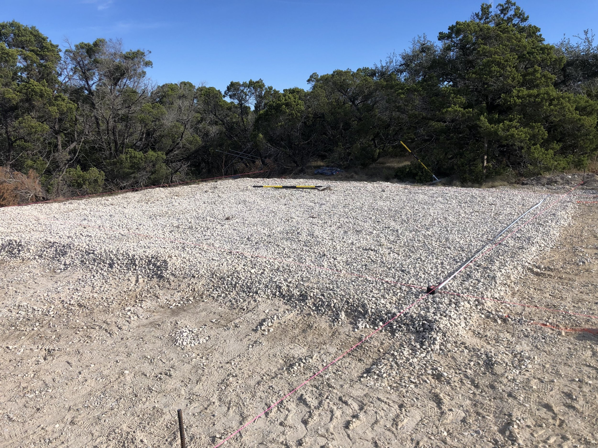

Its been a frustrating project so far. Underneath the area that I am building the shed is solid rock. I was only able to drive one stake in the ground today to attempt to use a string level. I pushed and pulled more stones around with the tractor using the land plane, bucket and a york rake with little success. I spent a good hour working on an area with a garden rake and landscaping rake. At the rate I am going to hand level with a rake I might be done by next spring.
Is it really this hard to level a 30x30 pad?

Just level the corners and edges. Use a transit level or a clear plastic tube full of water. Build your structure.
Don't worry about the middle until afterwards. The gravel is going to compact and settle over time and you will most likely have to add more later. Besides, the middle doesn't need to be perfect anyway since you are only going to park a tractor and implements.

Do you have position control on your tractor? Likely yes. I don't know LS's all that well but it should have it.
Level an area that all four wheels of your tractor can sit on, set you position control for your three point and start pulling the gravel. As long as the tractor is level it will stay level.
Or push backwards with your box blade.

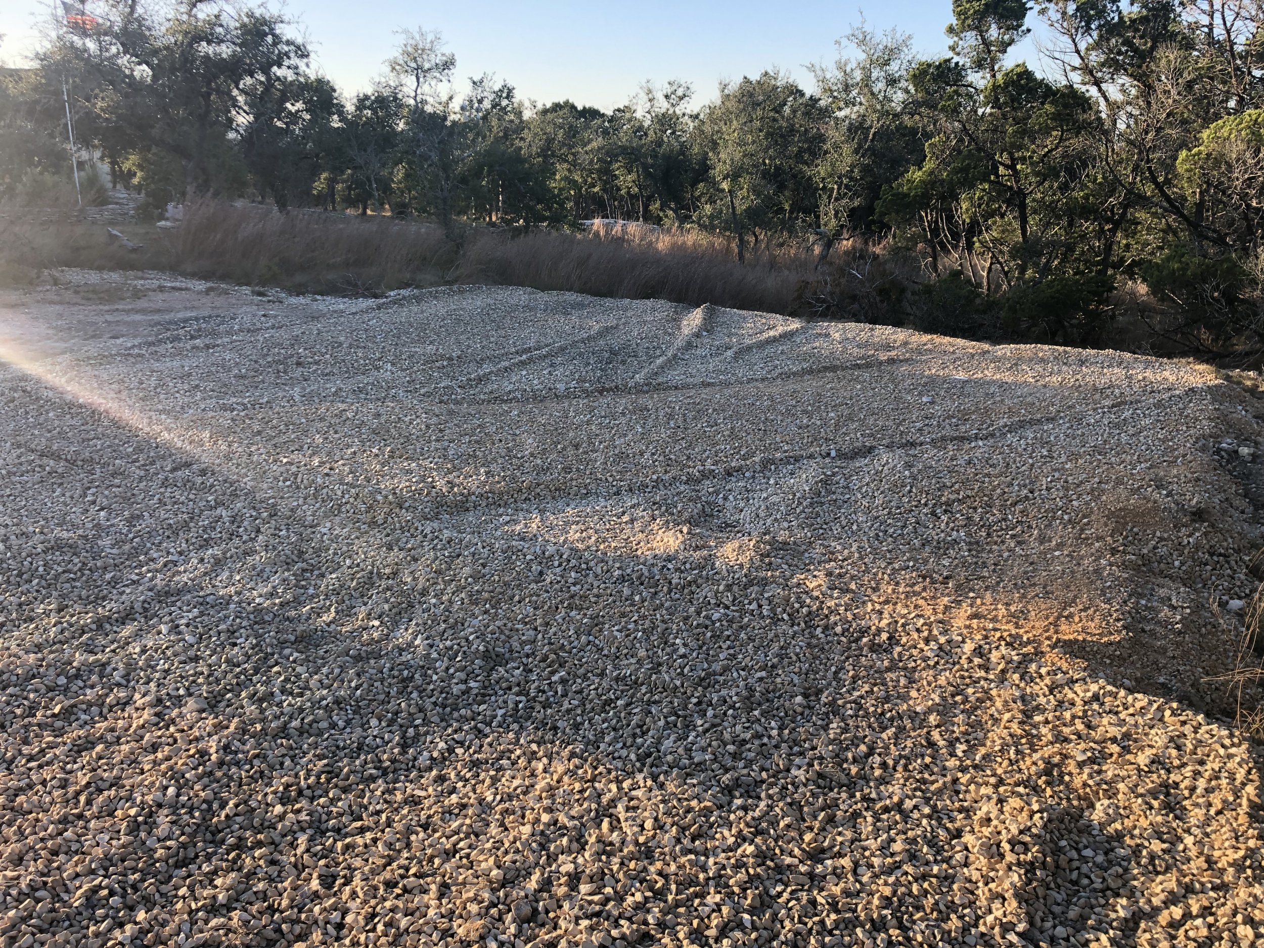

Made a lot of progress here and learned a lot on this project.
Things I have learned so far:
  • Have the stones dumped near where you are going to level and use the bucket to put them where you need them. Having them all dumped in the center and trying to push around with the tractor did not work.
  • Leveling smaller areas with tractor is hard if ground around the area is uneven. As soon as my tractor wheels would drop off the gravel area, implements did not help.
  • Having a transit is a huge help! To do it again, I would start with a transit, and slowly add stones from the bucket and rake them level where needed.
  • Go slow, move little amounts at a time. I tried to go to fast and leverage the tractor, only making more work for myself.

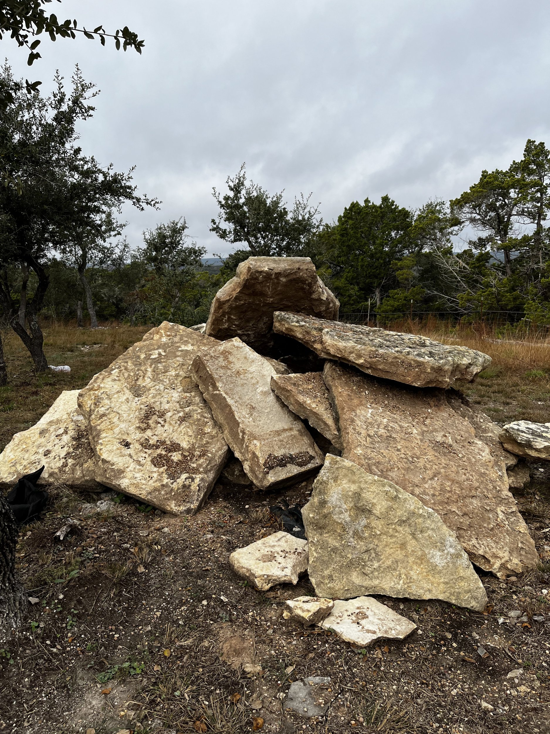

I was able to borrow a plate compactor and run it around the perimeter where the base plate will install. Fortunately (or unfortunately) things around here don't settle or shift since they area is layers of limestone. Below is a picture of the layers of rock they busted up and stacked up when we had our pool built. Each of of those slabs is at least 3'X3' and this is just a small pile of them
