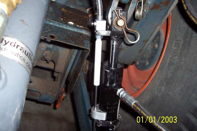

Thanks for the compliments, guys. The idea for the indicator came from sight gauges mounted to the side of a fluid reservoir such as hydraulic. Saying that makes we wonder if there would be another way of doing this by replacing the cable with a fluid filled tube. A little piston fitting closely inside the tube and pushed by the cylinder rod would raise and lower the fluid level in the sight gauge. There's probably a dozen reasons why that wouldn't work, but I enjoy thinking outside the box a little now and then.

I'm surprised that no one asked how the indicator is attached to the ROPS.
You are equipped so far above most of use that we didn't bother to notice. I.e., the ability to make the indicator holder in the first place.

I found that the inside wire of the cable was buckling due to the 4" plus unsupported length. So I added the UHMW (plastic) tube and a 3/16" diameter stainless rod to travel inside the tube. That seems to eliminate the buckling problem without creating any new problems. The UHMW tube was made by drilling out 1/2" round solid round to accept the 3/16" stainless plunger.
Looks like I need to clean the oil off of the PTO shaft cover from an earlier hydraulics mod.

That is a great mod. Very ingenious and well done. Thanks for sharing.
