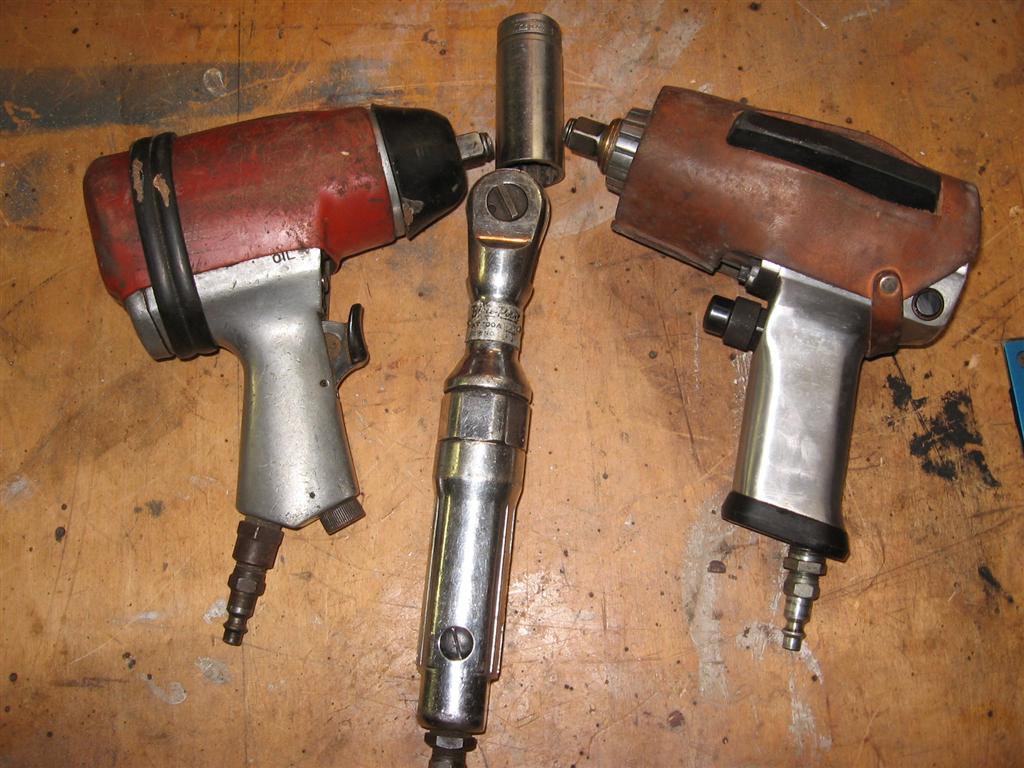

I repaired quite a number of Blue Point air tools of all kinds, but only one 3/4" Blue Point impact and that was an AT750. It was basically the same style as the CP734 half inch impact, with a few variations, but mostly just everything bigger and heavier.
/ lets talk impact wrenchs #70
Bird; Now that you mentioned it, that Blue Point does look a lot like an overgrown CP734. Thanks
