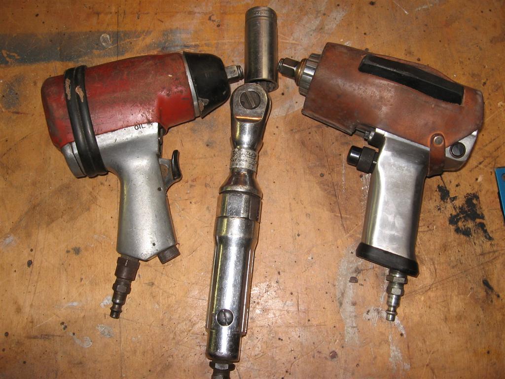

Here is a shot of my trio. :D
1979 model Blue Point
1979 model Blue point air ratchet
19?? model Snap on, Just bought off Ebay for $40, works great!!
I couldn't afford the Snap-on impact back in 1979, and if I recall I passed on the Snap-on air ratchet back then because the Blue Point was actually nicer. Probably cheaper to. I have a cheap HF air ratchet and it actually works ok because the bolts are smaller I'm removing. But I have held on to that Bluepoint to long and had my hand pined against a frame!!! :D
