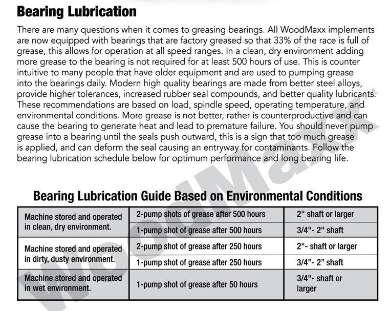

Here is the lubrication schedule. They make it pretty clear.
No wonder it failed!!!!!!!!!!!!!!!!!!!!!!!!!!!!!!!!!!!!!!!!!!!!!!!!!!!!!!!!!!!!!!!!!!!!!!!!!!!!!!!!!!!!!!!!!!!!!!!!!!!!!!!!!!!!!!!!!!!!!!!!!!!!!!!!!!!!!!
Roller bearings are ment to be filled completely with grease; oil lubricated bearings are
splash with the recommended oil for lubrication.
Whoever wrote that was terribly mistaken/miss-informed about greased high speed roller bearings and its cost you a flail mower.
I would start with a simple letter asking for a complete refund of your purchase and sending pictures as well.
If that does not work contacting the attorney general of the state this company does business in is the next step by detailing
what you have here, sending pictures etc., and then having the bearing failure which has cost you a flail mower and that you are seeking a full refund as the flail mower failed because of thier poorly written manual which you used to maintain it.
I agree with Leonz tell them their manual is incorrect and you are due a refund or full replacement. On the new one, grease it a couple pumps every 10 hours or so. Also try and keep the grass pulled off the shaft where it wraps around the ends. That can cut seals and shorten bearing life as well.
Currently I am being offered full new bearing assemblies, a new axle weldment and a new set of hammers. I appreciate the fast response. but... the idea of needing to rebuild the whole thing that I have nothing but trouble with isn't super exciting. I am contemplating my next steps.
I wouldn't touch their offer with a 10 foot pole. Their lube schedule is insane, as evidenced by the carnage you've got. Get your money back, and find something reputable to buy.
