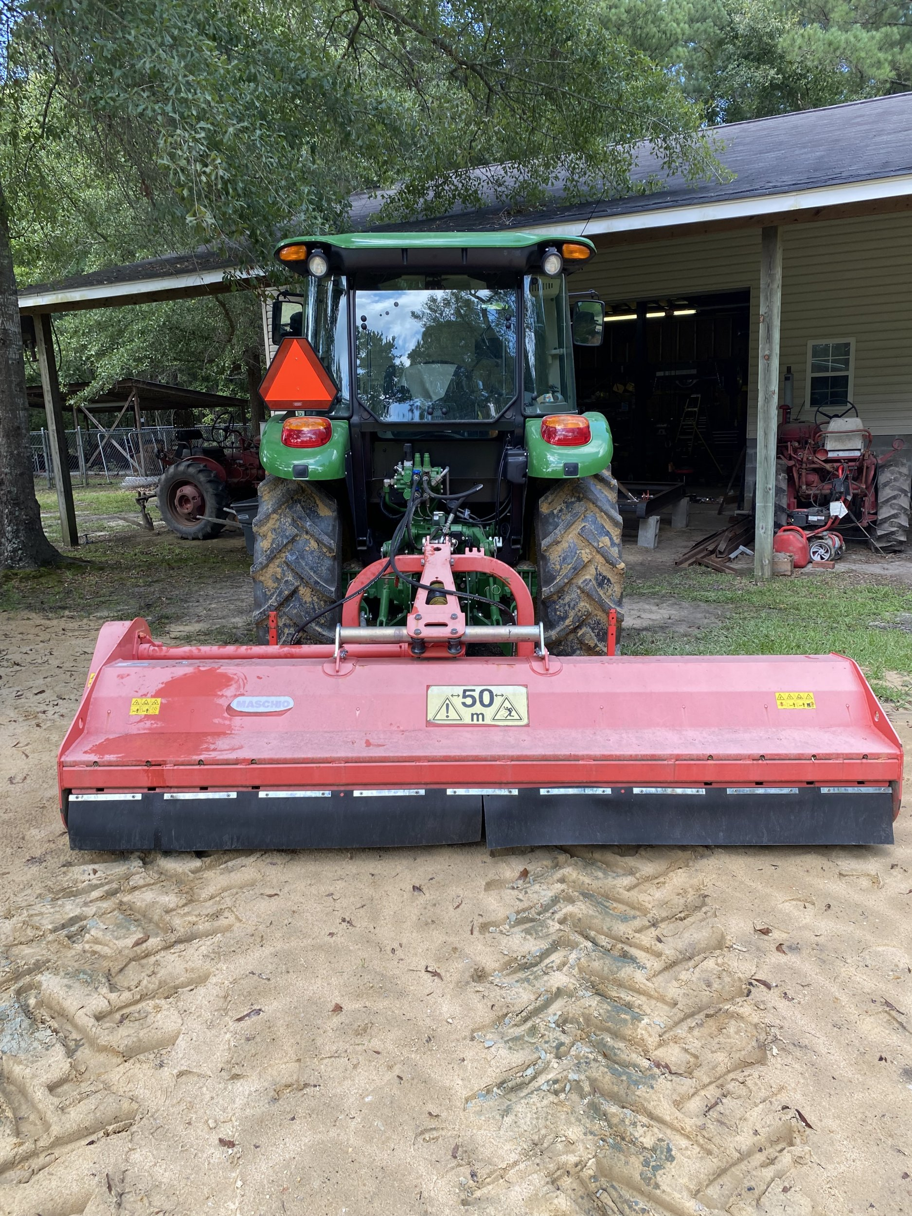

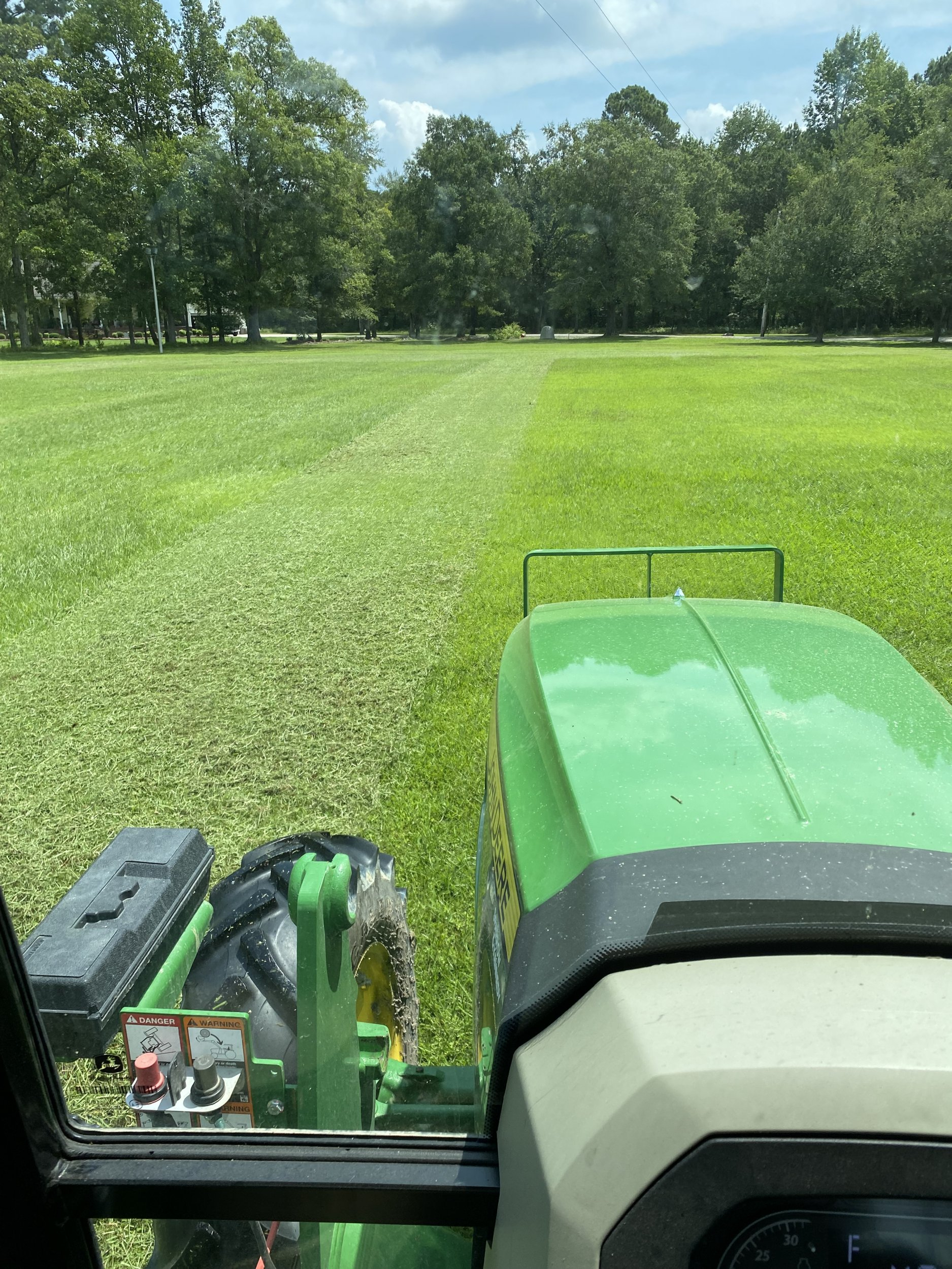

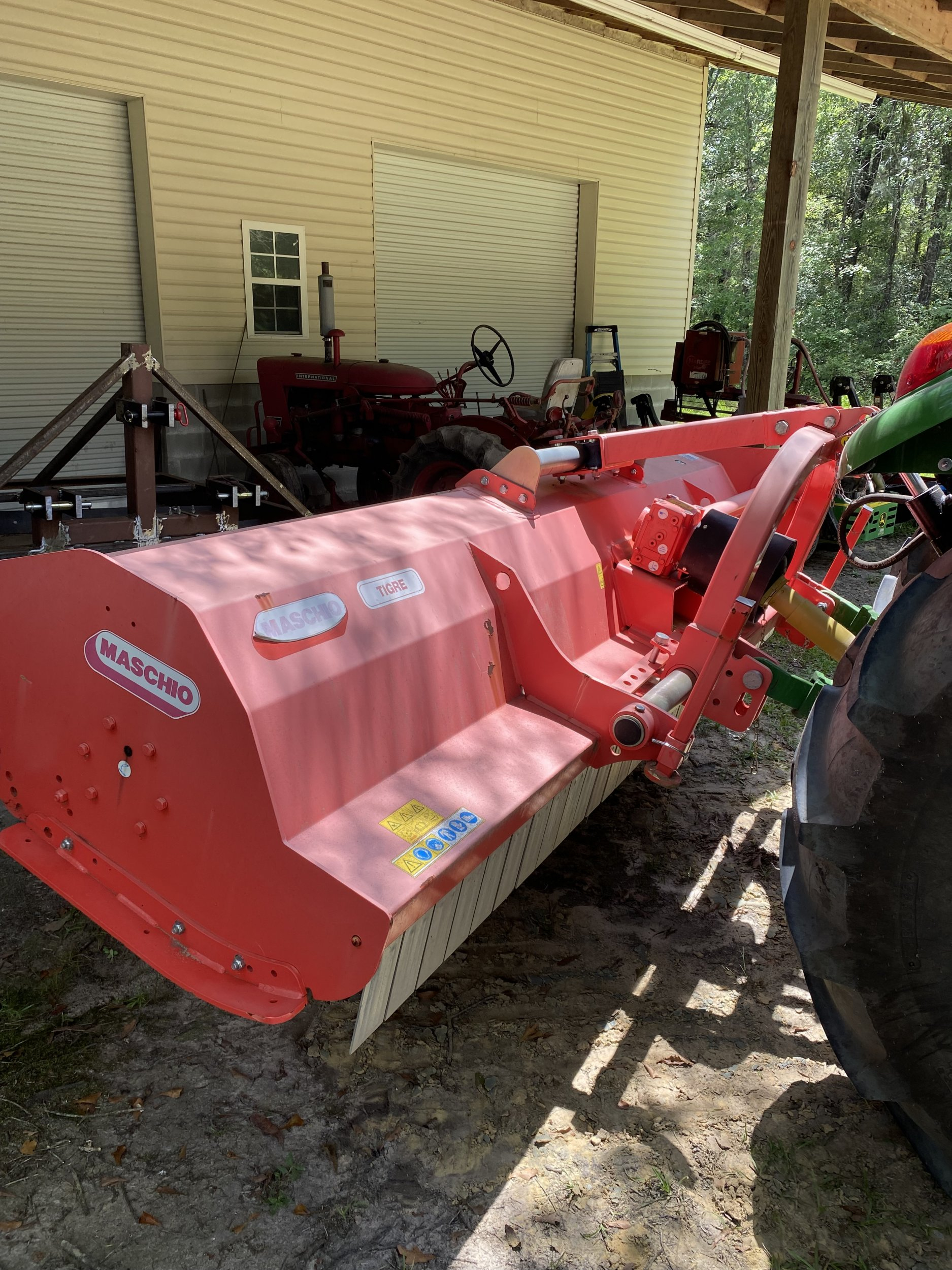

Here's the cut quality with my Maschio Tigre 300. Hammers. I've never had an issue with tire impressions not cutting with this or my Frontier 20' FM but I do run ag tires which I believe are less prone to mashing down the grass. The flail mower has an inherient suction that pulls the grass back up. It's almost like a vacuum running. But I do cut to 1.5 to 2 inches.

What rotation is that? Hammers or tines? Nice looking mower.

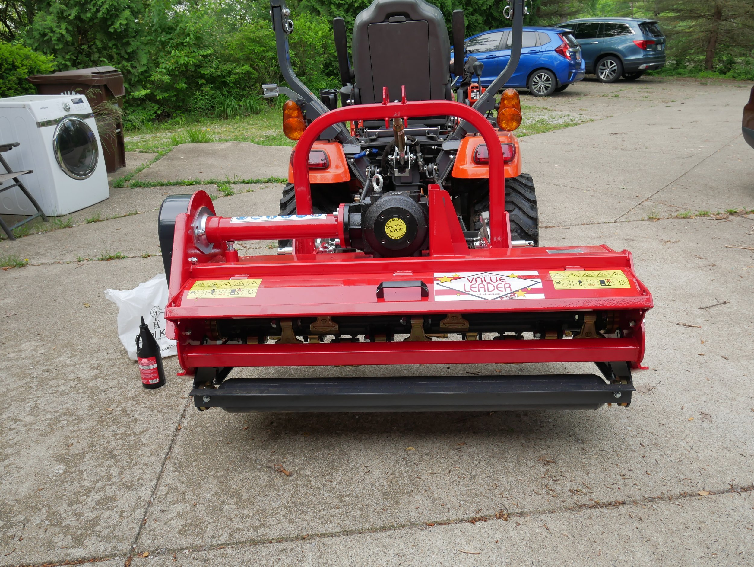

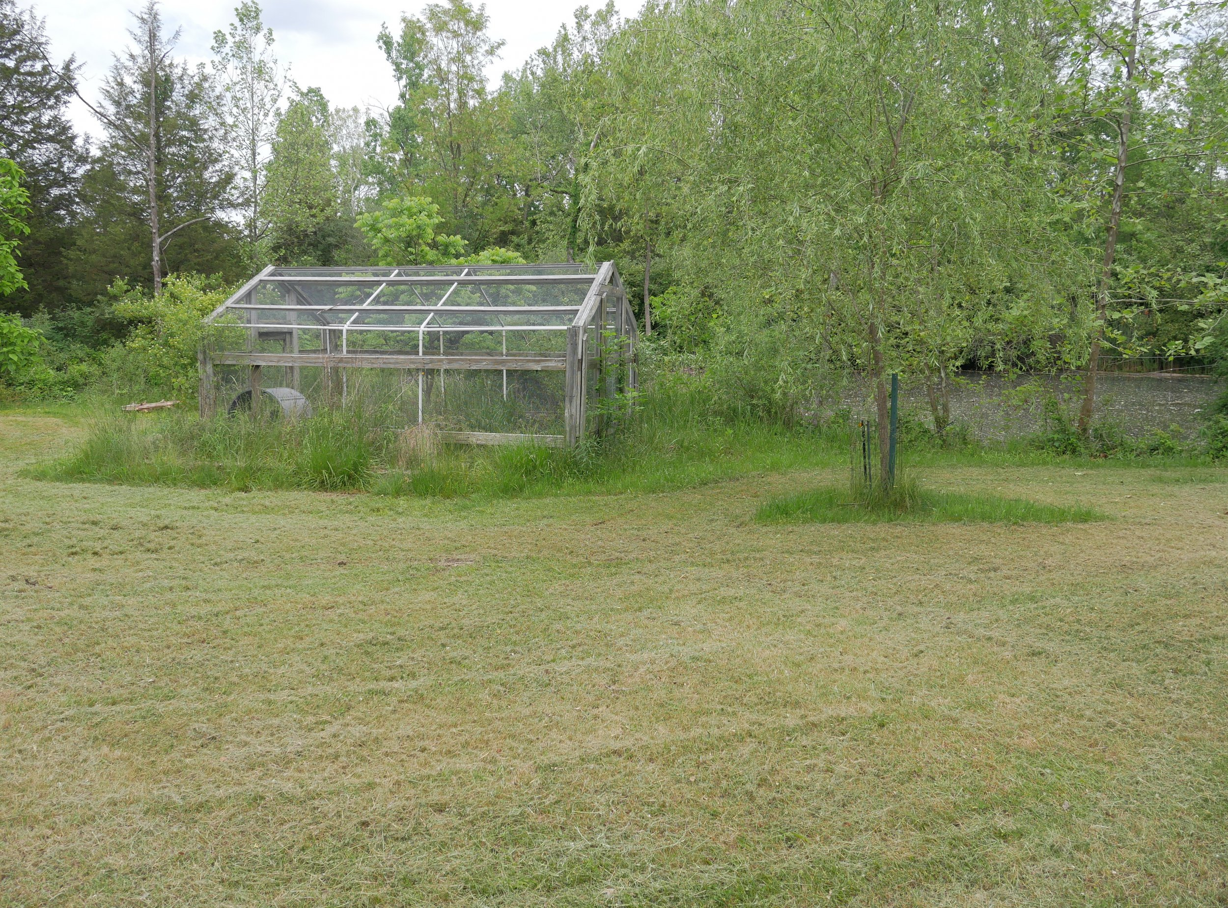

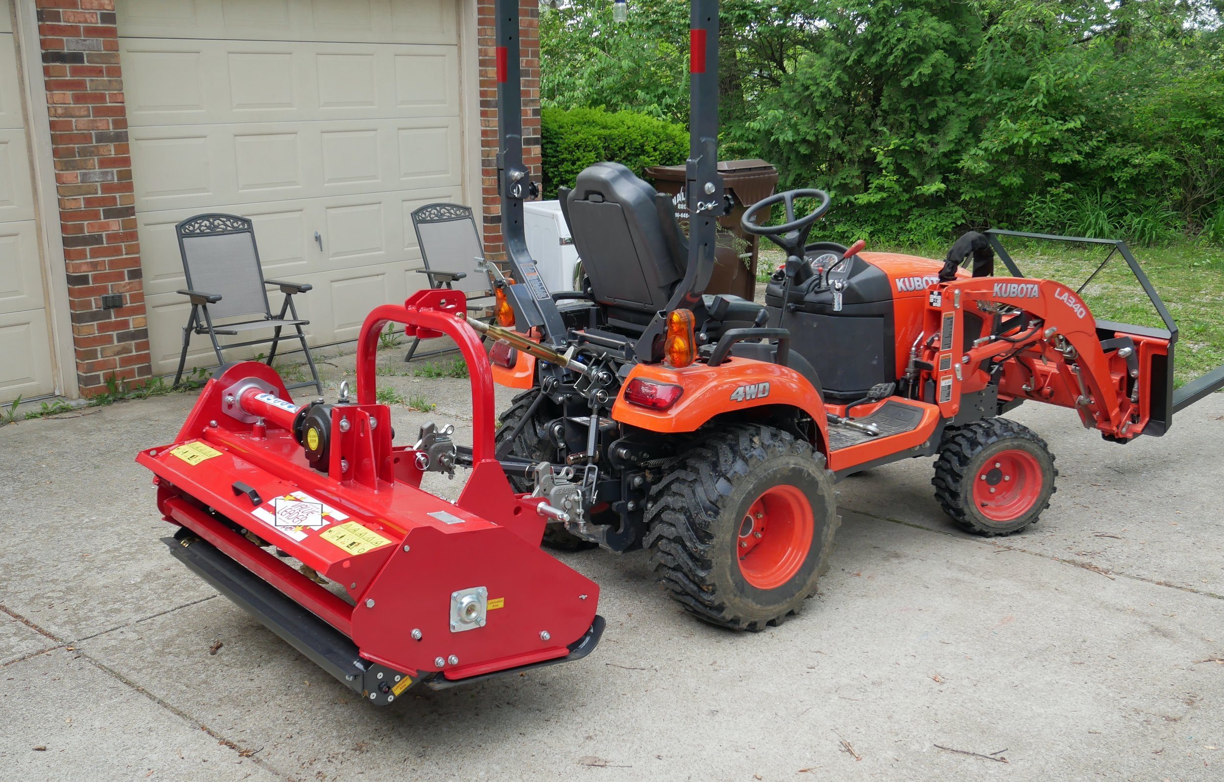

Pardon my reposting pictures, but I wanted to say I can highly recommend the Bestco Commercial grade 48" Flail Mower for use on a BX23s. The mower is built exceptionally strong, and it runs smoothly. It has an advantage that is very useful in that it has an adjustable hinged rear outlet that allows me to discharge partially mulched material out the rear of the unit. I use this option when cutting the back few acres that have grown over 3' tall. I close the discharge when cutting the regular grass field. The cut is very good; nearly as good as my Grasshopper front deck mower. It has hammer blades, and it cuts through 2" Autumn Olive saplings with ease. It is rated at 20HP minimum, but the BX23s handles it well. It is very heavy, at nearly 550 lbs. I've used it a number of times now, and have had no issues whatsoever.

I have the Betsco 48" HD Flail too and it does a great job. Rocks chip the hammers pretty easily and I am sure the belts that come with it won't last long. But the cut is good and it chews up 1-2" stalks pretty easy on my little 25 HP tractor.
