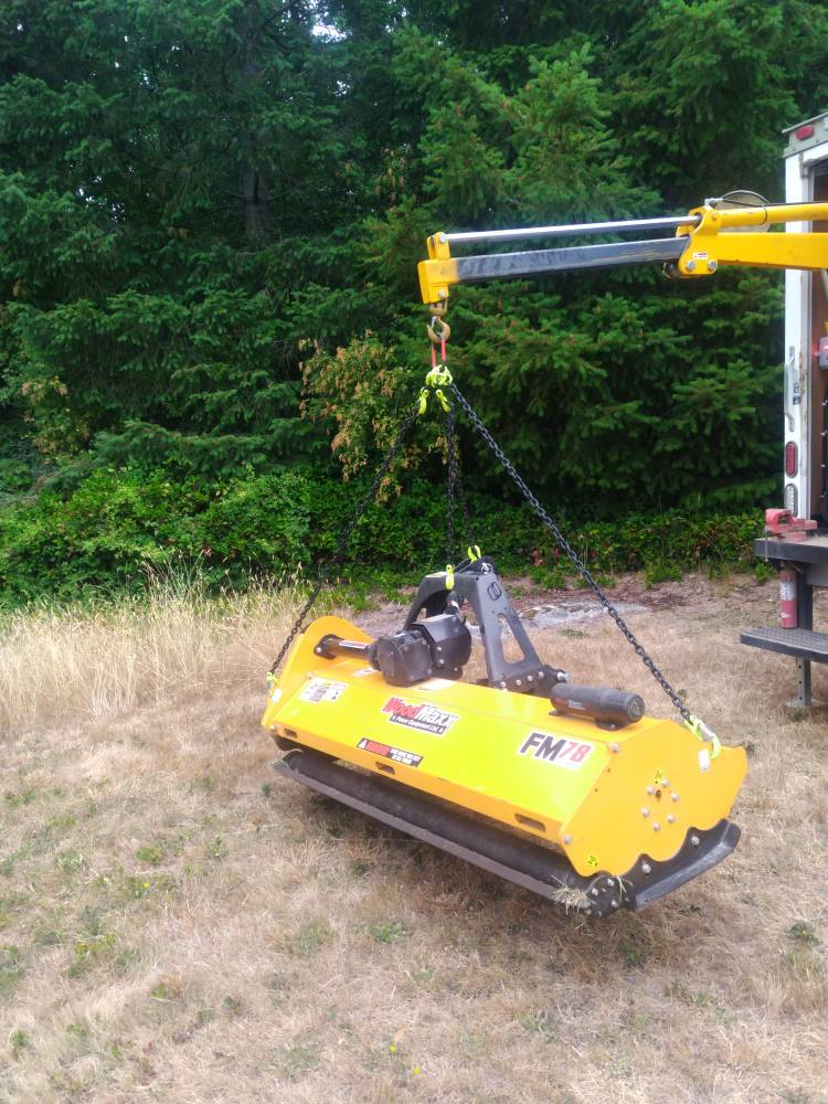

Well, I sold my Woodmaxx FM-78 today, the FM-88 I ordered should be here in 2-3 weeks. It'll be nice to have the extra width and offset to mow ditchbanks.
