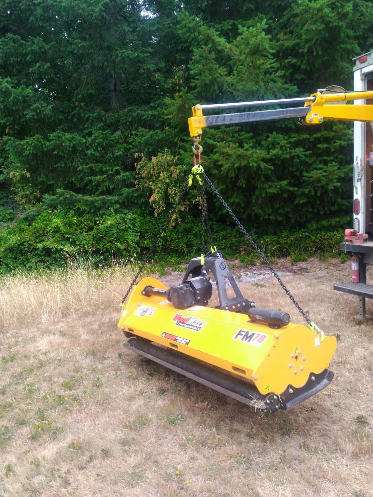

how did u like the woodmax 78, how good did it cut,hammers?
Mine had hammers, it was a good mower but if you cut tall grass it wouldn't pick up the tire tracks very well. Awesome in brush or even short grass though. Knives cut better if you're just planning on mowing grass.
