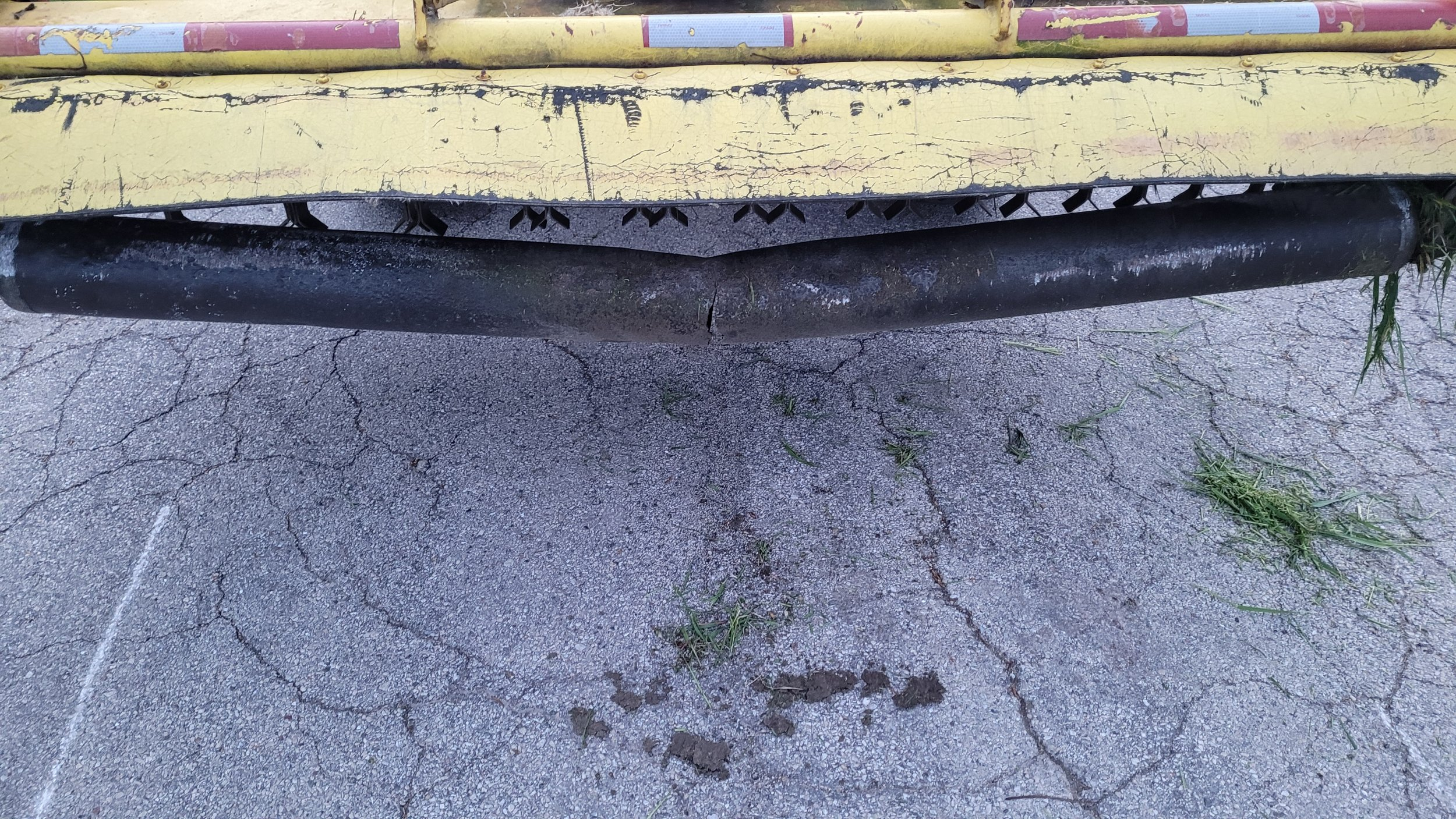

Well, that's not good...
The roller was old and quite beat up already, and it finally gave way last night. I don't recall hitting anything, but it could have been when I was mowing the ditch it wasn't sitting on a flat surface and the weight with a bounce was enough to do it in. It could also have been when I ran over a stump that was level with the grass, but there was a sudden bump when I went over it. There must have already been a crack there and last night was the final straw. Because the roller was so beat up I bought new roller ends back when Flailmaster was clearancing everything out for their restructure plan. Now I just need to get the tube. I'll likely go with a thicker wall tube than factory as weight is not an issue for me with this tractor.

OY!!!!!!!!!!!!!!!!!!!!!!!!!!!!!!!!!
If you can buy thick tube steel locally that would be best.
Do you have new rear roller bearings??
