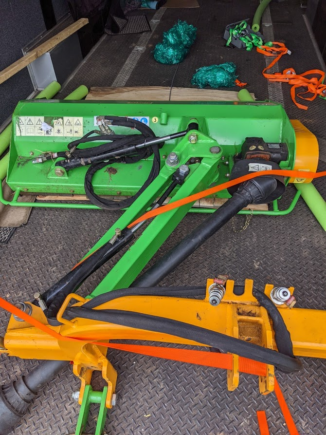

So guys, I have been trying to read through this thread but I jumped in at the end here because I ran across a Nova ditch mower for sale at a golf course near me. The claim they did not use it a lot because the angle and length of their ditches were to steep. They are ordering a RC on a boom. $1200 so I jumped on it. Hopefully a good purchase and should work well with the grass at my place (I hope) I'm so new at this I know I am going to make a mistake or 2 and this may or may not be one :)
It looks like a deal for $1200, but is that hydraulic cylinder "rod" bent or is the photo deceiving?
   / Let's talk flail mowers #7,142
I know the rod end is lower, but it sure looks bent.
I added a straight red line parallel to the cylinder:
A good hydraulic shop can straighten it (y) .

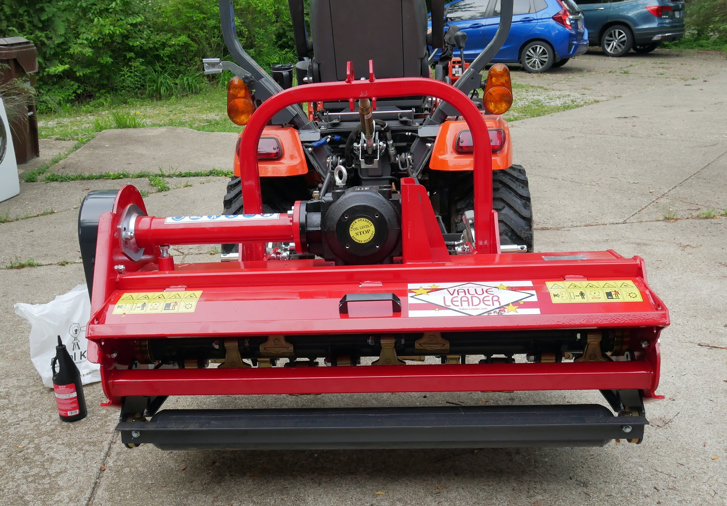

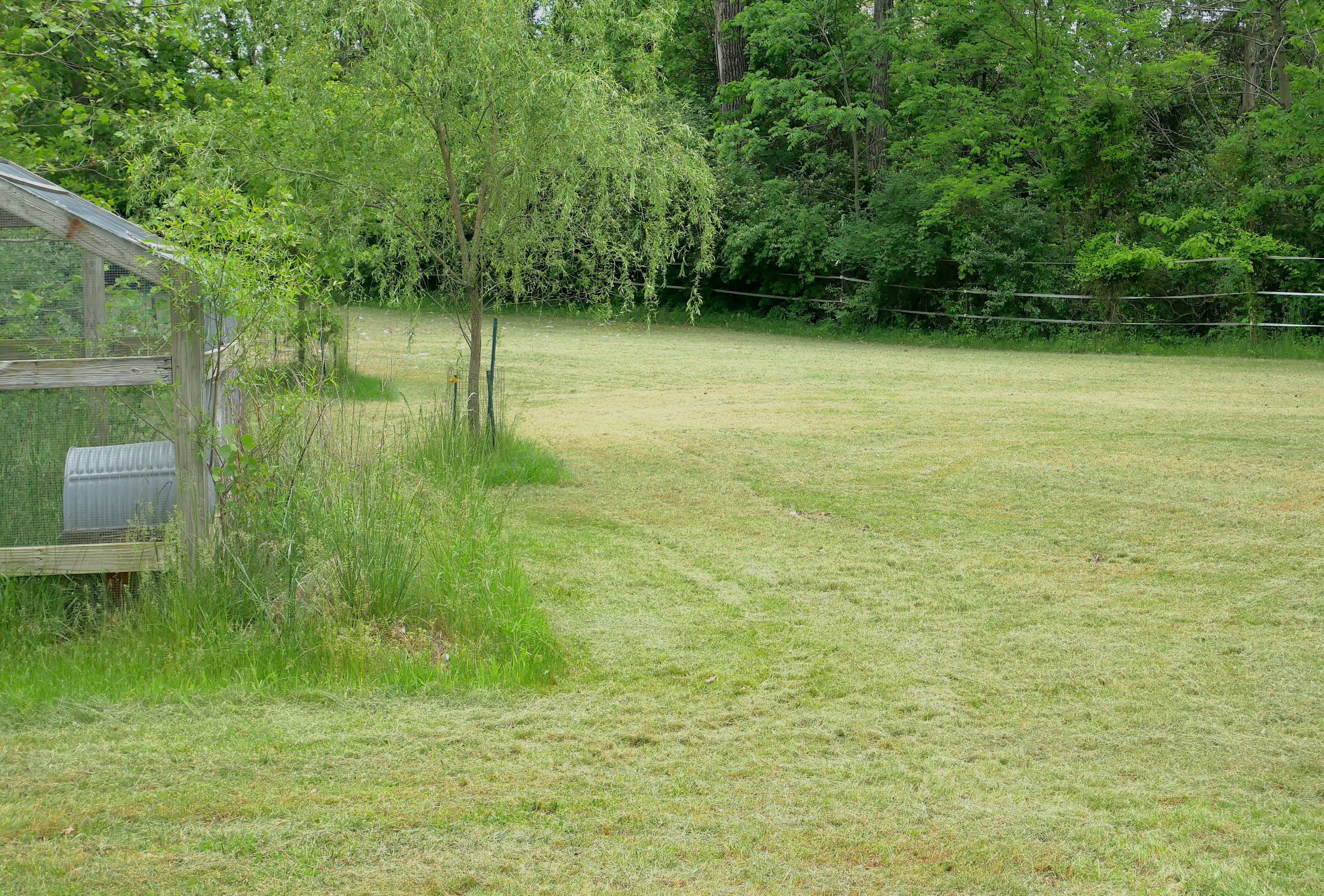

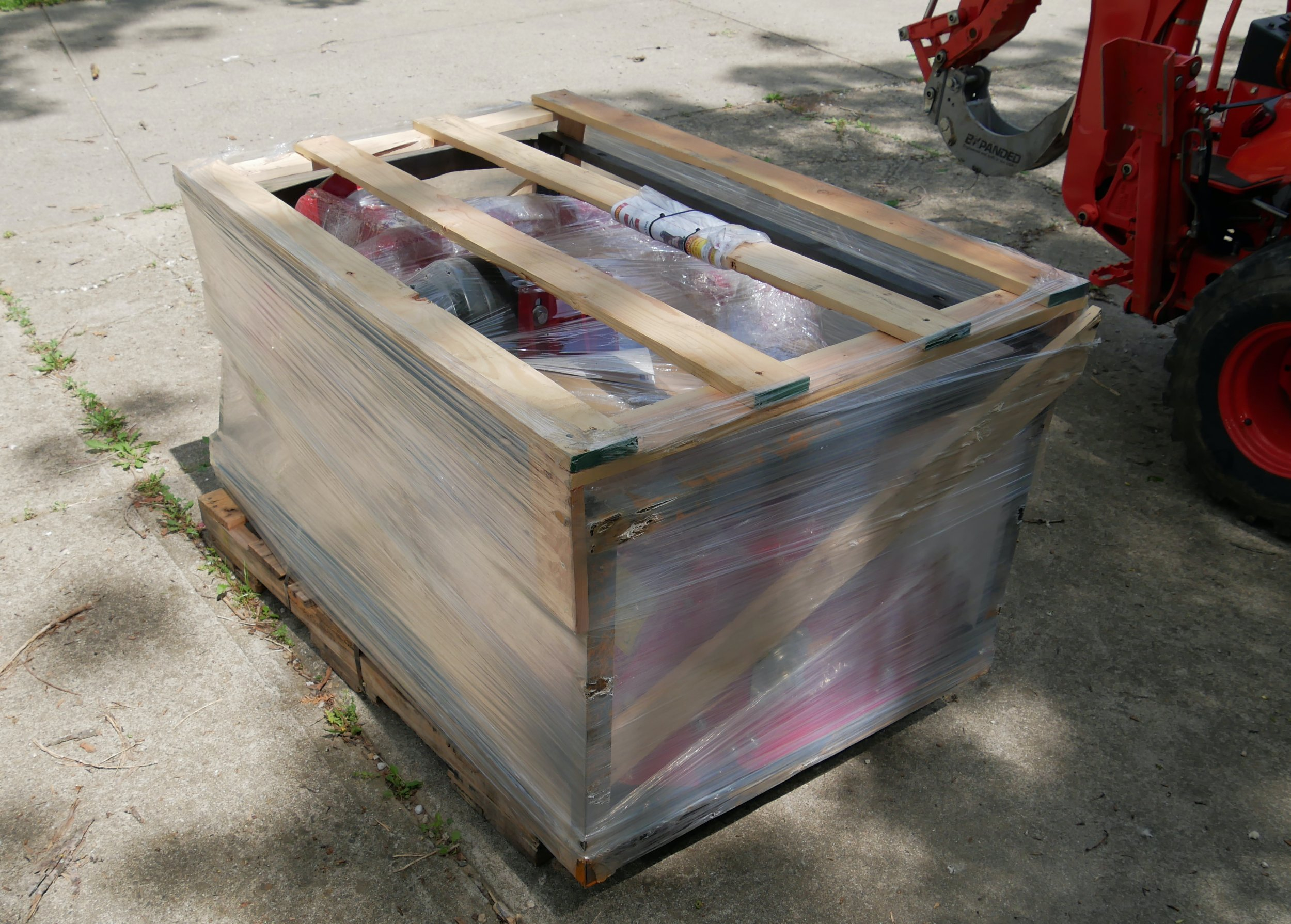

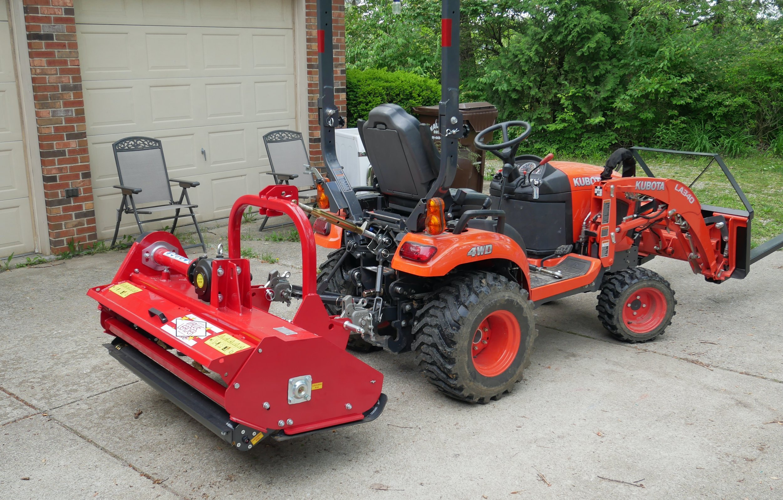

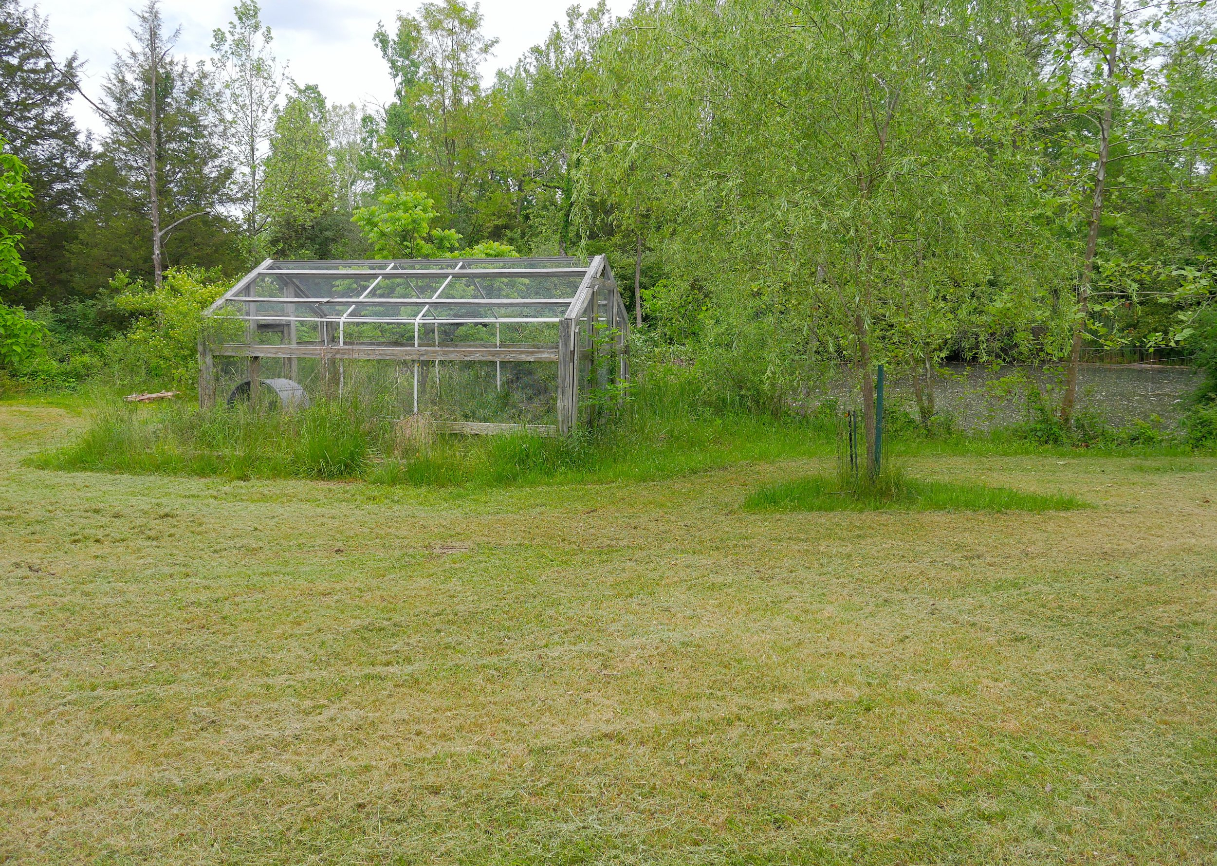

Just received and ran my commercial grade Betstco 48" flail. Took a bit to get it assembled, only because the components weight so much. Man, this thing is built like a tank. Once assembled, I had to cut the PTO shaft by 4" to fit. I also had to get a longer Top link to allow for the Pats quick hitch. First run was nothing short of perfect. 1.5 acres cut in 40 minutes. Cut as good as my Grasshopper, and left no clumps. The grass was about a foot tall, which normally would cause clumping issues with the Grasshopper. Nowhere near as maneuverable as the Grasshopper, but great for getting the majority of the area cut. This mower was listed as requiring 22HP, but my BX23s handled it well. As far as unloading goes, I was able to take it off the truck with the BX, but I couldn't lift it more than 6" off the ground. Not too bad for a 650 lb load extended 4 feet out past the pins. So far, extremely satisfied.

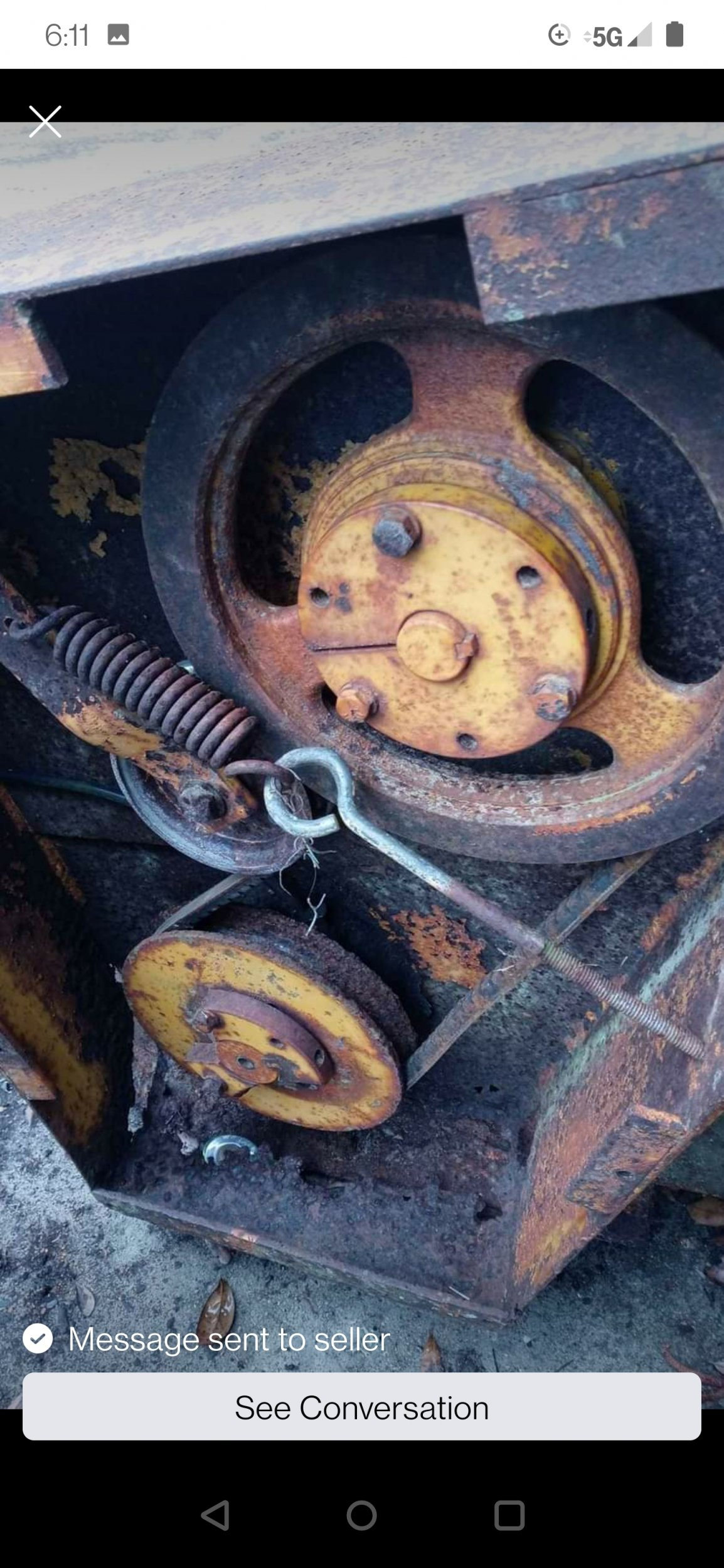

Hoping you guys can help me identify this flail mower I'm looking at. The seller says he doesn't know anything about it other than it works.
Thanks!

I don't know the brand but if it does work, it hasn't in a while. What is the seller asking for it?

It looks like a good project and will keep the next owner busy for a week or two while doing an overhaul and spending few hundred bucks on parts.

@MaSon_ Welcome to TBN. I should of said that in my first reply to your question.
Personally I would keep looking but I don't know what your needs are. Like arto said, it looks like a good project but $400 is more than I would want to spend on it. Good luck.
