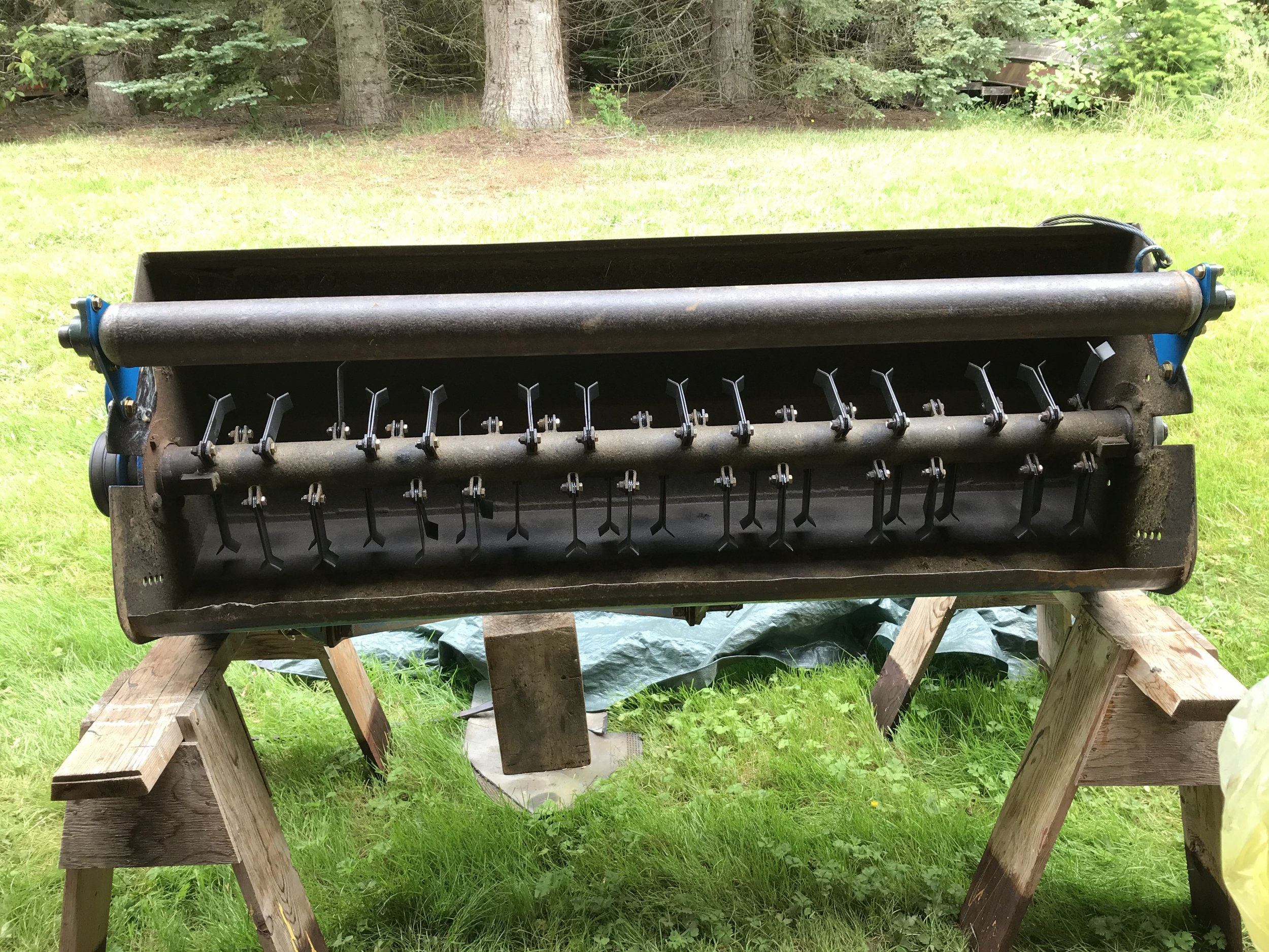

Does anyone know anything about this model of flail mower? Never seen one by Woods. Are they any good? Any thoughts on what it should be worth? It's a 6' model.

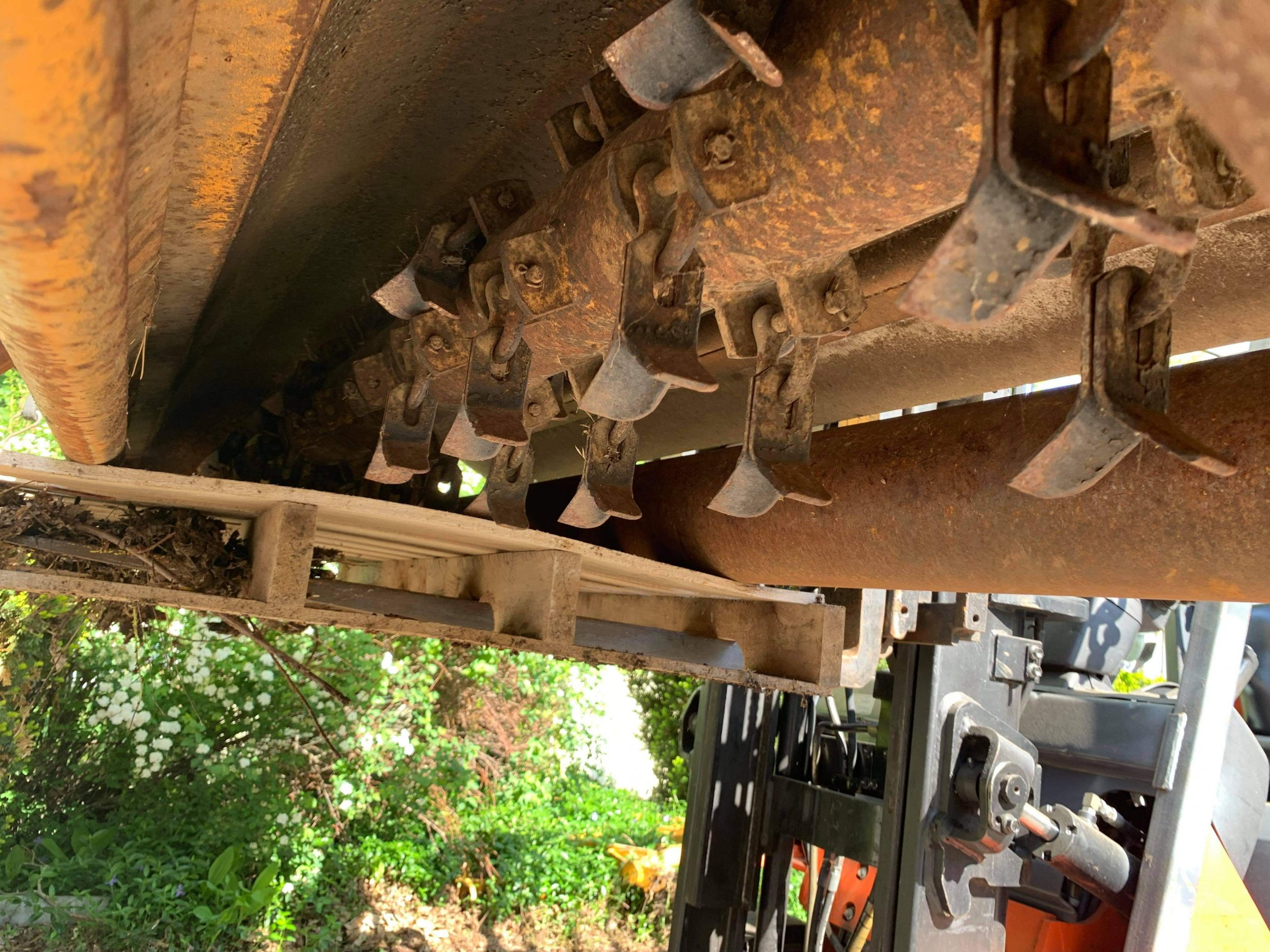

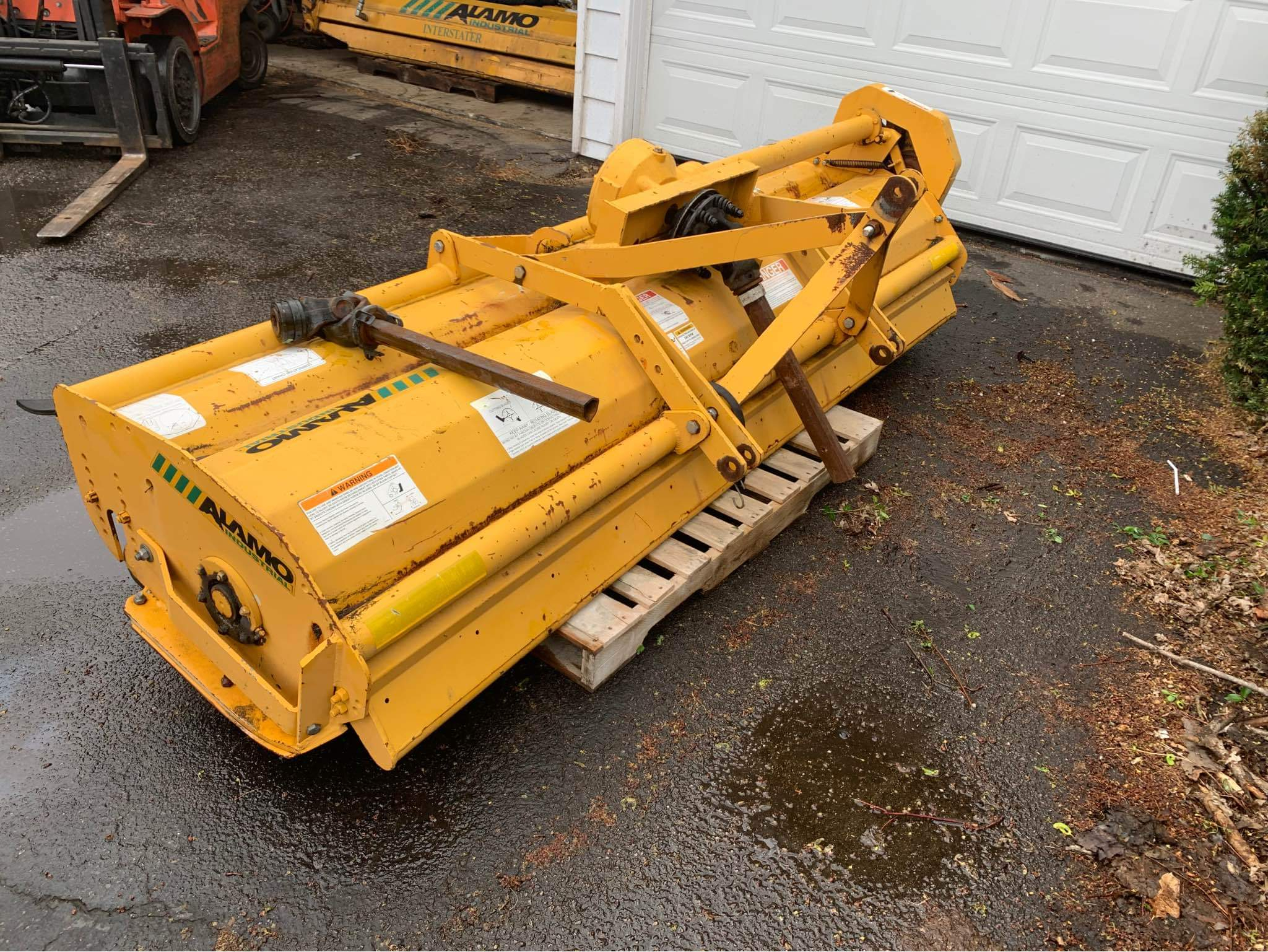

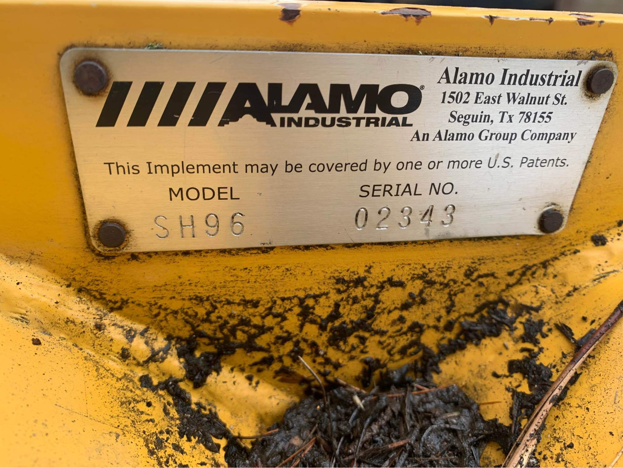

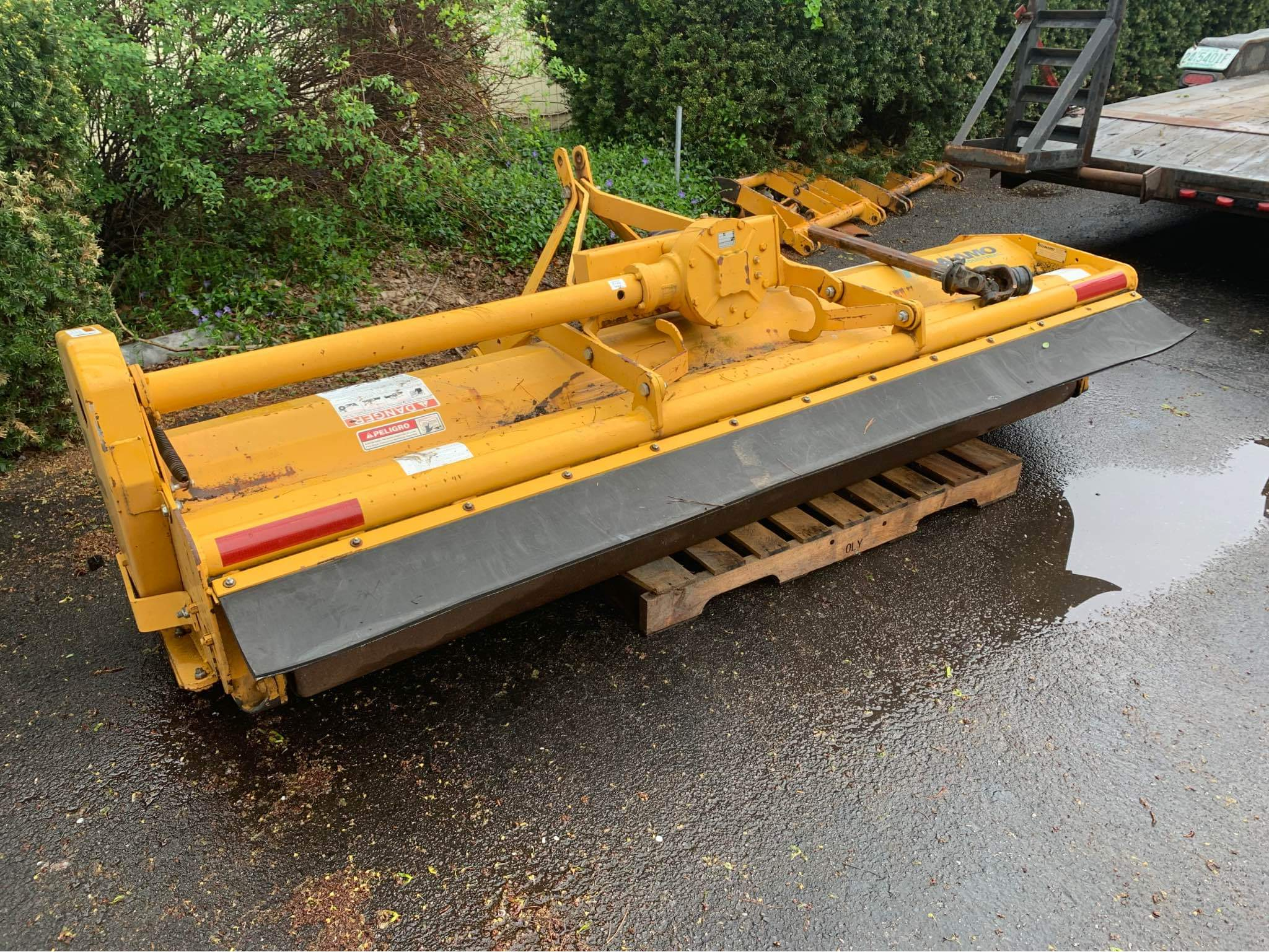

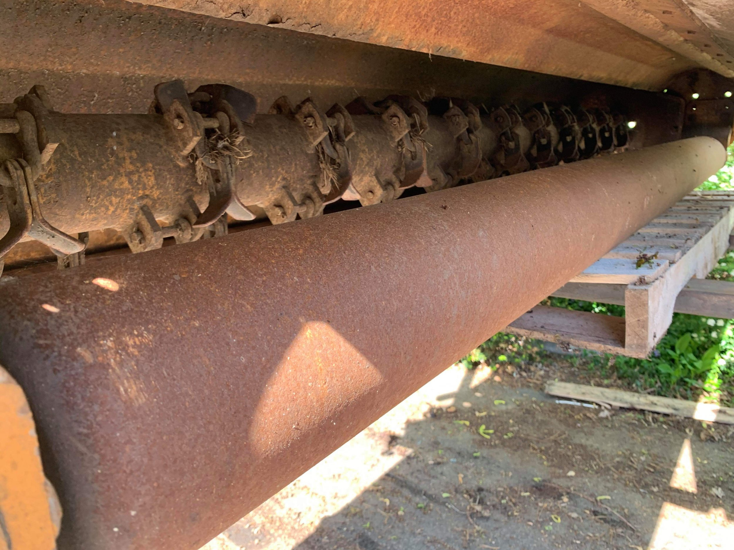

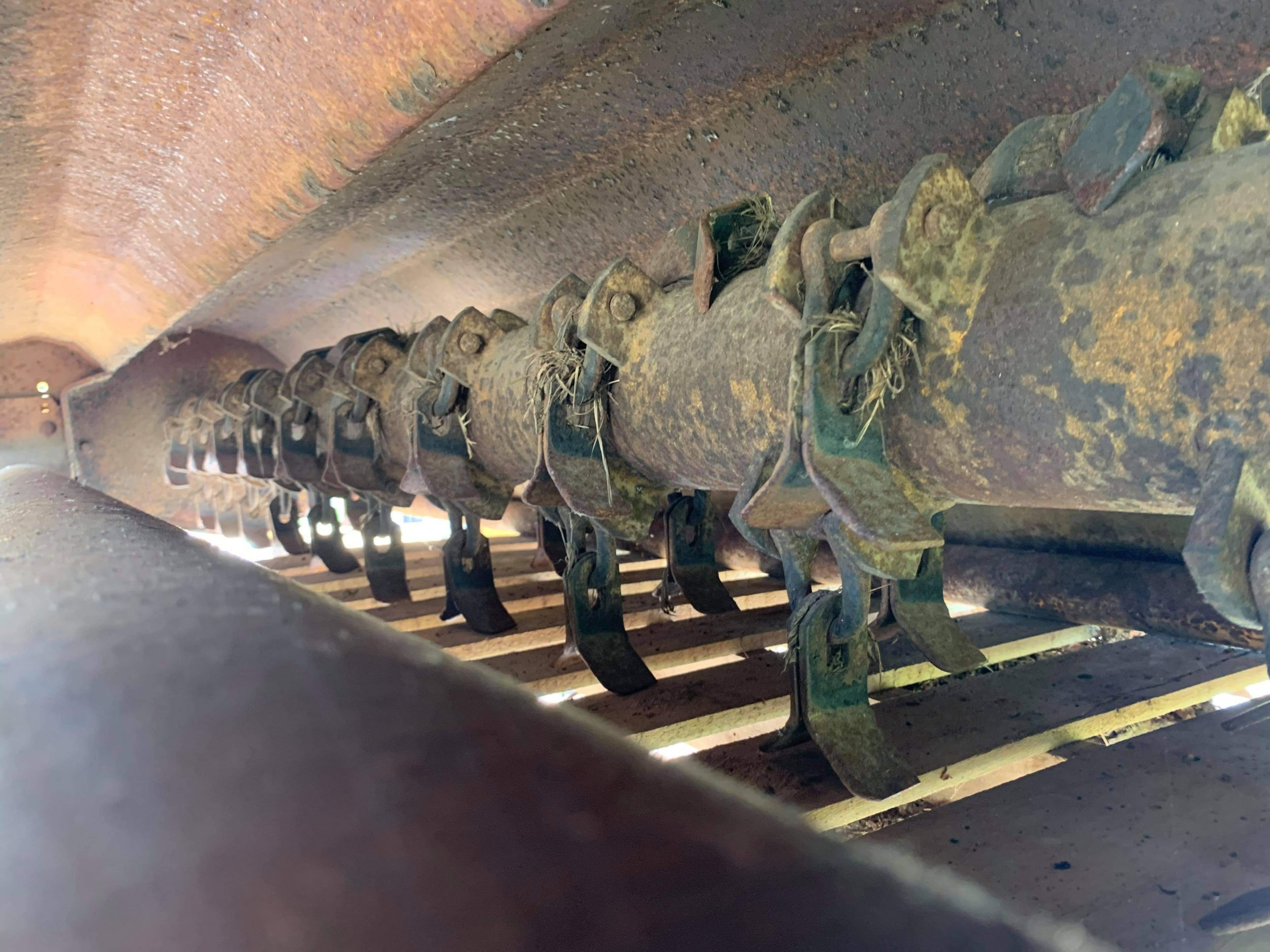

Would you folks pay 3k for a nice Alamo SH96? Would this flail be useful for brush mowing and trail cutting in woods?
Tractor is a Kubota m5-111
180063706_10220026660836913_5452427355511268085_n.jpg179984746_10220026660516905_4944670854192351267_n.jpg179591888_10220026666917065_8284084736995397403_n.jpgreceived_4649170198432779.jpegreceived_223969215778212.jpegreceived_476088250345450.jpeg
   / Let's talk flail mowers #7,109
i doubt a 96" offset flail mower would make a good trail mower. unless it was a road.
   / Let's talk flail mowers #7,110
View attachment 698606View attachment 698607View attachment 698608View attachment 698609View attachment 698610View attachment 698611
Side slicer knives are light & good for grass. For brush you need heavy hammers. My old 917 with side slicers stopped doing much but stripping bark on woddy things much bigger than finger sized. Compare those light knives to the 5lbs hammers on my machine.
I spent 5.5 hours yesterday with my Peruzzo Brush Bull. Never hit a blade of grass, just wrist sized scrub oak. Property owners were ecstatic at the reclaimed land & how well it mulched. Scope kept changing as they saw how fast & well it was cutting. But it is an hourly job so no problem with logging more hours. Will grab photos tomorow.
