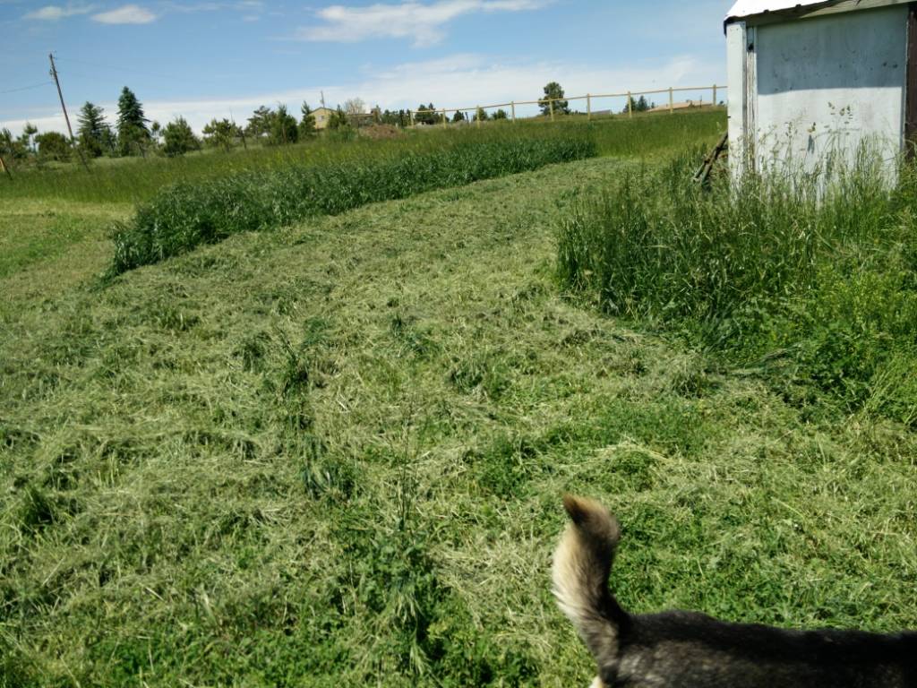

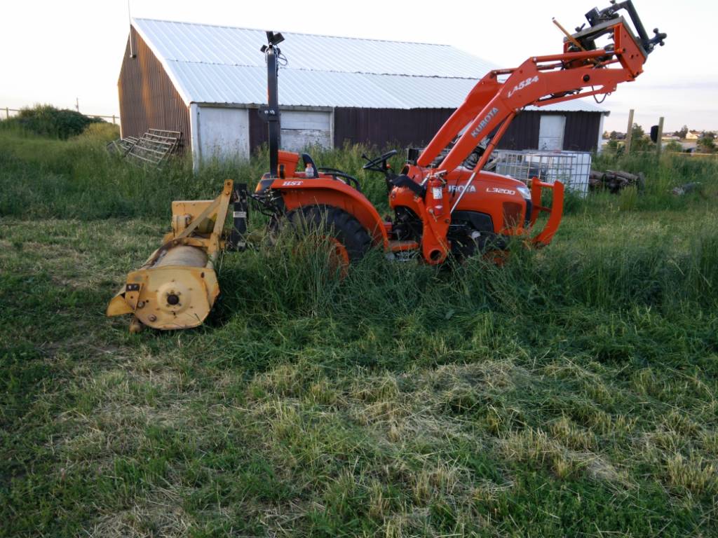

L3200, 25hp PTO (actually probably 20% less due to my 7,000' altitude) & the 7' 917... I was going pretty slow in this grass, but covering about the same acres per hour as with the 5' rotary.
I rarely go 4mph with my new L4060HSTC (32.5hp PTO, actually probably 20% less due to my 7,000' altitude) & 8' Peruzzo. Even when its light material not taxing the machine the fields I mow get to rough at 3-4mph. Sometimes I'll kick it into M-high & 5mph or so on smoother light stuff.
Grass is the biggest HP requirement to cut, way more than writs sized woody material at times. 8" of thick green grass is a lot more mass than a few feet of tall thin dryer material.
Your real 40hp PTO vs the grass in my photos might be able to keep up 4mph with a 719. May need to drop a gear to 3mph or so, but it should be pretty doable.View attachment 623844View attachment 623845
