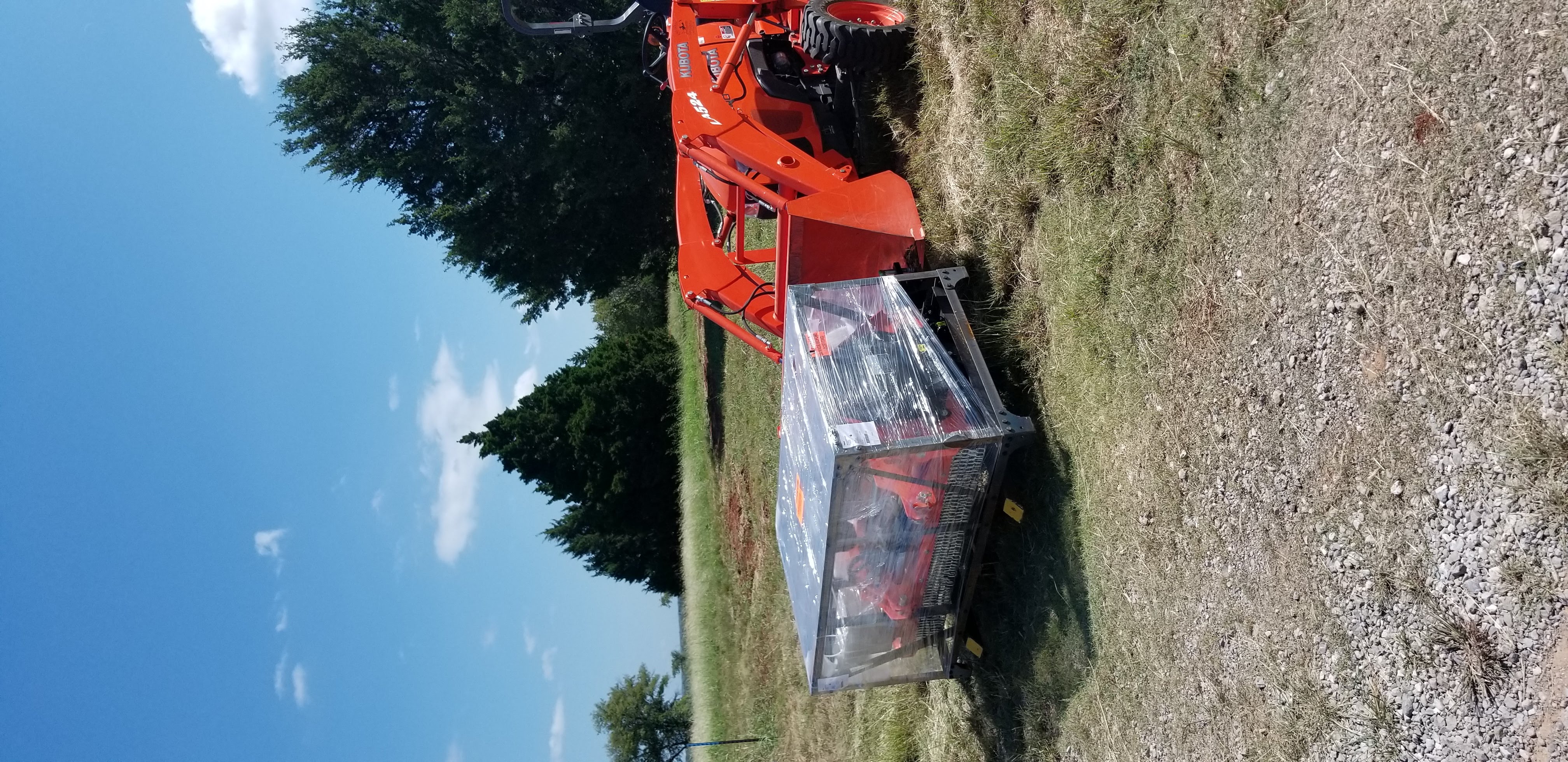

thanks Bruce good idea on the rear flap. I had WoodMaxx send me the gear oil so I am good there. Picked up the fitting for the hydraulics also. It looks like my transmission and hydraulic share the same oil.
My Kubota L3200 barely got it off the truck. I have forks attached to my bucket and flat it would not lift the mower. Driver said it was 900 lbs the manifest says 848 lbs. I was able to tilt it up and then it cleared the truck bed. Slowly backed away the lowered the bucket. Once about a foot off the ground with more tilt I was able to lift a little. Hope to have it ready to try out this weekend.

My B2910 had no problem unloading my WoodMaxx from the truck. That’s the difference with dedicated pallet forks. I used bottom crate to make dolly for the mower.

I'm sure dedicated pallet forks would make a big difference. With bolt ons, you are WAY far from the "pin".
Also, Kubotas aren't known for stellar lift capacity.
For yours:
Lift to full height (at pin): 1,131 lbs
Lift to full height (at 500mm/20 in): 855 lbs.
20" with bolt on forks isn't even to the edge of the bucket and you have all the weight past that. I'm surprised you managed to get it off the truck.
Pallet forks aren't real expensive, I'd invest in one if I were you (I did because I AM me ;) ) I have used them to get attachments off trucks, I cut logs to 8' in the woods and bring them back to the house on the forks, I stack my split wood in racks (1/3 cord) I custom made where the wood dries and I can move them up to the porch landing where I can pull the wood as needed from inside the porch (2 door onto the enclosed porch) and I've dug out rocks in my field and moved them to the rock piles started most likely 150+ years ago by others. You will find plenty of uses for forks if you get them.

without a doubt I will eventually want to get pallet forks, but without a quick connect FEL was trying to get by until I am ready to make the change to a Quick Connect. I may look at pallet forks that pin on.
