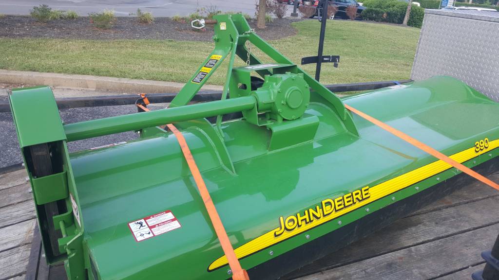

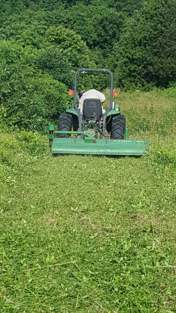

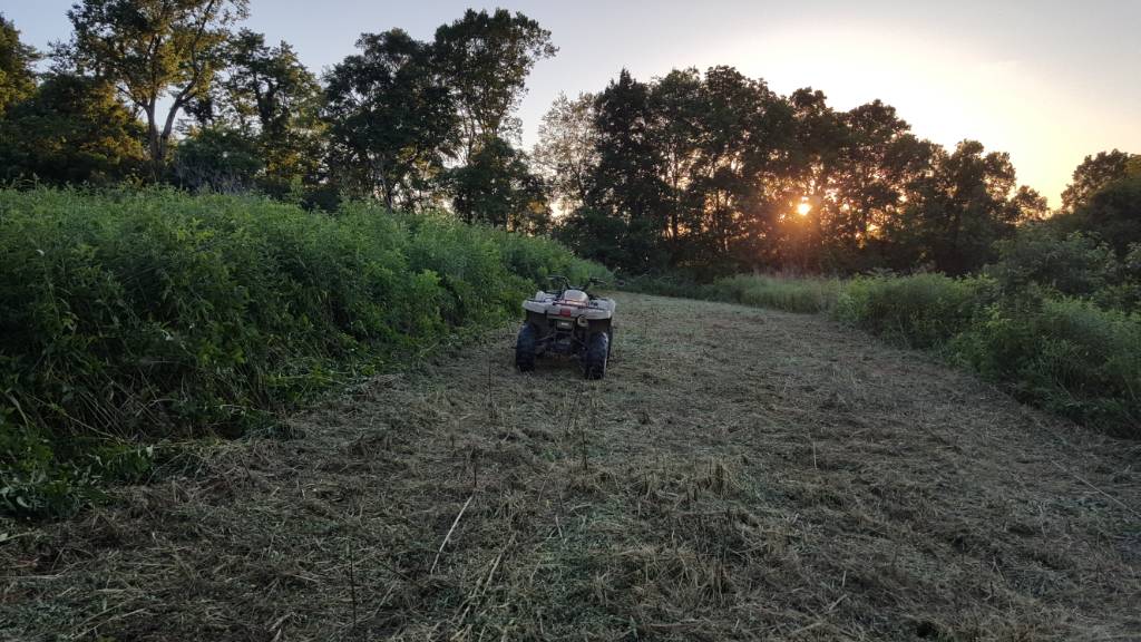

I have both a JD25A (with side slicers), and a JD390. Sold the BH 3210 once i mowed the field a couple times with the 390. Will keep the 5' rotary for backing into the tree line with the 4300HST, but all pasture, paddock, and field cutting will be done with the flails. I love the way they mulch the cuttings and lack of windrows and clumps as i attempt to reclaim neglected hillside pastures. Attached is a pic of my first pass with the 25A behind the JD 4300HST this past spring. The stalks left behind look rough, but keep in mind the first cut was 6-7' tall brambles and assorted brush. The second pic is the 2nd cutting a month later . After seeing this I decided to get the 8' wide JD390 for my 70hp AGCO Allis 5670. The 390 takes care of the brush up to 3" softwood trees. But i prefer not to use it to back into trees to protect the rear sheet metal. As we get the vineyard set up, I'm considering a 54"-60" flail and 17-21 hp tractor for maintenance. 20180603_193443.jpeg20180603_085800.jpeg1529191270386.jpeg

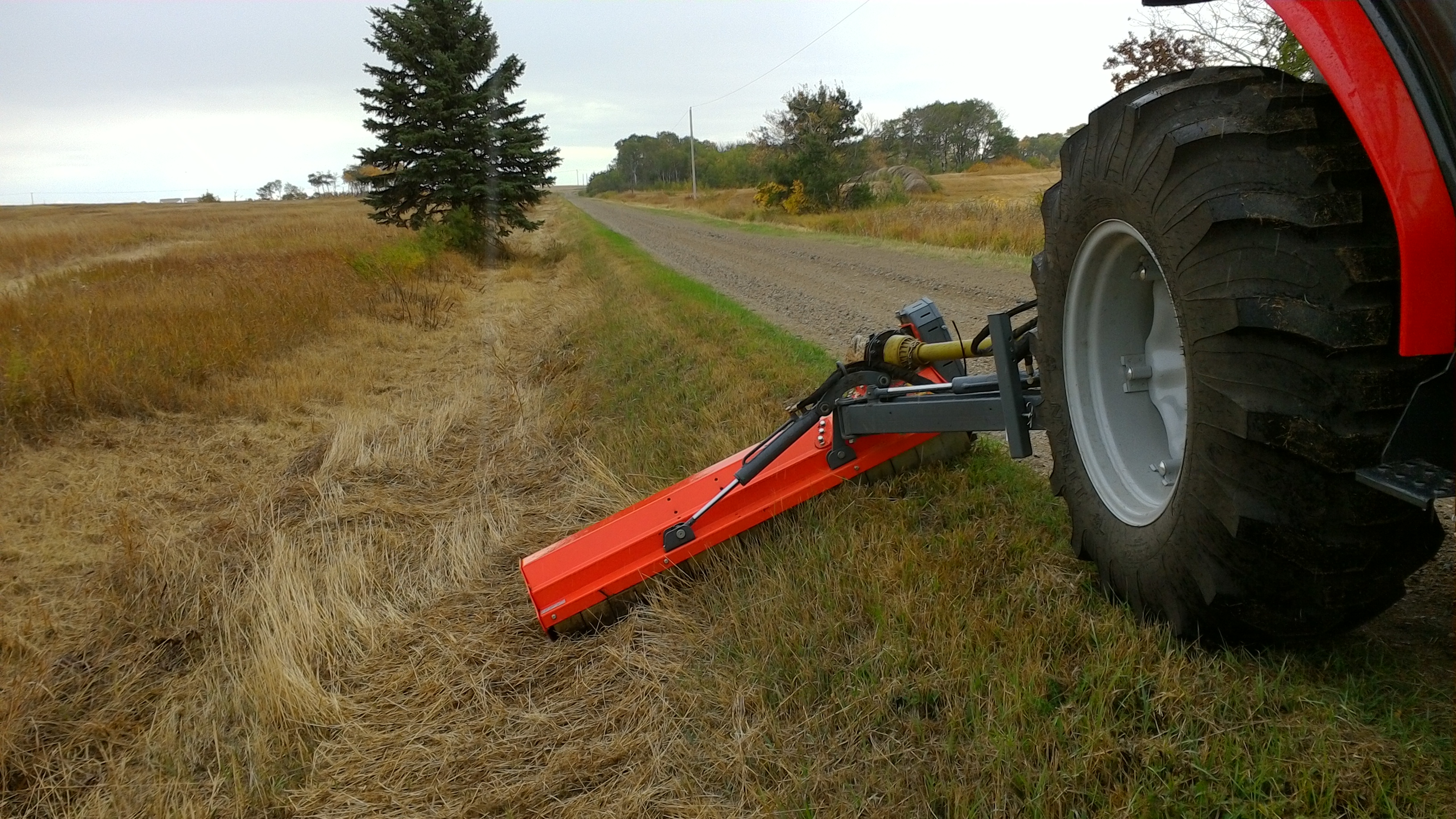

Mateng mower, forgot to grab a pic of it behind the tractor for regular mowing.

The dealer is about 500 miles from me, OTS Auto Electric, Nisku Alberta, Canada. Shipping was cheap, $140.00
