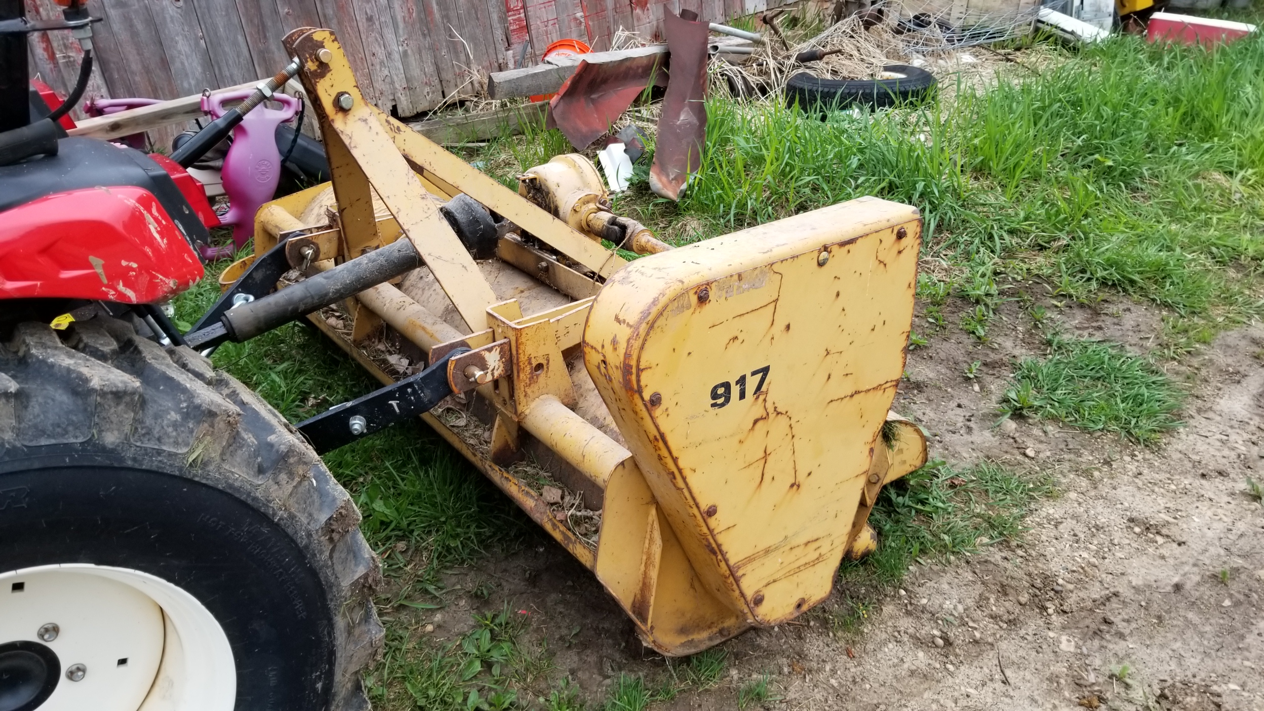

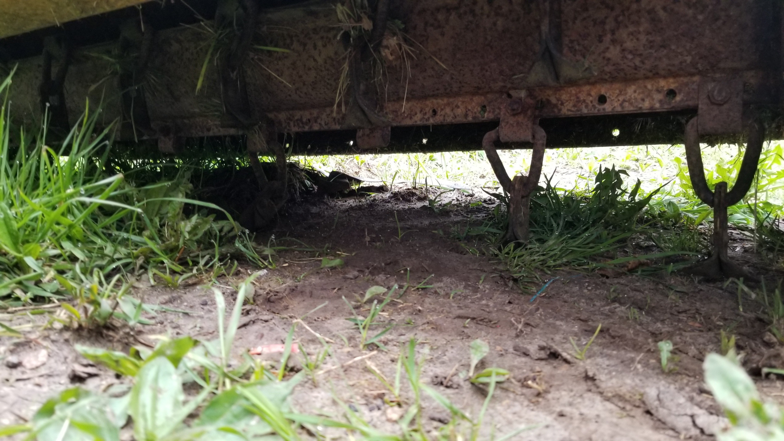

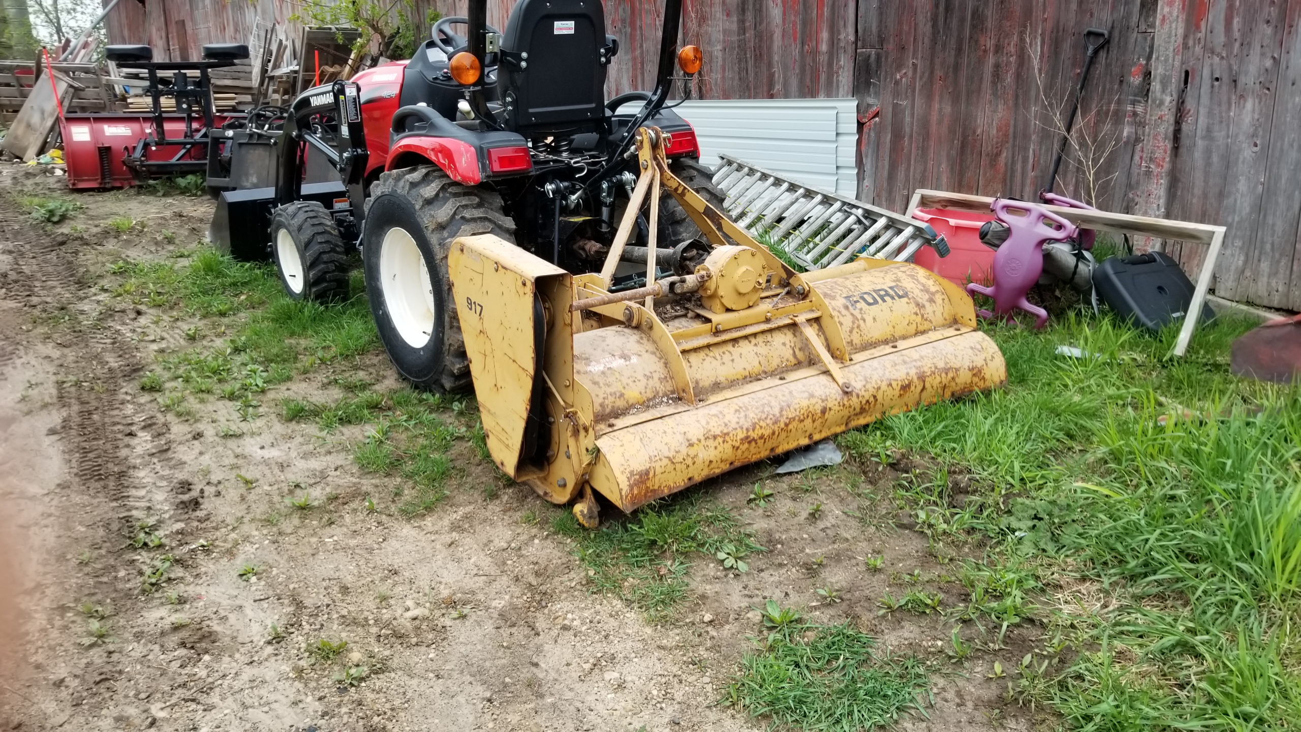

I finally finished reading this massive thread. I might as well throw my hat in the ring. I bought this 5' Ford 917 recently (already posted it in a separate thread, but this thread is more impressive...). I'm still working on getting it fully functional. It was missing the rear roller and one of the roller supports. I'm currently having a local shop make them for me, and I have new bearings to install for the roller. The rotor bearings seem to be in decent shape yet. Just needed to grease them.
A number of blades were missing along with a few broken and the rest are horribly beat up. After reading this thread I've decided to get a set of both the original blades (airplane wings) for when I want a nice finish and a set of side slicers for knocking down some CRP land that is coming out of contract this fall after 20 years. I will only be grass (as far as I know...), any brush I'll take my brush saw along to cut down to ground level before mowing. I don't think I'll mow the whole 30 acres, just a nice path around the outside and burn the rest off :cool2: . I will also mow some trails. Once I have all the heavy stuff knocked down I'll switch over to the smooth cut blades to maintain it. Both hang on the same hangers and D-rings so no problems there. I'm also ordering a new belt (double V) to keep on hand.
I have played with it a little bit and it does cut decent on my little 24HP (18PTO) tractor. I can't lift it real high, but high enough to get it off the ground. It's HST so I can go slow in the heavy stuff. Overall the thing is in decent shape for being so old.
View attachment 565945View attachment 565946View attachment 565947
The Y knives will do finger sized brush pretty well. Beyond thumb size it will do, but not well.

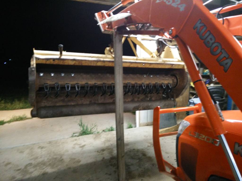

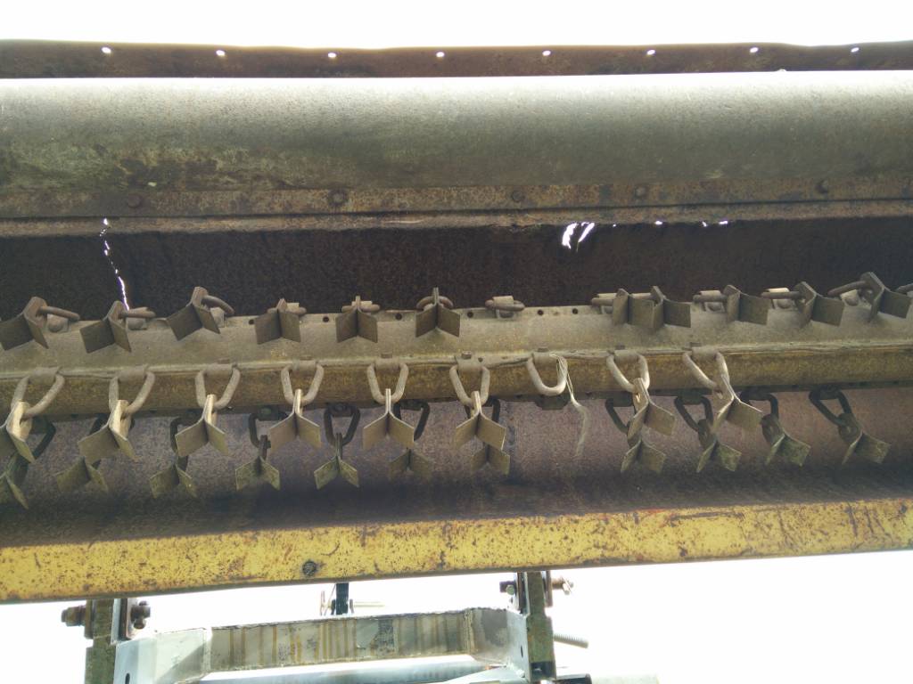

Side slicers did fine on my 917 for pasture, field & a bit if brush mowing as my side gig. The heavy hammers on my new Peruzzo do a lot better on heavy wood stuff over finger size, but not any better for finger or smaller.
Changing out knives on my 7' 917 took around an hour when you factor in lifting it (SSQA to 3pt adapter kicks ***), undoing bolts & hammering on/off the handful of stubborn brackets. Not hard or that long. But also not that worth it to swap unless I break a knife.
And as always only work under things that are well supported by non-hydraulic means. The 2x4s aren't great, but held if I put the loader in float. Dont remember if the missing knives pictured were when I got it or after running into some rocks... or the well head. ;-0

Your knife pattern isn't normal for a 917. For rough cut they use every 3rd hole, finish they use every hole. It appears someone decided to go between rough and finish and use ever other hole. Never hurts having more knives.
Did you have to modify your 917 to use the quick adapter? I bought a quick adapter that I'm going to mount onto a SSQA plate for my skidloader, mostly to move implements around. That would be a great 2nd purpose for the adapter.
