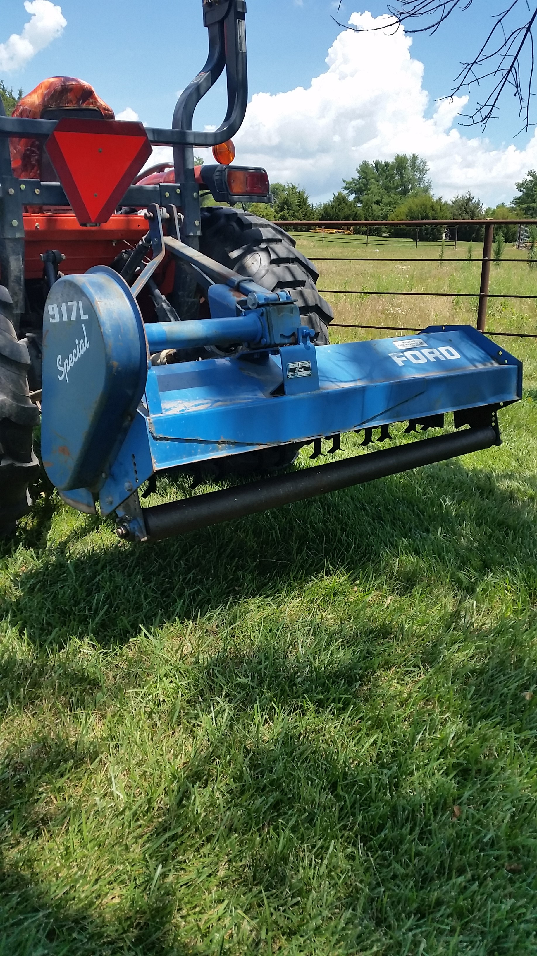

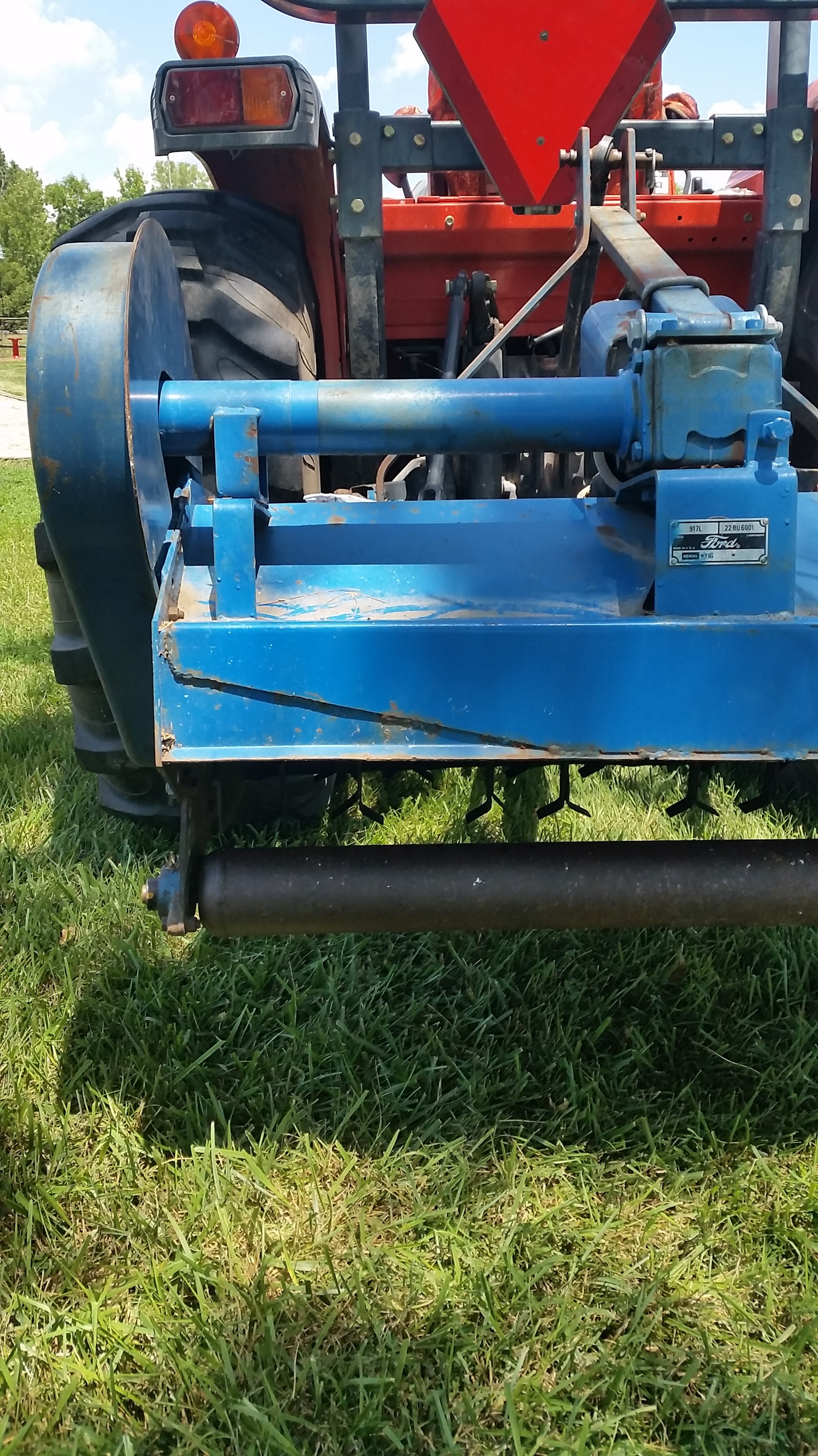

I've got a Ford 917L "Special". It's a 5' mower. I'm curious if anyone knows what makes it a "special". It has 12 stations, and 4 rows of side slice knives. The knives are attached 2ea to the station with a bolt. Maybe because it's offset?
After reading Wrench83's problem I went out to look this thing over. It hasn't been cutting very cleanly and tall (2') weeds, it will leave standing sometimes.
I think the guy I bought it from bought it at an auction and thought it was a tiller. I don't doubt he tried tilling his garden with it.
I violated all Flail Mower Rules and used a 4" flap disc to dress the knives. It didn't make much difference. I will probably order new knives.
I have 3 flails and this is the cleanest and the quietest, and is the worst cut.

Hello D2CAT,
I think "special" refers to the offset position of the flail mower but Neil Messick would know for sure.
Have you flipped the knives previous to this????? If not you may have a good edge on the opposite side.

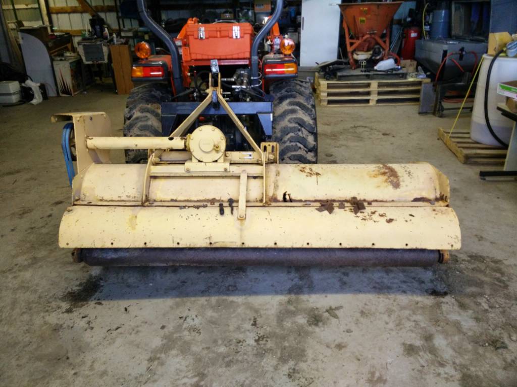

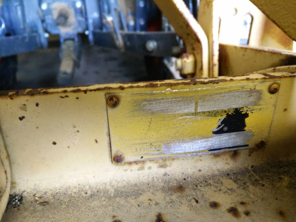

There were a pile of different Ford 917 flails over the years. Different letter designators after the name for the various iterations & they were small evolutions to the design as far as I know, not major redesigns. My 917 has the model 22-184 stamped on the serial number plate. Nothing special & it has plenty of offset. Some of the 917s came in a rough & fine cut trim. Given the 4 bars with lots of holes for mounting stations I assume the only difference was the knives that got put on.IMG_20150525_185656.jpegIMG_20150525_182923.jpeg
   / Let's talk flail mowers #5,274
Serial number plate says: Ford 917L, 22 BU 6601, serial - YJG
   / Let's talk flail mowers #5,275
Oh, and I assume the 84 in the model number has to do with the 7' (84") working width.
