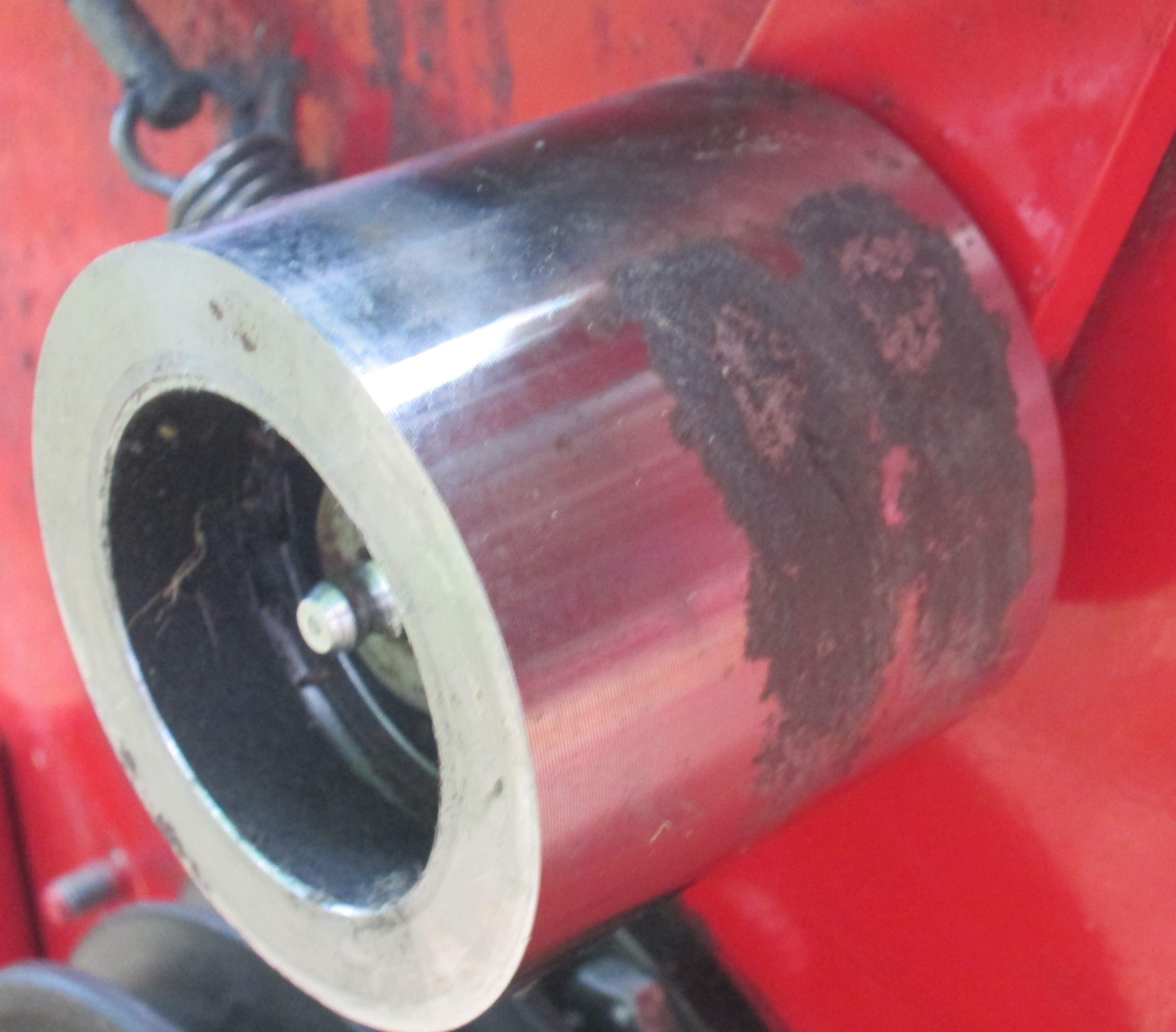

The original belts on my Caroni TL1500 got fried after less than 20 hours. The roller has some black residue on it that I'm trying to clean with acetone, but it's not making much of a difference.
Does anyone have suggestions on how to deal with it?
