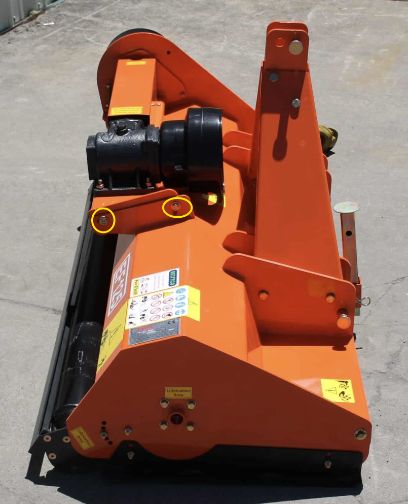

Yes, there are four bolts which hold the gearbox to the mower.
They are untightened before the tension bolt is adjusted, and retightened after the tension bolt is adjusted, before operating the mower.
I tried lifting the gearbox when the four bolts were loose, on the chance that I could stop the noise, but I did not succeed.
It seems that the U-joint on the implement side strikes the top of the gearbox if it's raised high enough to tighten the 40" outer circumference belts. I will try shorter belts.

The 4 bolts of the gearbox do not get loosed. The piece of metal that the gearbox attaches to has 4 bolts, 1 at each corner. I circled them in the photos. You can see how they are slotted to pivot when the adjuster bolt is raised or lowered.

Yes, those are the ones that I was talking about. They are loosened and retightened. By "gearbox" I meant the entire assembly.

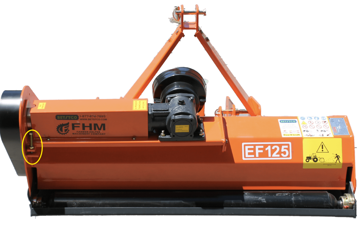

Im at a loss then. If you run out of adjustment, then a shorter belt will be required. Regarding the noise when running, is the side shaft hitting the cover? Does the gearbox have plenty of oil? Are there metal shavings in the gear oil?
   / Let's talk flail mowers #8,105

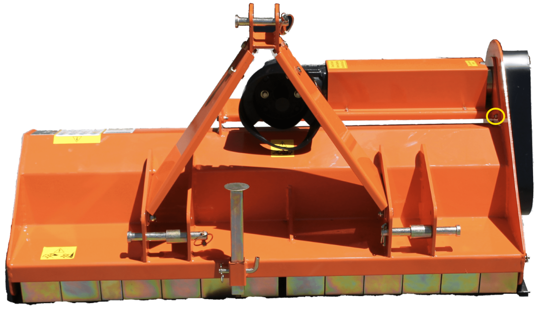

I cannot see the exact hitting with the PTO guard on, but I can see the orange metal underneath the U-Joint vibrating as though it is being struck from above, and the banging noise happens roughly once per revolution. I think the U-Joint is striking the top of the orange gearbox assembly underneath it when the tension bolt is tightened enough to make a 40" outer circumference A38K belt tight enough.
I bought an A37K 39" outer circumference belt, but I cannot get it on the pulley even with a screwdriver, and even when the tension bolt is totally loose. I may need to remove the bearing and pulley and wrap the belt around it and then reinstall the pulley. Or try finding a 39.5" outer circumference belt.
The shear bolt is on the tractor side, as per the warning sticker on the PTO shaft which has an arrow pointing left toward the back of a tractor picture. I have been told by Betstco that the shear bolt should be on the tractor side, and that if it breaks, the drivetrain will stop spinning, while if it were on the implement side, the drivetrain would still spin even though the mower doesn't.
There are no metal filings or dark oil in the gearbox. It is filled to the max until the drain hole on the side drips. I leave the drain hole on the side open for a few seconds for all excess to drain out.

I will try some more suggestions from Aaron tomorrow, but he might have to send me a new PTO shaft.
Would there be any damage if I removed the bearing and pulley so that I can wrap shorter belts around it and then reattach the pulley?
It is too difficult to install a 39" belt, even with a flat screwdriver and even when the tension bolt is totally loose.
A 40" belt, which is listed in the parts manual (Napa A38), can be installed with some effort by rotating the pulley to guide the belt around it. But once it falls into the V-belt groove, it is too loose unless the tension bolt is screwed to its max, which causes the banging sound near the implement side of the PTO shaft.
