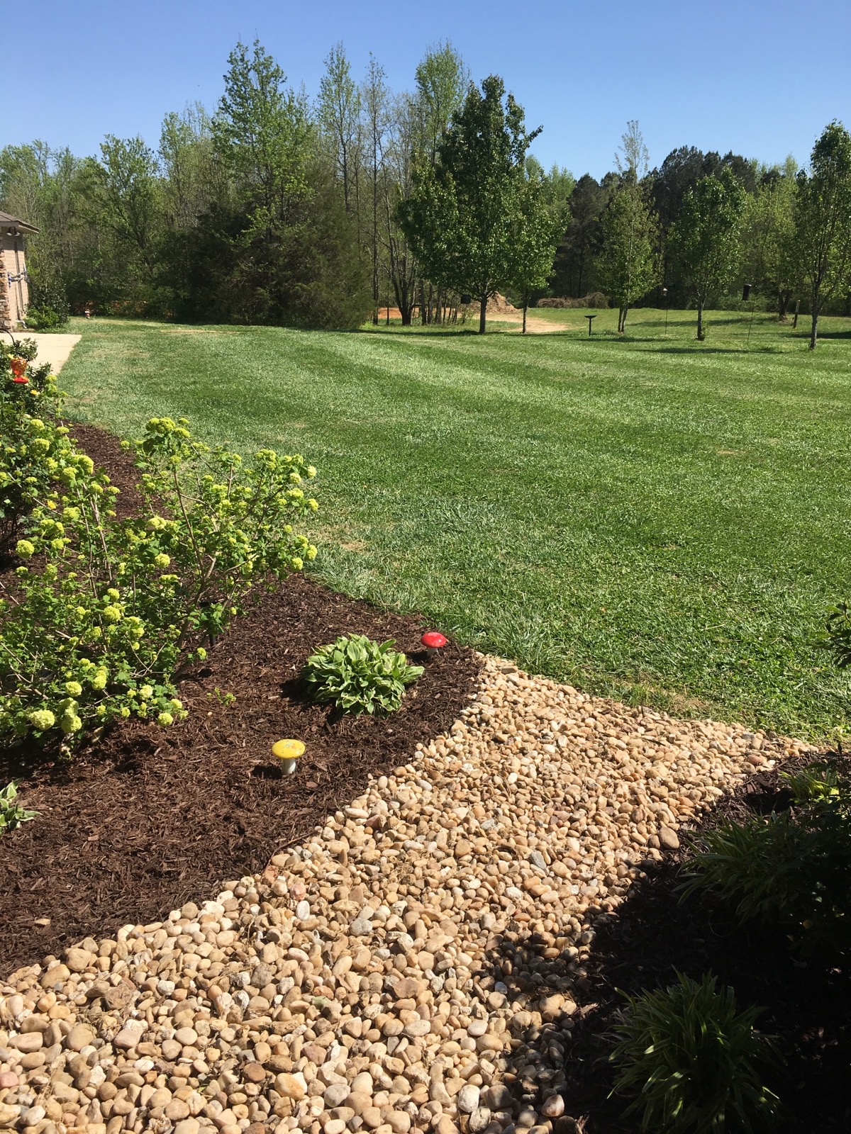

Hey guys I'm hoping you pros can help me out with my flail mower. I'm pulling this mower behind a L3901HST. Since new this mower has cut fine but recently started leaving strips of clumps. I reversed the knives for a fresh edge with no improvement. The mower is set up according to the manual. The grass is dry and only grown a few days since last cutting (not too tall). I reached out to the manufacturer for help or suggestions and they were no help. Only advice was to mow slower. Any help here?

It's a Woodmaxx FM78H. It's got 24 knife stations. You are correct in that it does indeed have a dethatching knife in the center. When it was new I was getting great results. I could mow a high field with 12+ vegetation and leave behind a nice, even finish. Mowing maintained turf resulted in a very nice, cleanly striped appearance close to what you would expect from a ZTR (see attached photos). I'm just trying to get back to that point. I am mowing my lawn about every 5 days. It's currently a mix of bermuda and fescue. I agree with you that for some reason the mower isn't creating that pressure differential to draw the grass up to give me the clean cut. Right now if I were to mow over the clippings as you suggested, they would remain untouched. The mower will not draw them up into the cutting area to be mulched. I assumed that it was the result of worn, dull knives so I turned all of them over to make use of a fresh edge with no luck. Thats when I reached out to the manufacturer and they said that's the type of performance I should expect from their machines (which I know is BS) and that I should try to mow slower. I will measure my actual ground speed when I go out to the barn after my coffee, but if I had to guess I would say that I'm down to about 3.5-4mph which at times is painfully slow for what should be an efficient machine.
Appreciate the help, gentlemen.
Here are pictures of the results I was getting with the mower for the first few months I've had it. Trying to get back to this point.
